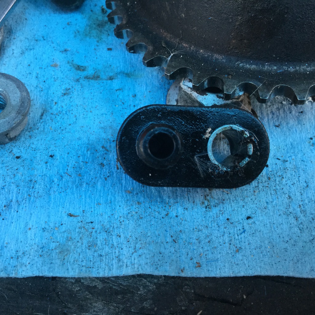

Here is a picture with the cam chain, guides and gear removed. The oiler is black and held in by one bolt.Name:  image_13.jpeg
The lower picture is the backside of the improved oiler. I threw away the early oiler, it is obvious when looked at from this side. The early oiler has a steel restrictor pressed into it from this side.Name:  image_14.jpeg

So the bottom pic is the one I need to look for?
