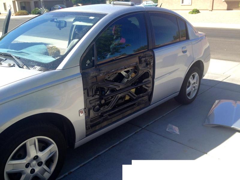

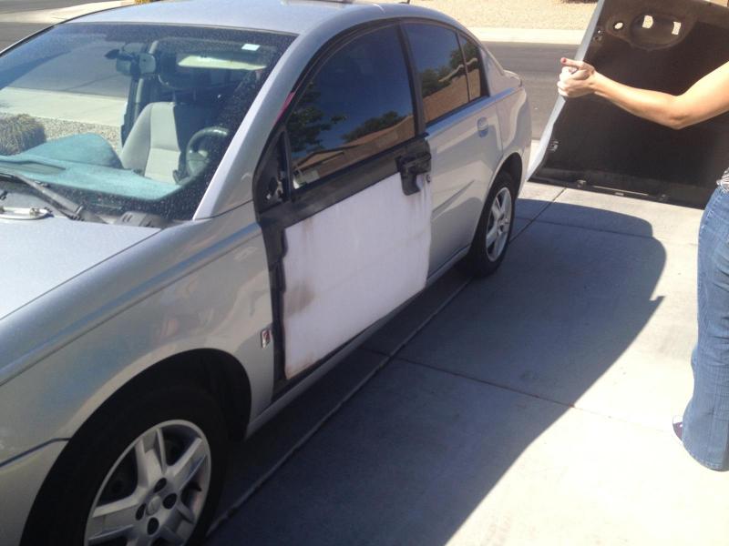

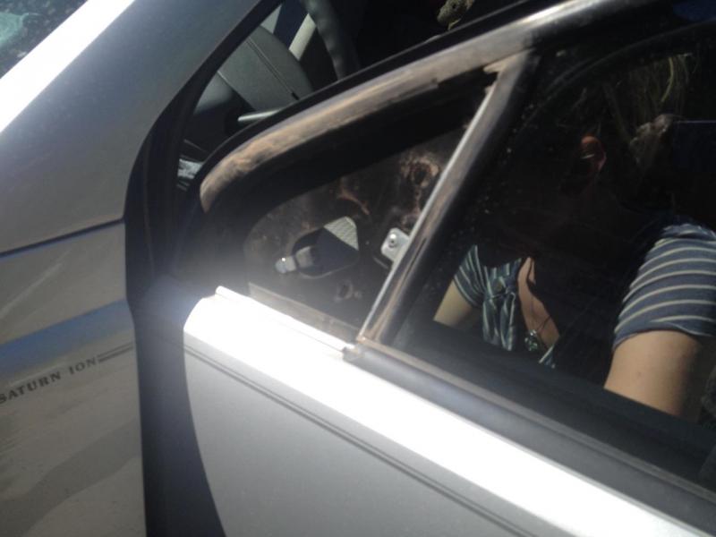

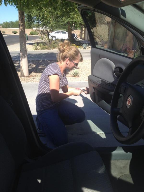

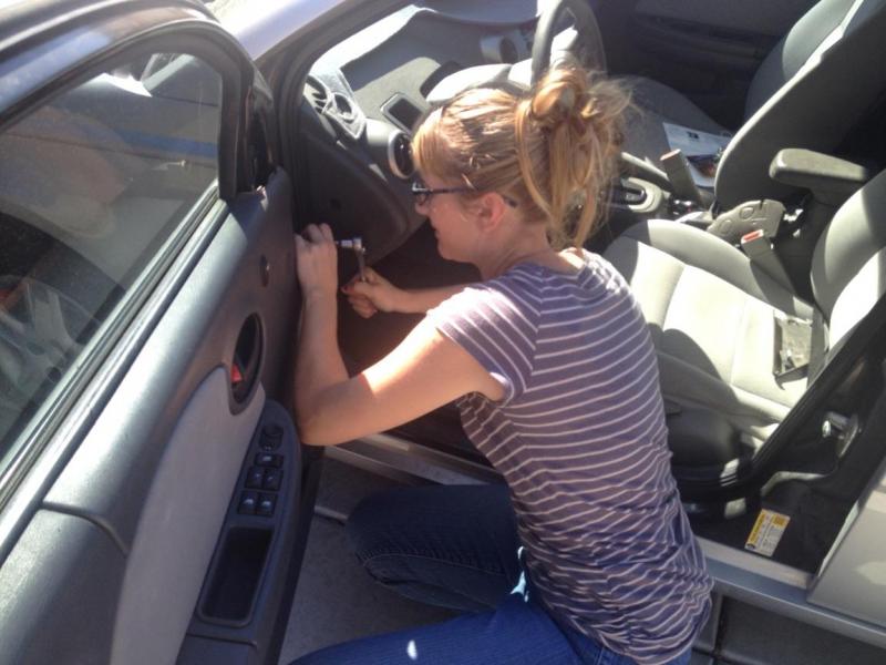

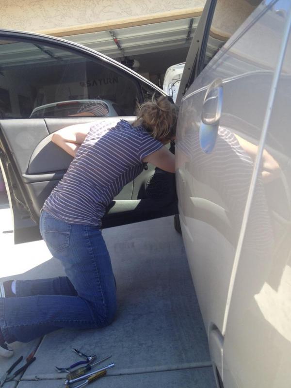

Her drivers door lock stopped working via the key. So after a bit she bought the parts I told her were likely broken. I figured it had to be the rod retainer at one end or the other, so she bought both and the retainer that's holds the door handle in place. This morning I showed her the handle retainer, the torx fasteners that hold the door skin on. Told her how to remove the mirror, the door handle, and the door skin. Then, I went in the house, and left her to it. She came in and asked a few questions, off she went, took it apart, replaced both rod fasteners, lubed all the parts, then put it all back together after I double checked her work. All is 100%, and she feels good about herself.....me I'm proud as hell of her. Pictures to come soon. I have to get them from her phone to my tablet....
