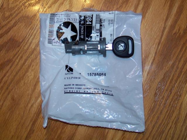

Exclamation ION No Start Cold
May get a passlock light may not.
When you turn the key and get nothing and try 5 more times or come back to the car and try 10-30 mins later and it starts right up you may very well be dealing with the Ignition Cylinder that came from the factory with excessive grease. The type of grease when cold will not let the car start.
Some people are able to remove the switch and clean excessive grease while others find they need to replace the cly and tumblers with a new one that has a new type of grease that will not interfere with the car starting.
So whats the deal? Remove from car and clean up extra grease reinstall and see if thats an end to your problem. If not replace the cylinder assembly as shown in picture.
