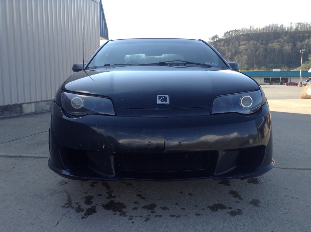

I have HID retrofits in my Redline, but they were done kinda poorly, and at some point I would like them re-done... I have dual color LEDs, black bousings, and some sort of projector and HID bulbs...

Here's what I have currently, they came on the car(I didn't do the work), they were put back together with hot glue(looks like) and some rubbery stuff all over the back to try and seal the housings(didn't work)... There is a white/amber LED strip along the bottom contour of the light that only the white is hooked up so far... If anything happens to these, I would love for you to replicate what I have, only with the quality that I've seen in your work thus far...

Those are Mini H1 projectors with Mini Gatling Gun shrouds. They are the easiest aftermarket projectors you can install. They are okay, but you have to use a H1 bulb which doesn't allow you to use any OEM D2S bulbs which are much brighter. You could easily fit a larger D2S projector in there with a little bit of work.

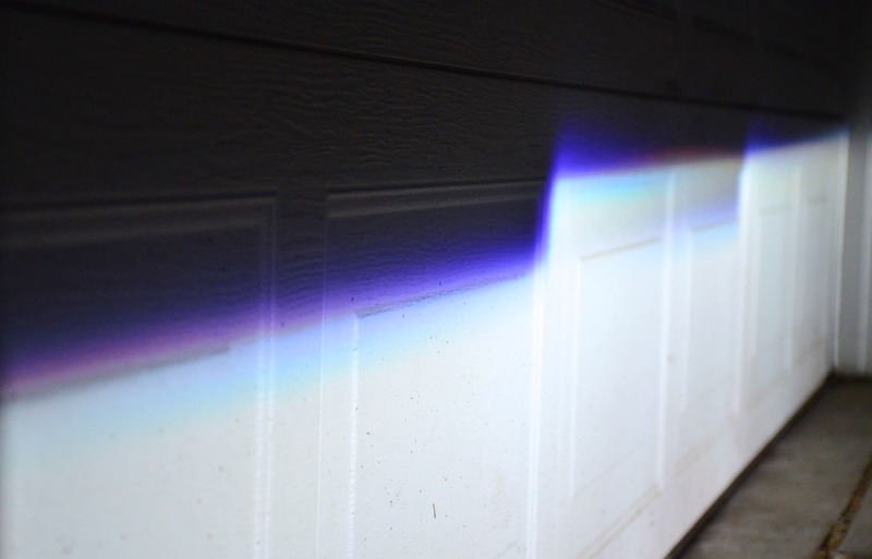

Posts some pics of what you got. Just a simple pick of the ballasts front and back will tell me the brand and if it's AMP or D2S. A close up of the headlight housing to see what projector would fit. And a pic of the back of the headlight on the car to see if there is enough clearance to fit a larger projector. Also a pic of a wall shot(like the one I showed with my Nissan). Park 25ft away from a flat wall and take a pic of your output on the wall. I would like to see your cutoff and step. This will tell me a lot of things: what your projectors are(name brand or generic), how good your ballasts are, and if your aim and rotation is correct.
