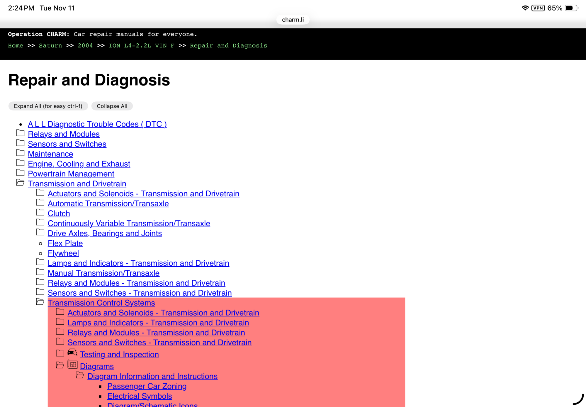

Old Nov 11, 2025 | 04:26 PM
These are factory manuals online, a little difficult to find things sometimes but most of it is here. Charm.li
Old Nov 12, 2025 | 01:32 AM
Nice find, sir.
