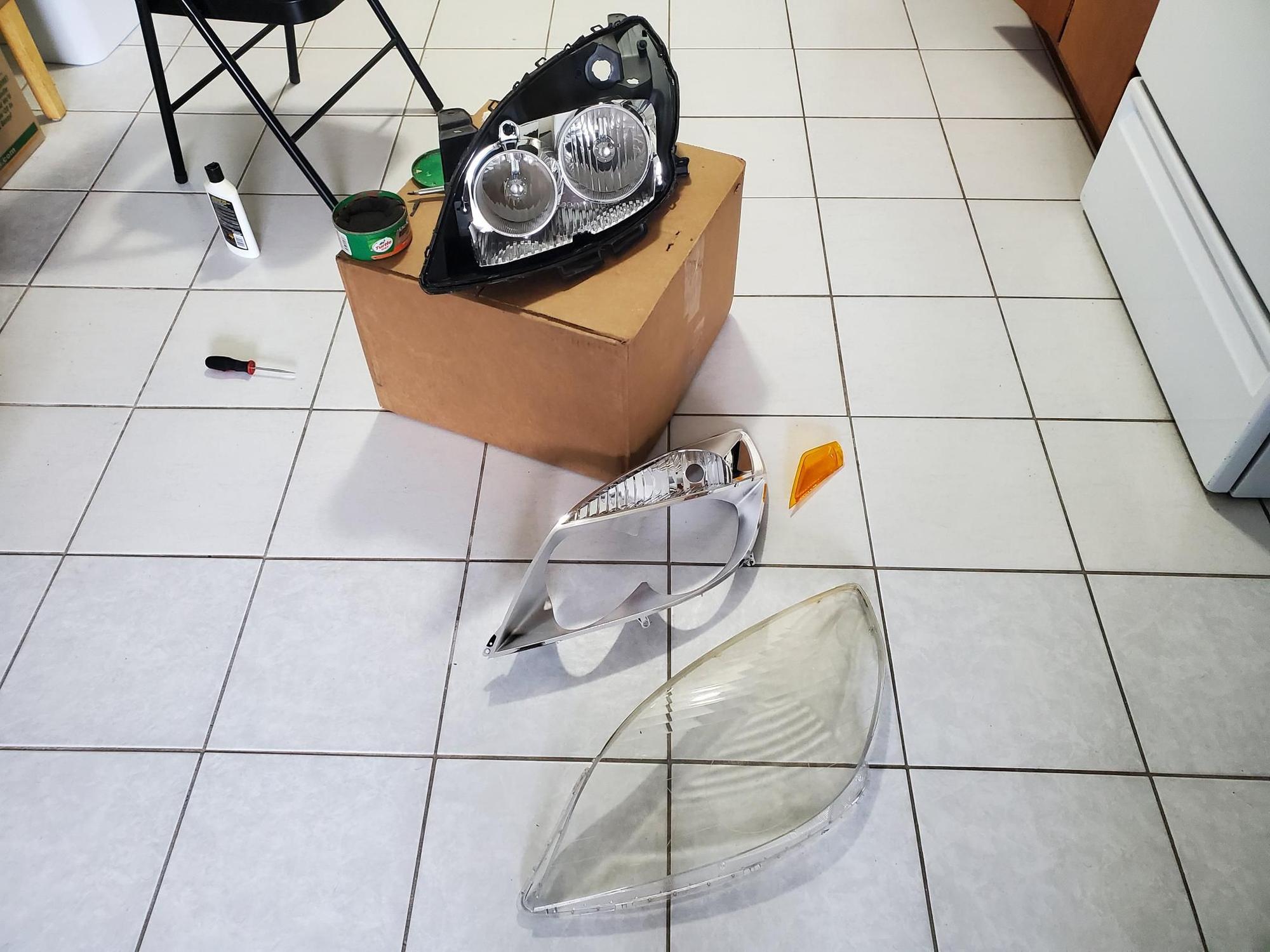

Okay, finally some progress. So I ended up keeping the TYC headlight and it turns out the orange reflector pops right out, so I can swap it with the OEM reflector, it just means another headlight to open, unfortunately.
So I also bought a cheap, faded OEM replacement as a temporary headlight to use while the paint offgasses from the modified set.
I figured that would be a good test monkey since I haven't done any of his before. Heated the oven to about 225 degrees (conservative based on the advice I've read) and found the headlight JUST BARELY fits in my oven with like a 1/4" on every side. Gave it about 14 minutes and the sealant was still not quite soft enough, but I managed to get it apart because there was actually very little sealant used at all! The whole bottom side had no sealant that I could find. It was mostly in the corners.
So now I can see how the assembly fits together at least:
Originally, the plan was to paint everything but the inside of the high and low beam reflectors, but I'm going to try just painting that middle piece in the above picture and see how it looks.
Taped off the edges to get the chrome border I wanted. I thought about taping off that bar in the middle like originally planned but It seems like more trouble than it's worth, and will probably look better blending in with the black chrome anyway.
The next thing to worry about was paint. Google says headlight bulbs can get up to a couple hundred degrees. Luckily I found some Duplicolor black chrome translucent smoke for wheels, which can withstand up to 250 degrees.
At first, it didn't seem to be getting dark enough and every individual paint spatter was visible, but as it settled, it all flowed together nicely, and darkened up quite a bit. I ended up just doing one fairly wet coat.
The chrome parts came out awesome, but for some reason the textured silver parts came out inconsistent. I didn't go nuts cleaning it because it was just a test, so hopefully some degreaser will prevent that on the real headlights?
After removing the masking tape. Didn't get the cleanest lines where it crosses over that middle divider bar, but from a couple feet away it looks sharp. Also looks much darker indoors, of course:
Gotta give it some time to dry more, and then I'll reassemble it and see how it looks!

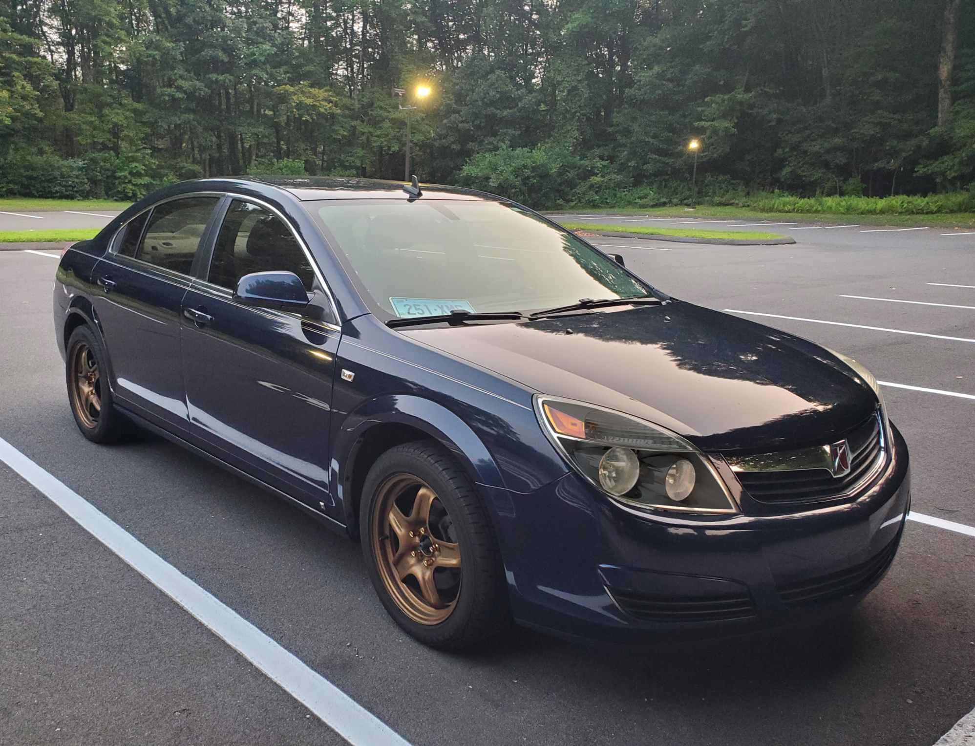

Well, I could not get the TYC lamp apart to save my life. I'd seen somewhere that most TYC lamps use butyl but I'm pretty sure this one was permaseal. I wanted to at least steal that perfect new lens, but oh well. My fingers are still sore!
I ended up painting the inner bezel as well:
In direct sunlight it's not as dark as I'd hoped. I'm already debating taking it apart and darkening it up.
Looks more like I was expecting at dusk:

Old Jul 13, 2025 | 10:51 PM
I like that they are not as bold as the wheels.
It's a nice soft accent.
And nobody looks at that part of the inner housing during the day. I like the way it looks at dusk and at night should be cool.
