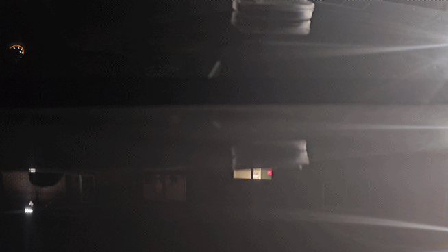

Hello, So recently I've been having issues with the "brake" and "ABS" lights coming on the dash it's an intermittent problem and I think I've narrowed it down to the High Mount(3rd brake-light) failing, in the gif you can see that when I press the pedal it lights up dim and gets slightly brighter, now my question is would this failure cause the indicators on the dash to show or is something else cause them to come on along with the high mount to do that? Thank you
p.s it's an 07 Aura XE 3.5L 75k miles

I unfortunately don't have a full fledged scanner I only have a FoxWell reader, however I did get the high mount issue resolved but am still dealing with the intermittent "BRAKE & ABS" indicators coming on. The odd thing is that when those dash indicators come on everything still works normally as far as I can tell. I don't lose cruise control etc and no other indicators come on.
The High Mount was a bad connection at the LED module. Apparently its a common issue in GM cars of this "vintage" lol, that use this same module. Something at the connector fails/loosens so people have been wedging toothpicks etc in the gap of the connector to mild/short term success. That "fix" didn't sit well with me when i removed the module. But I noticed that right beside the connector socket there are unpopulated "+ & -" traces on the circuit board so i just cut the plug off and soldered directly on the board. Works normally now.
