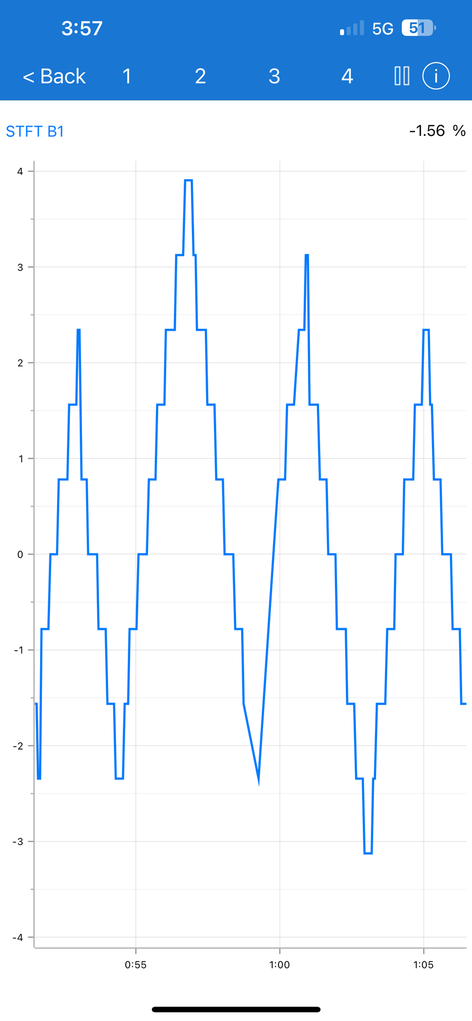

How about monitoring the injector pulse width with rpm?
How fast is this oscillation in RPM? Once per second, once every 5 seconds five times a second? If it's really fast I don't think you would be able to see the pulse width changing even if it was. Actually I don't know on what frequency that is adjusted.
I'm going to question whether you can hear or feel a 40 RPM change on the highway.. at idle, sure.
There has to be filtering of the O2 signal has part of the control loop feedback to the injectors. I don't know at what frequency those values are updated to calculate aired a fuel ratio and make adjustments to the injector pulse width. You said your air fuel ratio is 14.6. how stable is that? My first guess would be that would have her signal is coming out of the O2 sensor in the front is not getting sufficiently filtered and/or averaged before it goes to the PCM or once it reaches the PCM. So you have a slow oscillation in the fuel to air ratio and therefore a slow oscillation in the pulse width to the injectors. It never settles down because it can't.

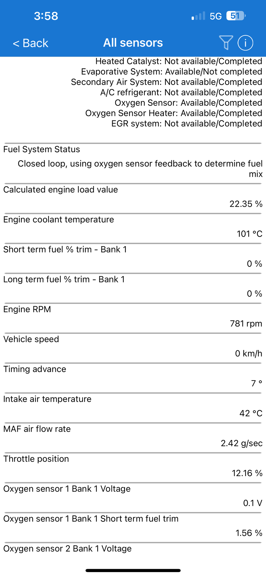

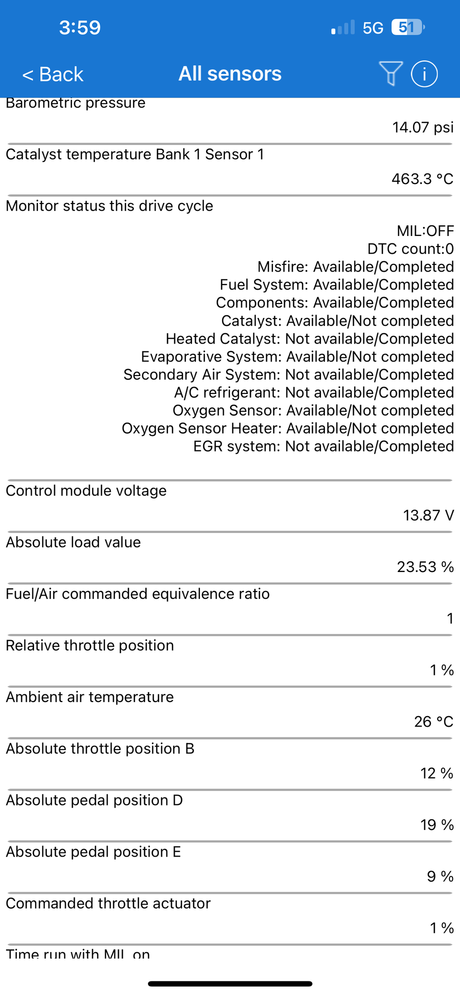

I attached a couple screen shots, doubt they’re helpful. I’m not really sure if the fuel pressure has been checked or not.
