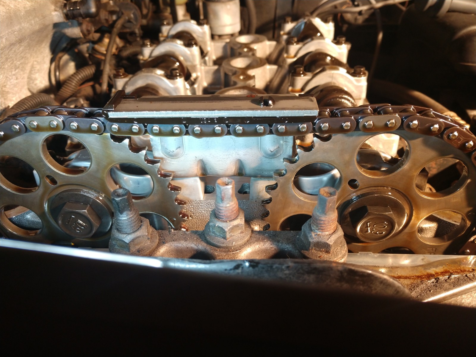

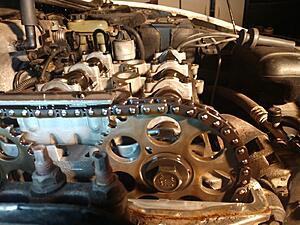

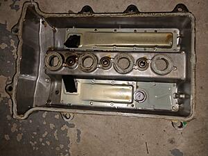

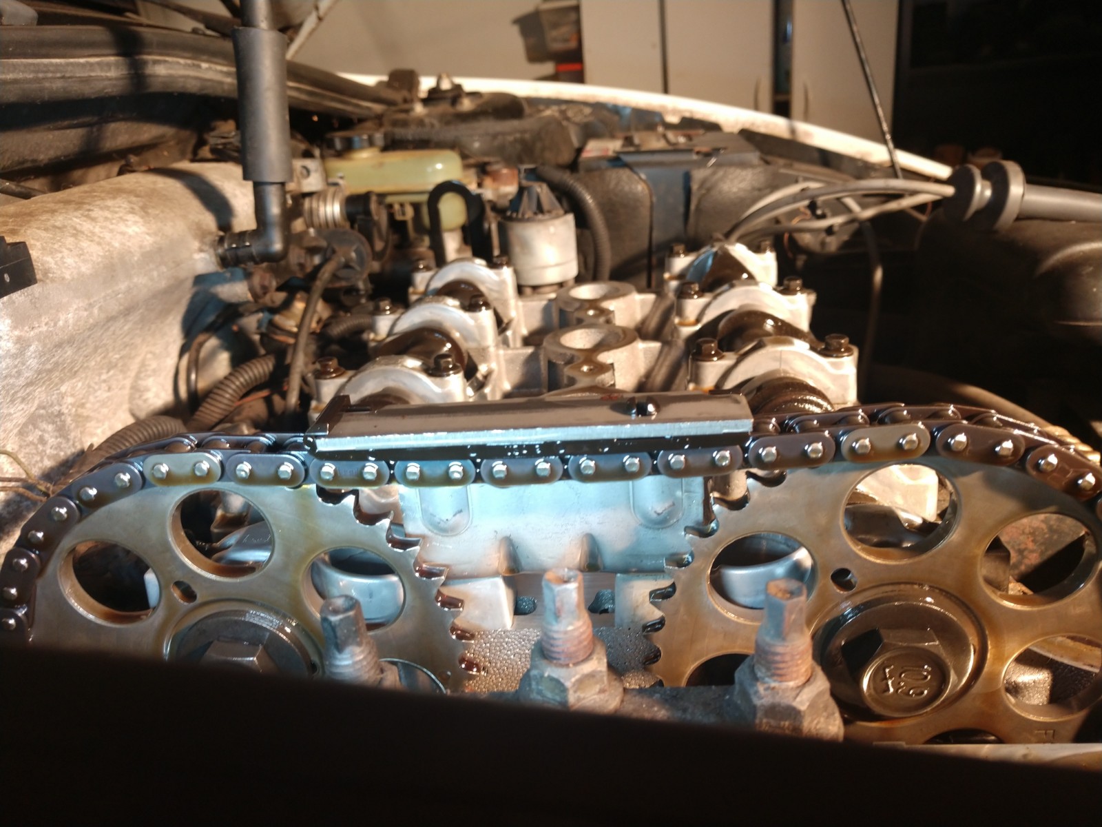

OK Folks,
Cam Cover off. (Let Blaster do its thing + new T40 bit.

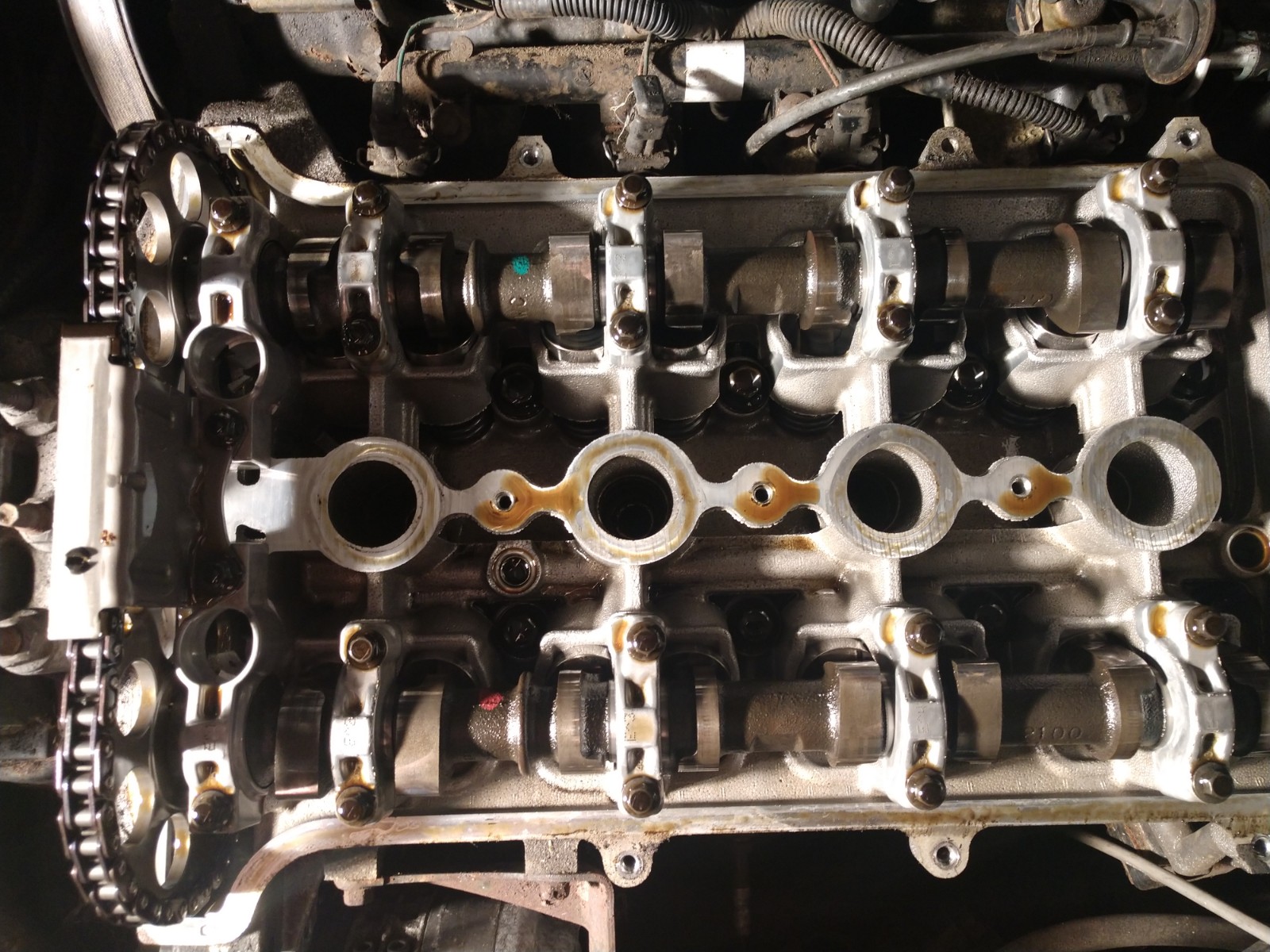

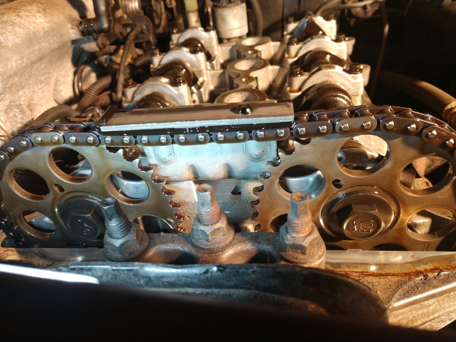

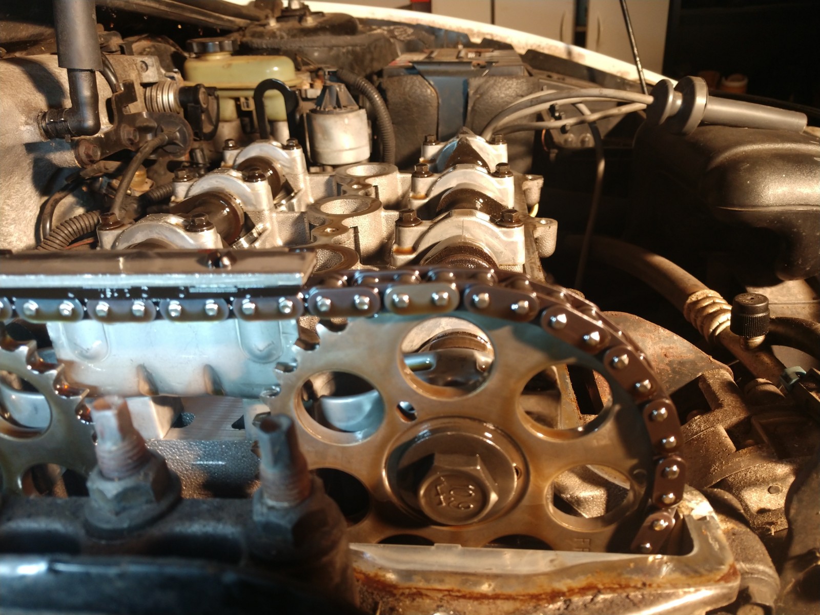

Seems pictures are in order.

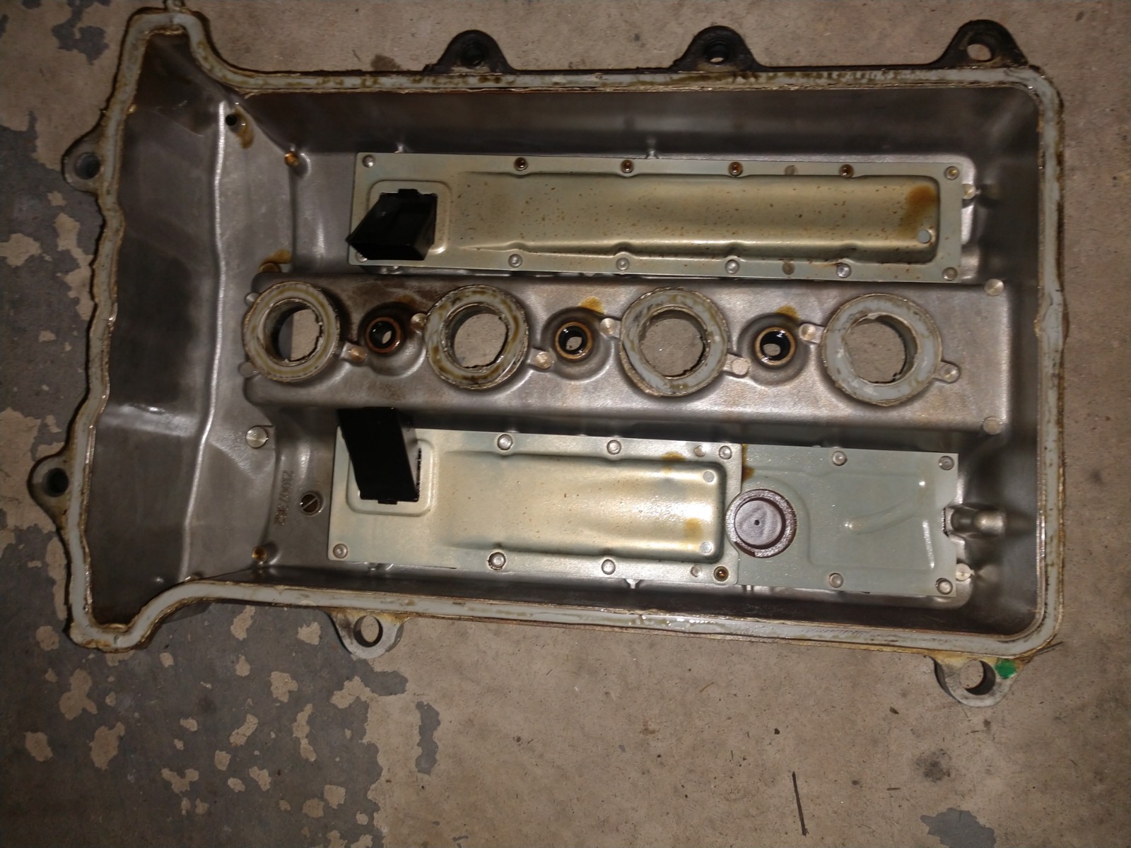

1) Cleanest cam cover underside I've ever seen (total=2)
2) Overhead shot.

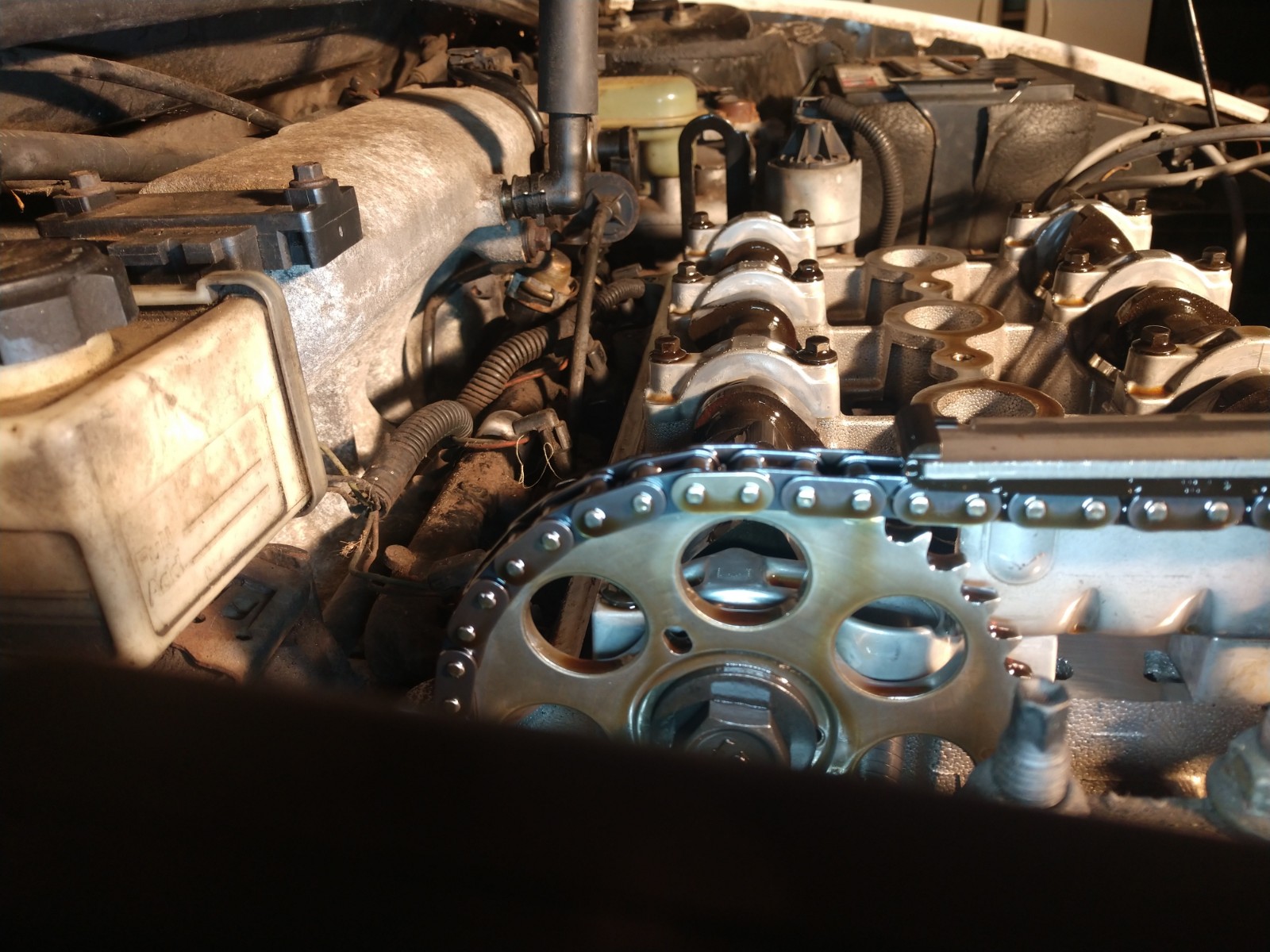

3) lining up the timing links (intake) with.....

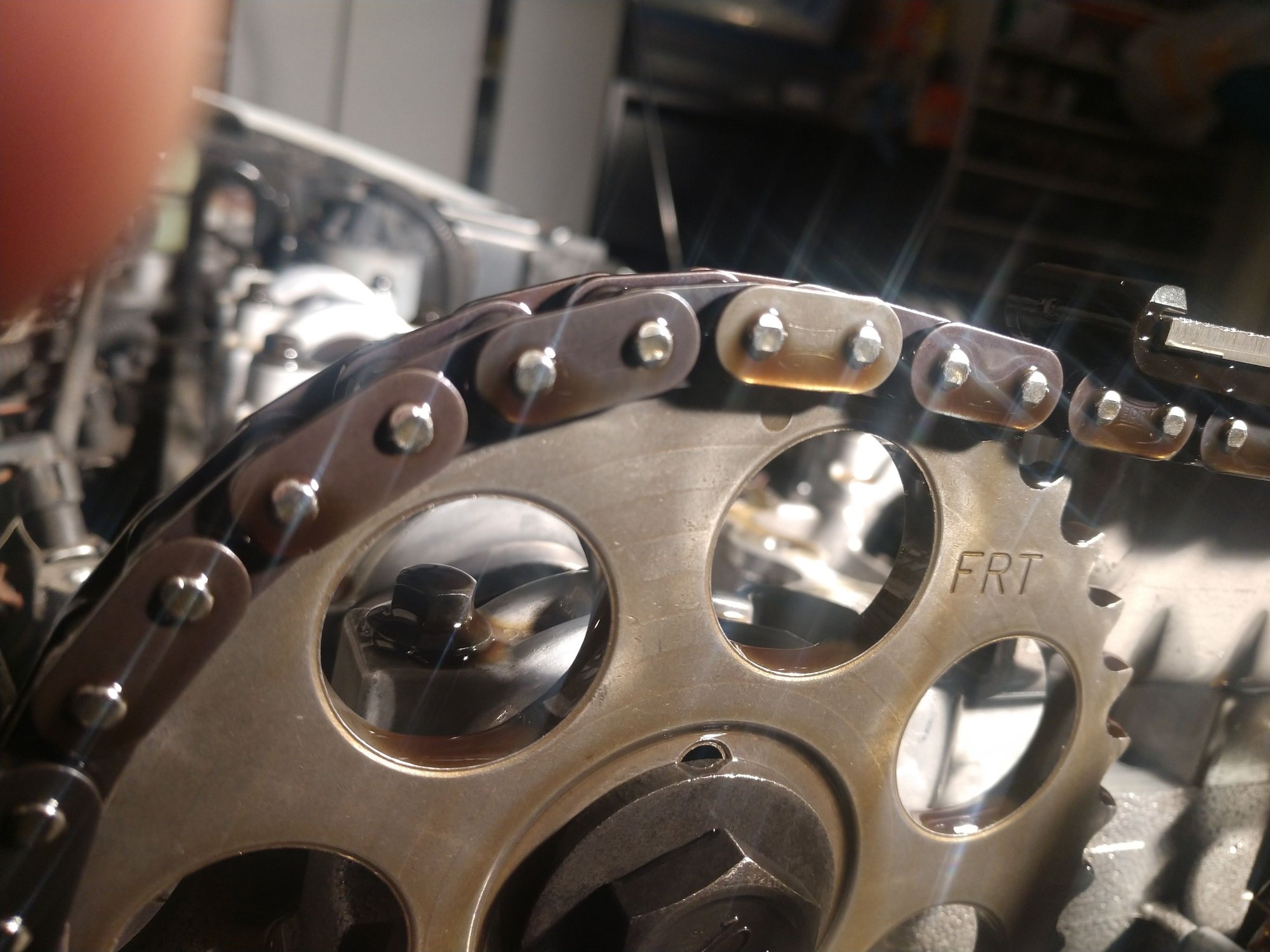

4)lining up the timing links (exhaust) with....
After rotating the engine enough times, the only way I can get the timing marks pointing to the chain is to not have the timing links on the chain be anywhere close to to the top of the engine.
Apologies the pics are not straight on --- I need to remove the torque axis mount to get better ones.
Off to my office to work.....down the hall.
Oh --- no strange noises when rotating, no broken valve springs, no collapsed lifters, can feel a bit of compression every 90 degrees of rotation (belt off)
Whomever timed this engine when it was rebuilt had no freaking clue what they were doing. I think they tried to center the crank alignment link between the cam sprockets.
Opinions please on the timing of the engine as determined by cam sprocket position with alignment links as level as I can get it on the intake cam.

The timing links only line up one time, from then on you ill have to count the links. Count the links between the two cam marks and make sure the lines on the cam gears are that far apart.
Old Oct 26, 2020 | 09:50 AM
Yes, I realize that which is why I'm logging on to post this now. Crank sprocket different size than cam sprockets. Duh.
I noticed this while I was rotating it. Don't know what my problem is.
But I am too late.
Nonetheless, thank you.
Old Oct 26, 2020 | 11:09 AM
Timing marks lined up with timing links. Marks are little circles kind of difficult to see but they are there if you blow up the picture

Cams look good, yes check the back pressure. Car you hear the engine fire at the exhaust pipe? Or is it quiet and just blows? A restricted cat will just blow air at idle and you won’t hear each cylinder.

I will clean it up and replace that gasket. There is no groove in the cover for one like the 2nd gens, yet I was able to purchase a preformed gasket. Guess I'll figure it out when I find the part.
If it is just a min thickness but bendable rubber gasket, can I use that stuff for tacking things like water pump gaskets so they stay in position during installation?
Old Oct 27, 2020 | 08:24 AM
Gasket adhesives work well, everything needs to be clean.
