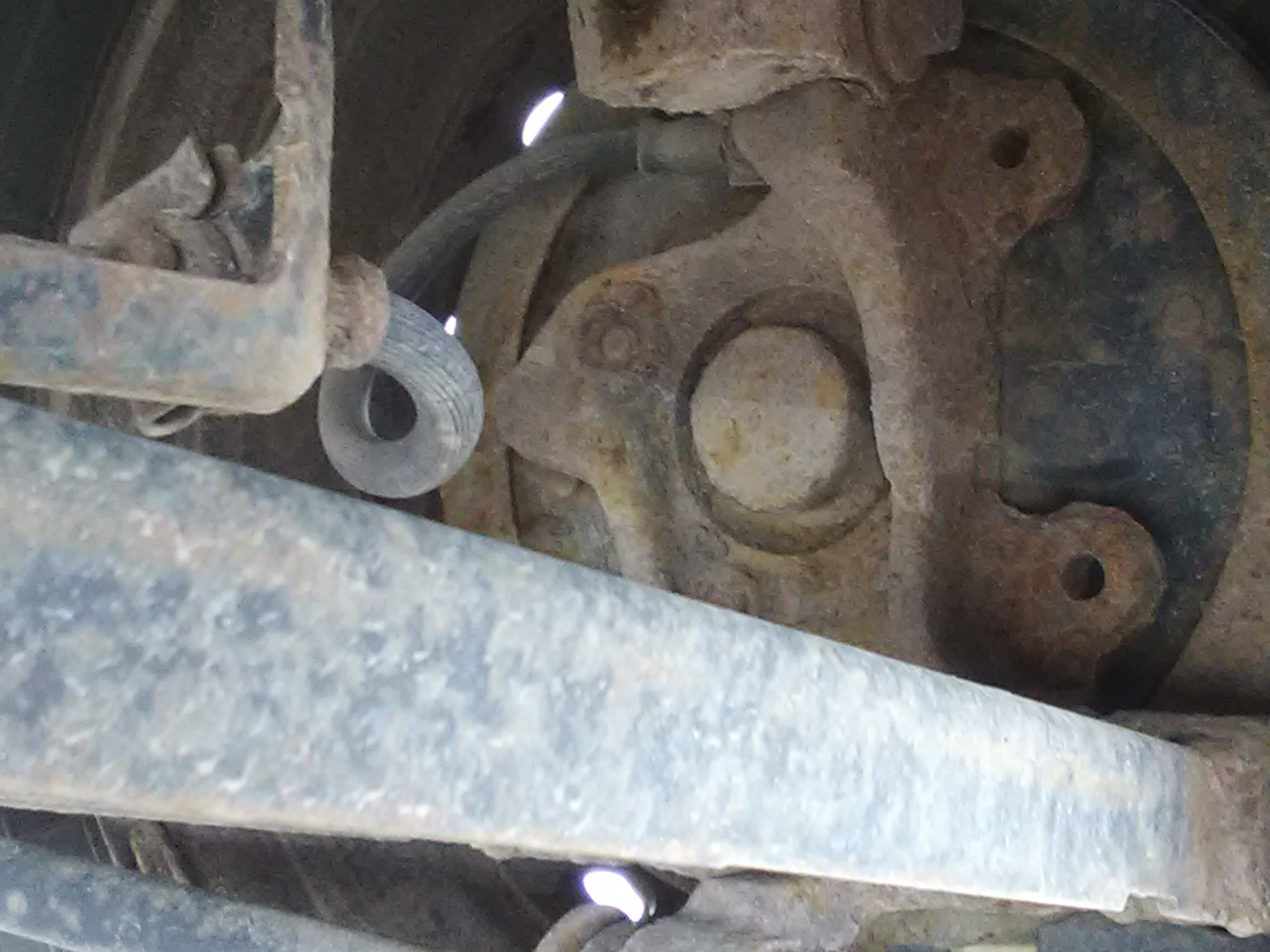

My question is: is it just the bearing that needs replacing or is there more? (i.e. what holds the bearing in place? Can't seem to tell from the pictures.)

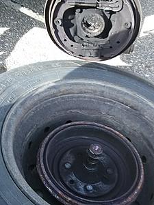

(Tried to inline images... didn't work for me. [Seems attaching did ] One is the back side of the passenger wheel showing some sort of end cap. The other is the driver rear wheel on the ground and the rear drum.)

To the best of my knowledge, the bearings in the rear of S cars are not replaceable a la carte. You must replace the entire hub/axle assembly.
Which in your case you would anyway, as the axle shaft actually broke! The bearing probably became worn enough to allow play in the axle position, and if there was a weak spot nearby, the forces exerted by normal driving eventually did it in.
I've never seen this in a Saturn forum, though I'm sure it happens.Damn lucky you were not on the highway
I'd like to think that your other rear hub/axle assembly is intact, but there's no way to tell for sure.
You can at least check for bearing play by trying to rock the mounted wheel while holding it at the 10 and 6 o'clock positions. If you find any play, replace that hub axle assembly as well. I wouldn't want to be on the highway if this one lets go.
Also, check to see that your trailing arm on that side is not bent. It should have moved the full range of travel when the remaining part of the hub hit the ground. The bushings are likely long gone but it doesn't help much for the ride.
Ensure the mounting bolts at the front of the trailing arm are not pulling out of the frame (they are mounted with bolts into the frame).
Also carefully inspect the area where the long tube meets the section behind it (further back on the car. I lived in the salt and rust belt for 17yrs, and one of my trailing arms snapped off cleanly at that weld. You have to put it up in the air to check it because of the tension put on it by the wheel when on the ground.
