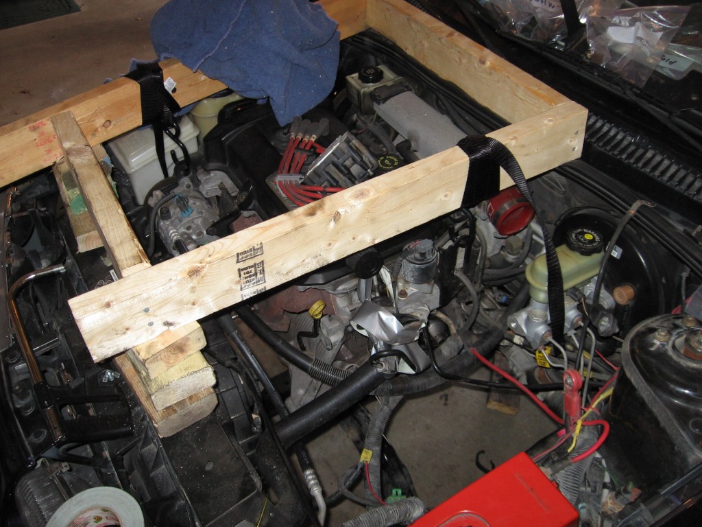

it's not difficult to drop the cradle and swap the gearbox. i just pulled mine a month or so ago to change the clutch.
you'll need to make a brace sorta like this:
which will support the engine while you take this out:
time consuming and awkward, but not real difficult. good luck!
