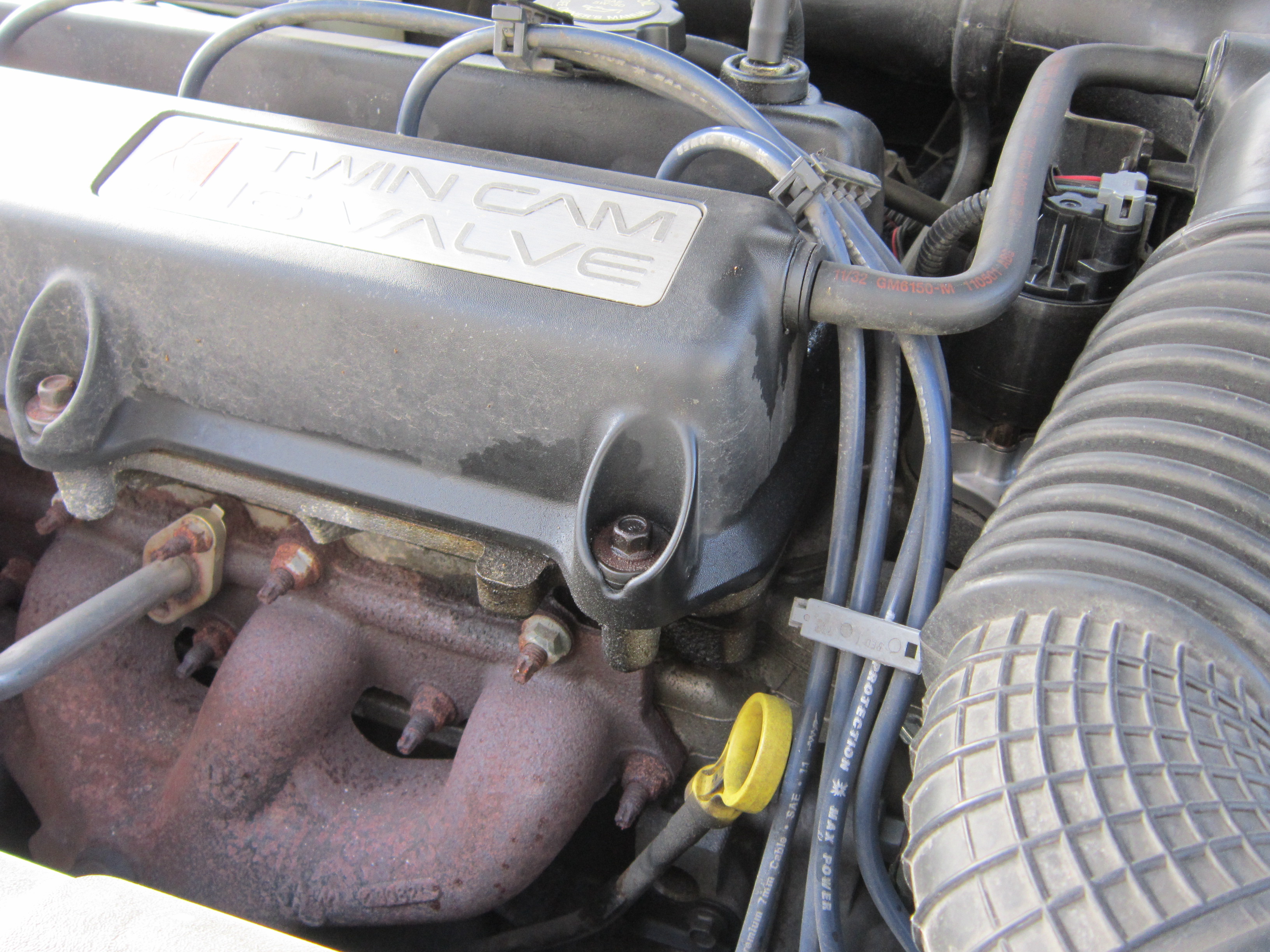

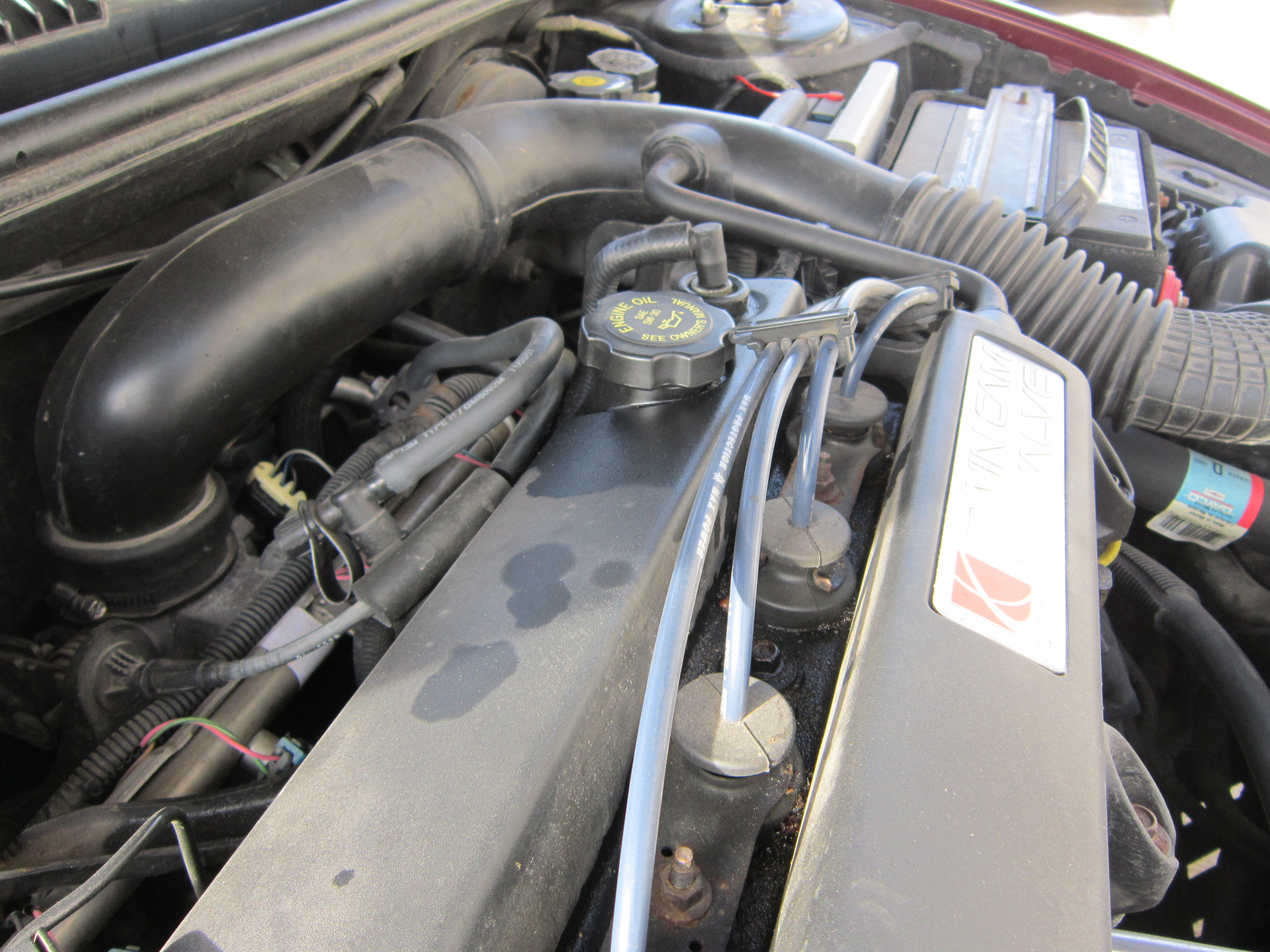

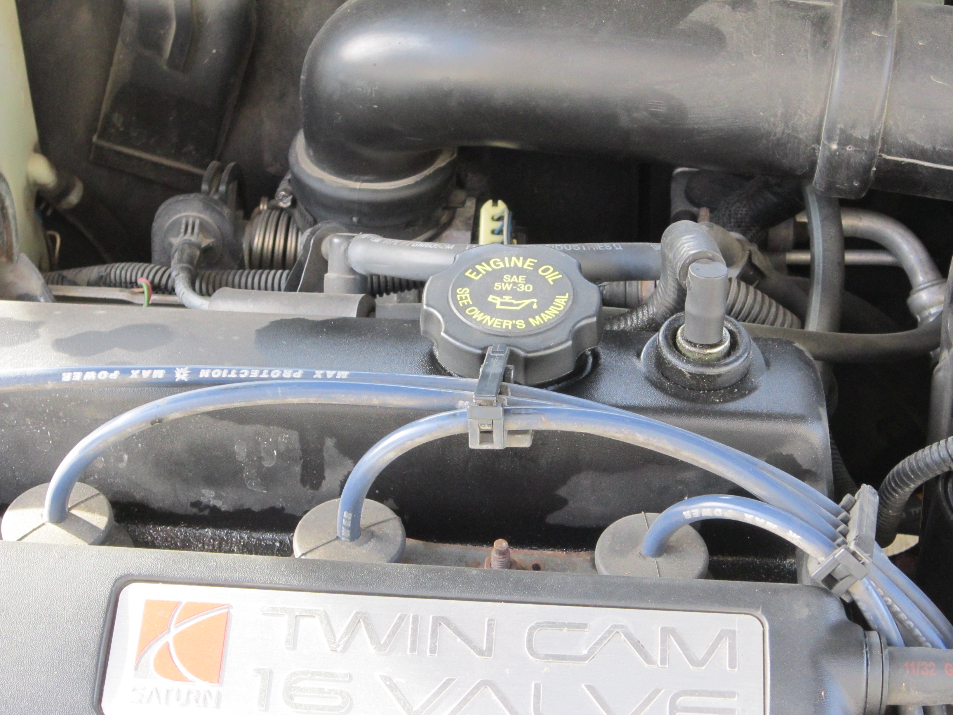

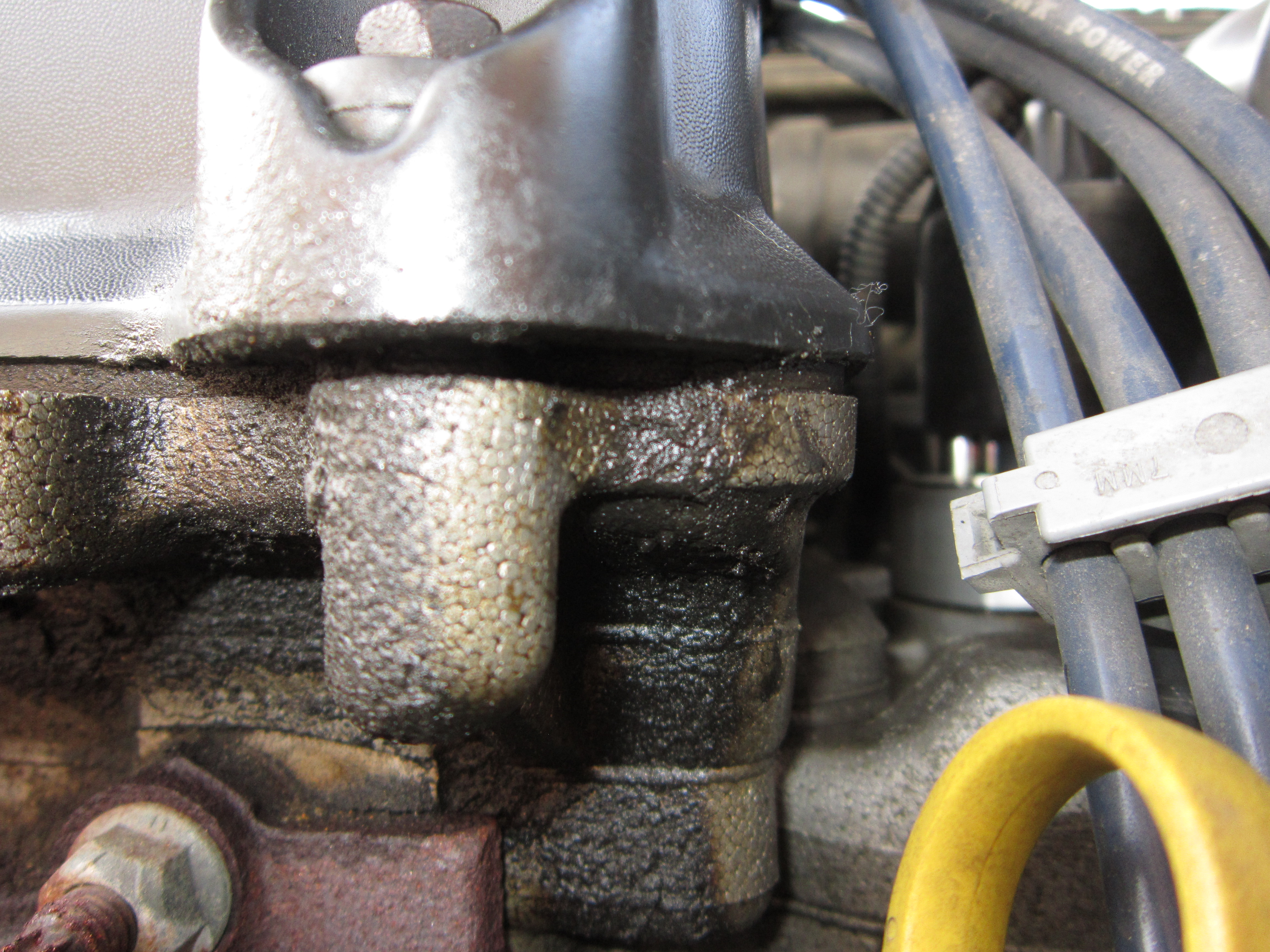

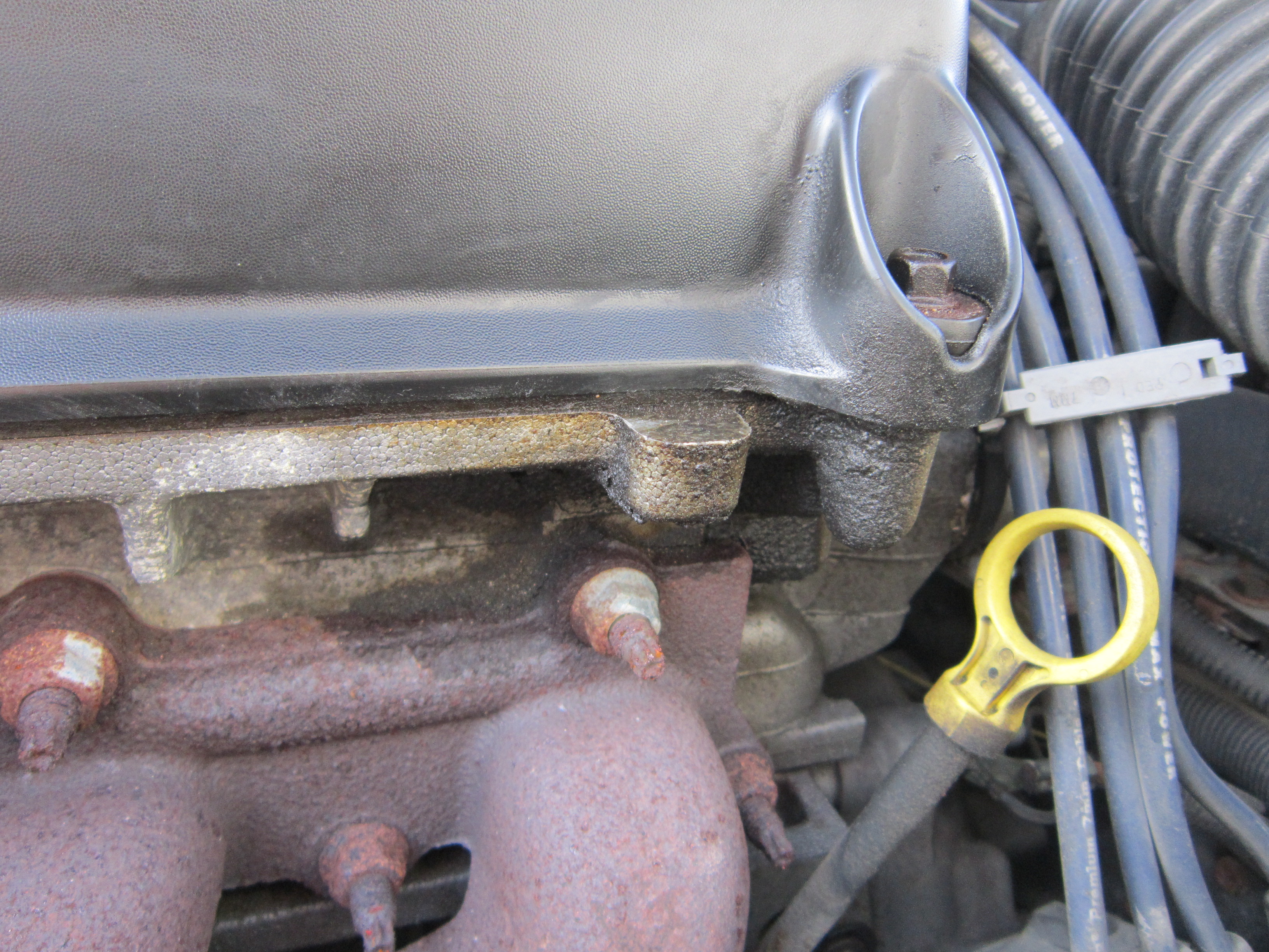

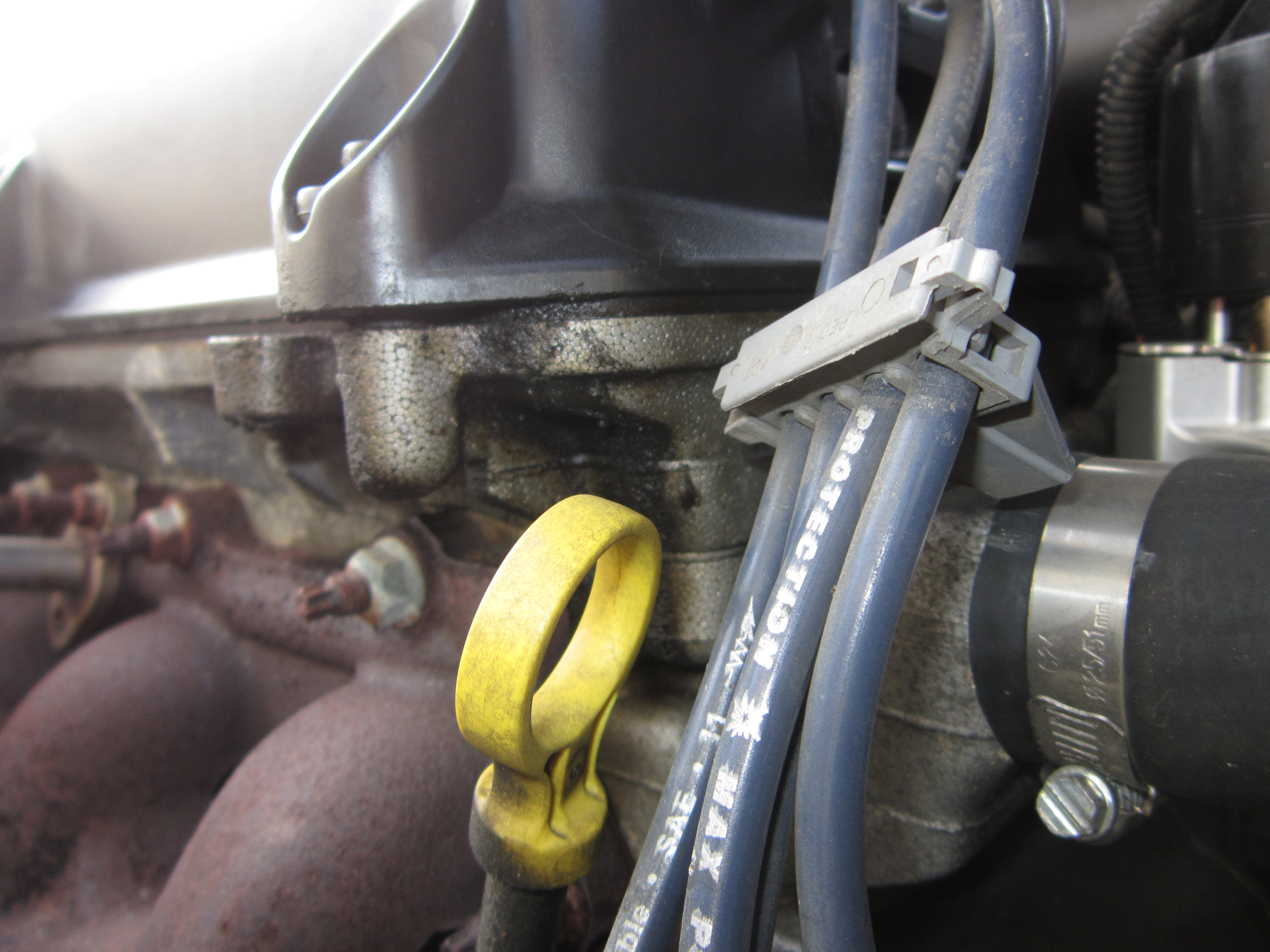

Checking the oil yesterday, I noticed the engine cover was covered in oil. I had the oil changed recently, so maybe the changing place was a bit sloppy at the top, but then I noticed more oil below. I took some pictures before and after I cleaned off the engine cover. I'll keep an eye on it for a bit.
Some things I'm thinking about: Oil cap has lost its seal. Leak around that hose next to the cap. Leaky gasket.
What do you folks think?

Did you try checking to see if that corner of the valve cover is tight? It kind of looks like a slight leak, but since you have no before or after pics since the oil change, it could well be a sloppy "tech". Check your PCV valve too.
Old Jan 7, 2016 | 10:29 PM
looks like, per Rube, a slight cam cover gasket corner leak. Check the bolt with a torque wrench set to the proper torque--do not over torque or it is likely to leak worse.
The rest looks like a very sloppy pour / a "bloop" of air going into the pouring vessel causing the flow path to deviate, miss the fill hole, then creep as you heated the engine up while driving. The non contiguous spots are again someone very sloppy with the oil or an oil soaked something touching the area.
If your filler cap had lost its seal, you'd likely have oil everywhere and in all directions.

Thanks guys. Like I've said, I've cleaned the top cover and will see if anything else oils up. I'll look at the bolts when I can. Weather is supposed to get cold and icy this weekend and I have nowhere to work on it than in the parking lot.
