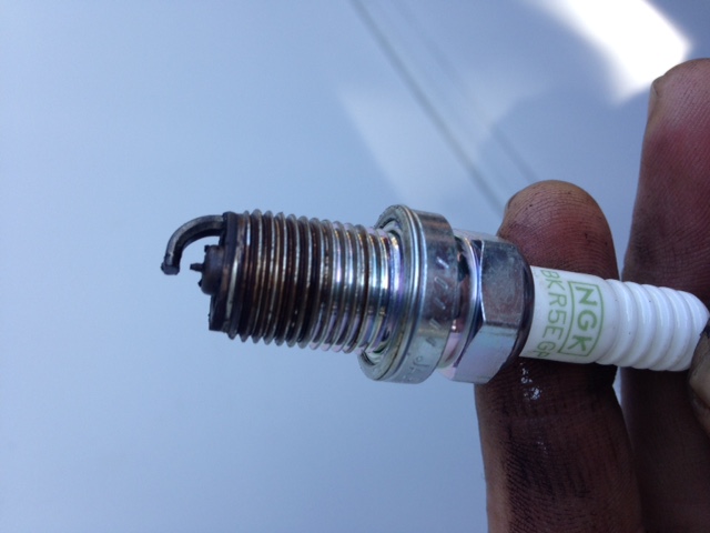

i pulled the ones i just put in, and they are pretty dirty already. i have a bottle of fuel injector cleaner in the tank, but should they look like this?

Ok,
1) Although the G platinum plugs are of the same heat range as the stock NGK coppers mentioned above, there is obviously an issue with the plug getting too hot. The insulator is disintegrating. This is LIKELY due to inadequate heat dissipation during ignition.
Pre-ignition/detonation MAY be contributing but I don't know enough about it to speak intelligently and give you sound advice.
And that gap can't be 0.040". What is it?
Sounds like the combination of a failed ECTS and improper spark plugs for the application. Additional issues like pre-ignition MAY be present. Dunno.
