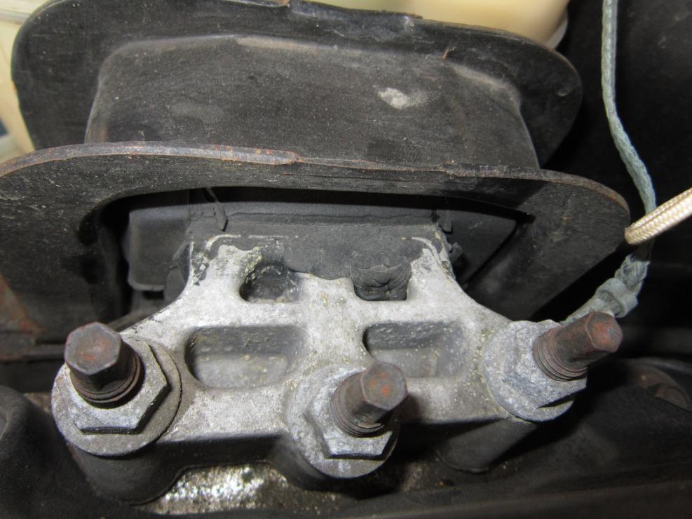

Motor mount was confirmed by my brother. He watched it while I started the motor and it does allow excessive motion and there is a visible crack in the bushing part, so that's gotta be addressed soon too.

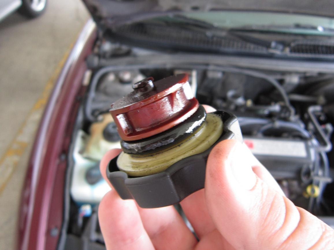

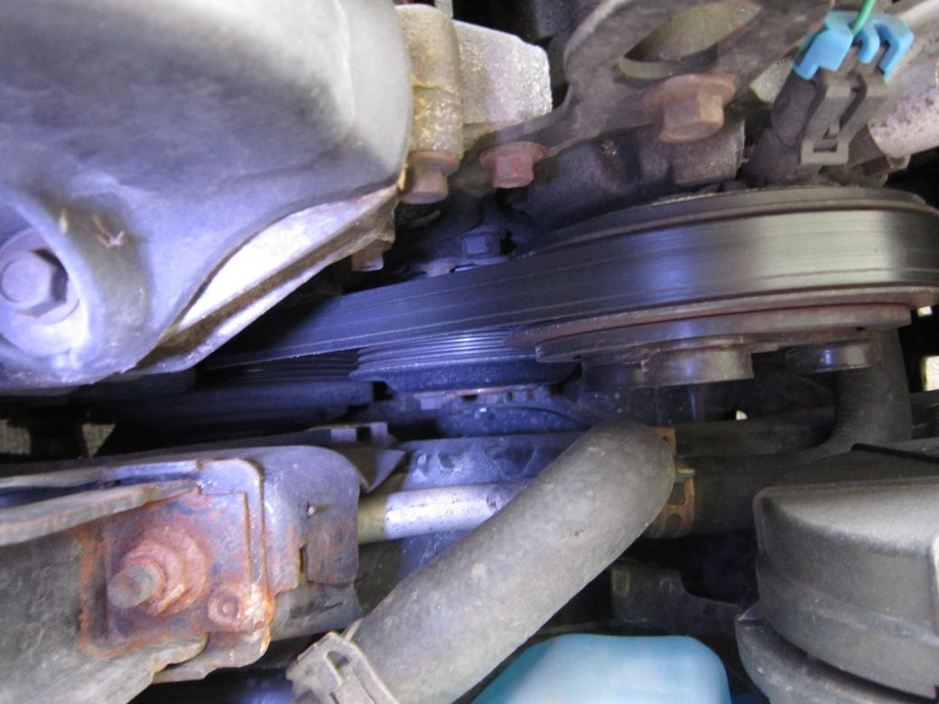

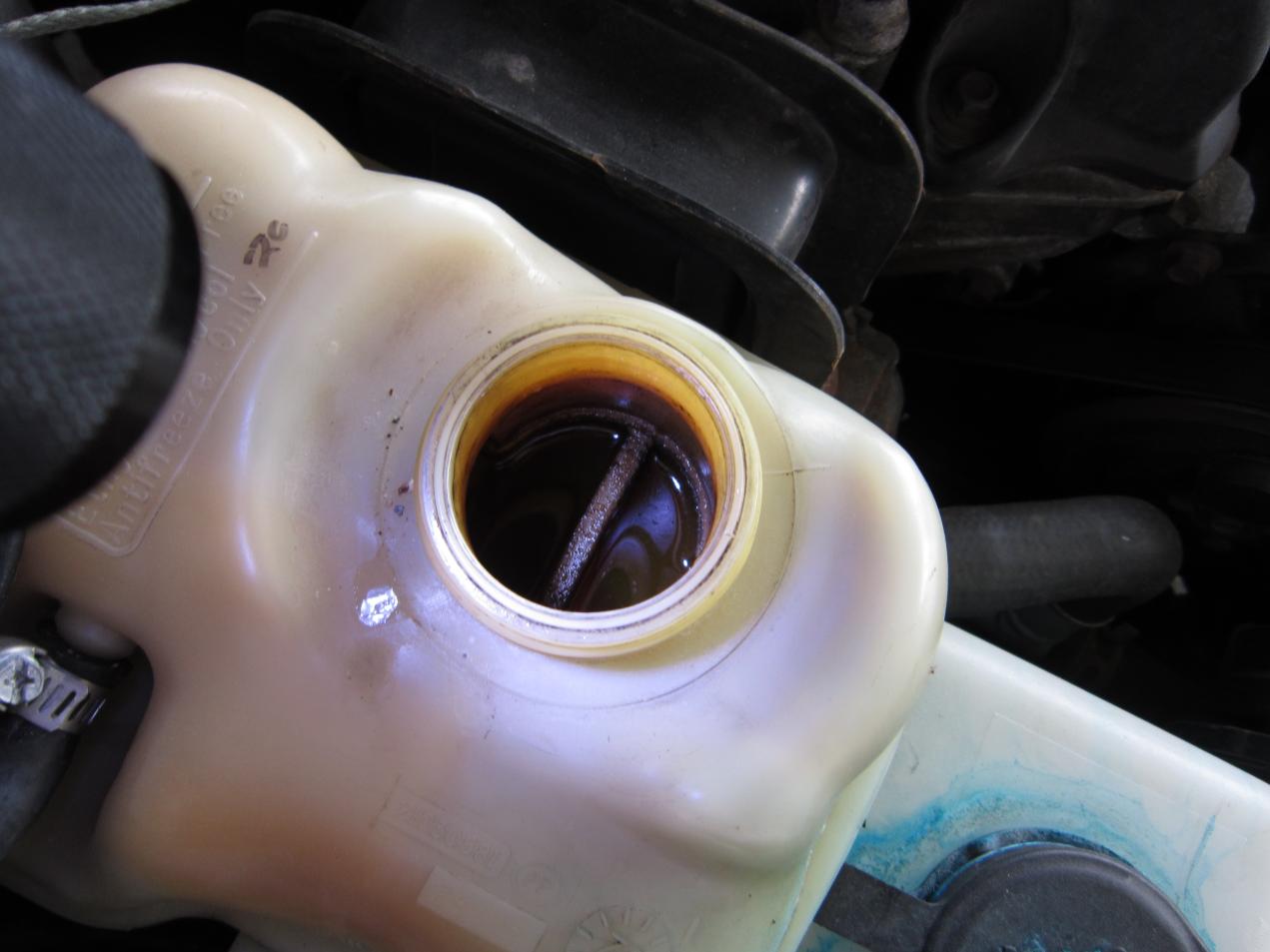

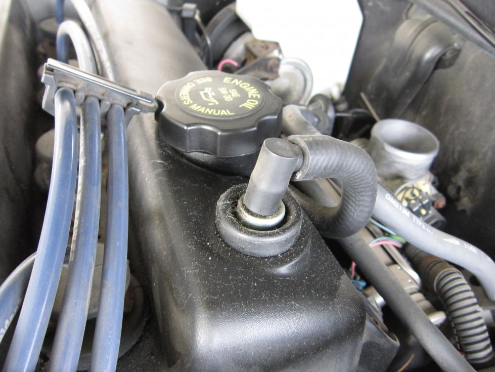

Oops, meant to include pictures into that post, but forgot! Here ya go!
Looks like I have a little blow-by around the filler cap, as it's a little oily in that area.

Turns out both engine mounds were bad. Had both replaced. Engine much happier and smoother. Even shifts better now that the engine is sitting where it's supposed to be! Shifting into first always bound up. Now it slides right in.
