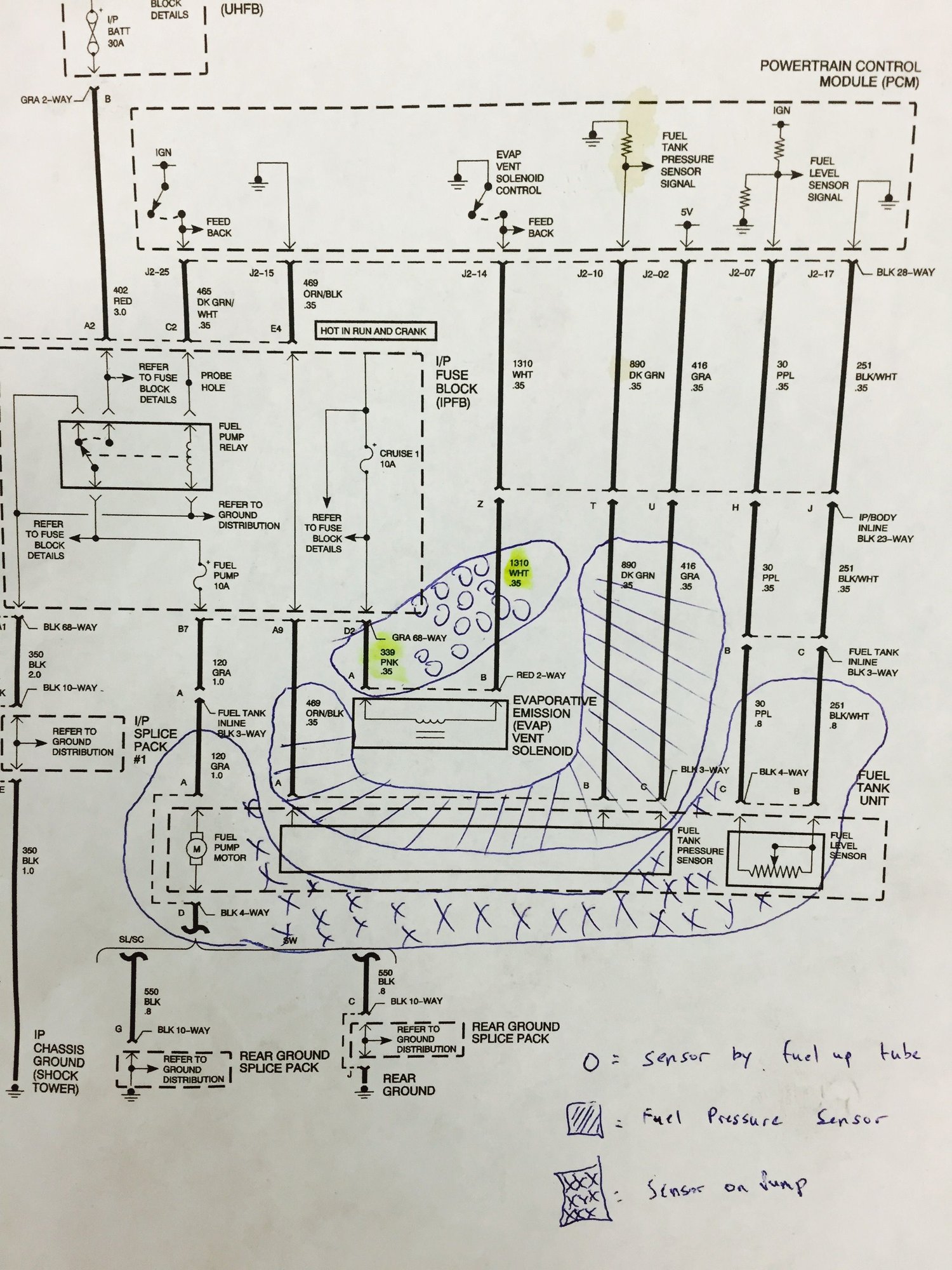

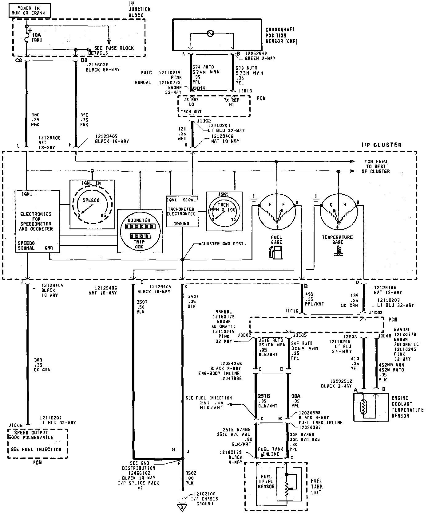

Perhaps it was a big no no to provide ground directly to the purple or black w/wht wires. Because I see one diagram shows they go to the PCM...
I since have found some wiring diagrams online but not sure they apply for my year and model. I've attached them below.
So not sure what the next step is. I would like to fix the gauge. Not sure if the problem is the gauge or the PCM which might control the gauge. Seems it's not the sending unit in the gas tank. I don't know if the gauge is replaceable separately from the dash panel.

Sender feeds the PCM and PCM controls the gauge.
Home >> Saturn >> 1998 >> SC2 L4-1.9L DOHC VIN 7 >> Repair and Diagnosis >> Instrument Panel, Gauges and Warning Indicators >> Diagrams >> Electrical Diagrams >> Instrument Cluster >> Display Gages
Display Gages
Instrument Cluster: Display Gages:

Thanks! Oh boy …. Ok so the PCM I am supposing sends 5 volts or less to the fuel level gauge needle to rise. So I need to pull the dash cluster to get to the backside of the fuel gauge.
So I can make sure the connection is good and that the ground is good and see how much voltage the PCM is sending the gauge.
If there appears to be no signal voltage then I need to check any connectors between the PCM and gauge which there appears to be only like one..
Where is the PCM I think perhaps I saw a diagram of it to the left of the driver’s knee or ….?
