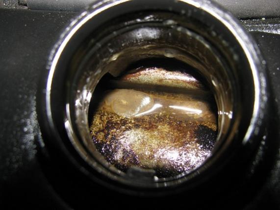

Alright. I re-checked some things this morning.
Good news: The coolant in the reservoir looks to be as pristine as when it was first put in.
Bad news: When I removed the oil cap, more coolant was 'up there' directly under the opening, but on top of the cylinder head. The first time I saw coolant up there, it was pretty much clear. this morning it is has some of the chocolate milkshake look in sections of it. I am trying to attach a photo of it.
Attached Thumbnails forum newbie - bad intake manifold gasket?-img_2363sm.jpg
Old Feb 21, 2015 | 10:33 AM
head gasket is my unfortunate vote
