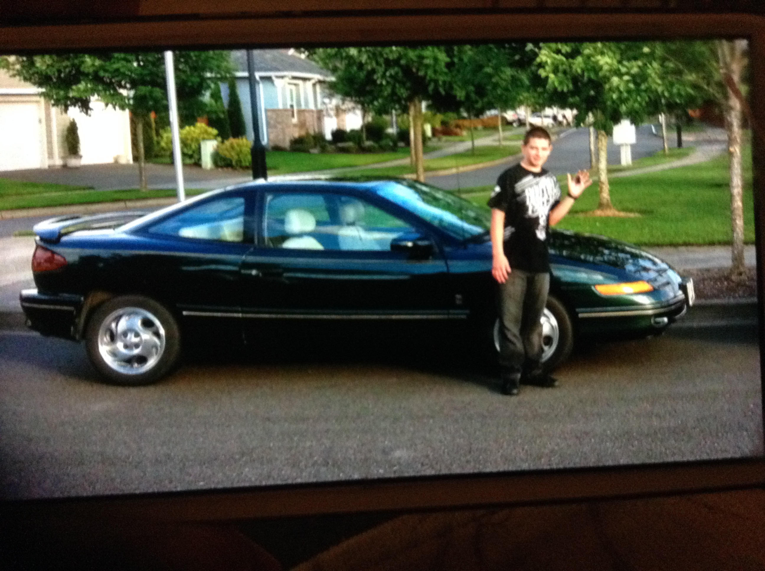

I have a dark green 1996 SC2 Saturn, the Windows are blacked out as well as the wheels are painted black. I want to smoke out the tail lights but don't know how to go about it. Please help me by pointing me in any direction. Also what are good aftermarket websites. Thank you all so much ��

Welcome. Funny, the windows aren't blacked out and the wheels are stock color....is that you in the pic?
And what did you do to get your car keyed so bad?
If you fixed it, I'm interested in knowing how.

Thank you both for responding back to me, first I just want to let you know derf that that is an old picture, the first day I got it. I have since plasti-dipped my wheels and tinted my windows so you can't see in. And my car was never keyed that is just a reflection that looks like it.

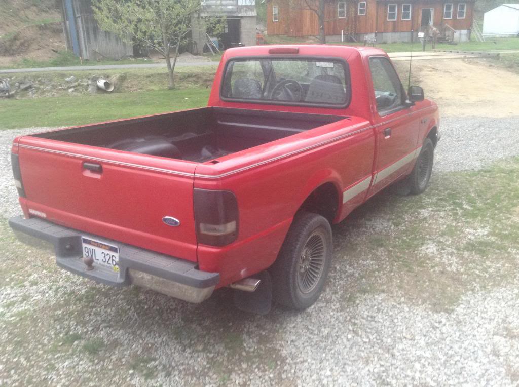

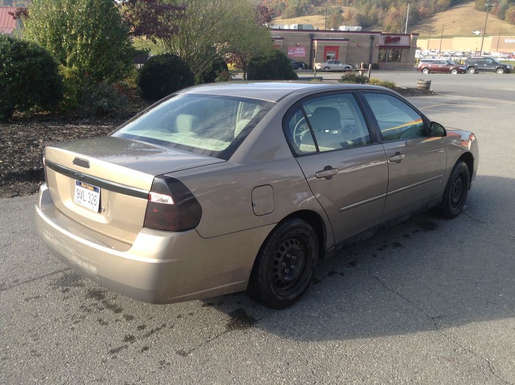

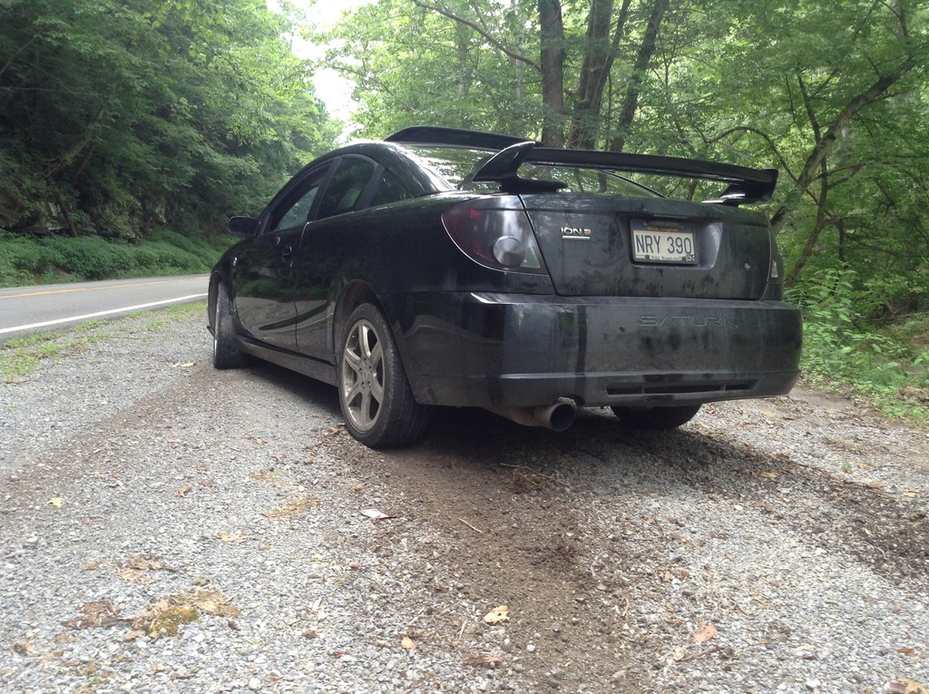

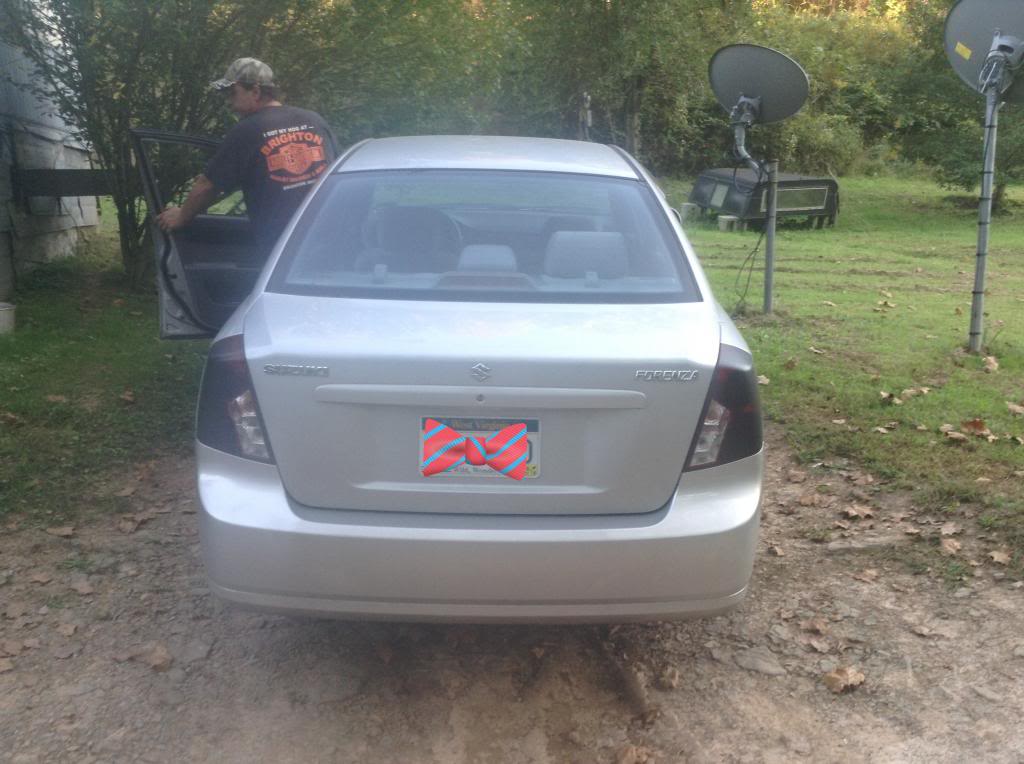

Taillight projects...
07 Malibu...

04 Ion Redline...
95 Ranger...
05 Forenza
^^ that wasn't me in the door of the car
With such lights(all these vehicles were mine), I haven't been hassled by police at all, even with it being illegal in my jurisdiction... Notice how on all the vehicles, a hint of red can be seen through the black? The light shows through, even in the daylight... The Suzuki was darkest of all(my first set of lights), with my subsequent sets being better done and not quite as dark, in person
