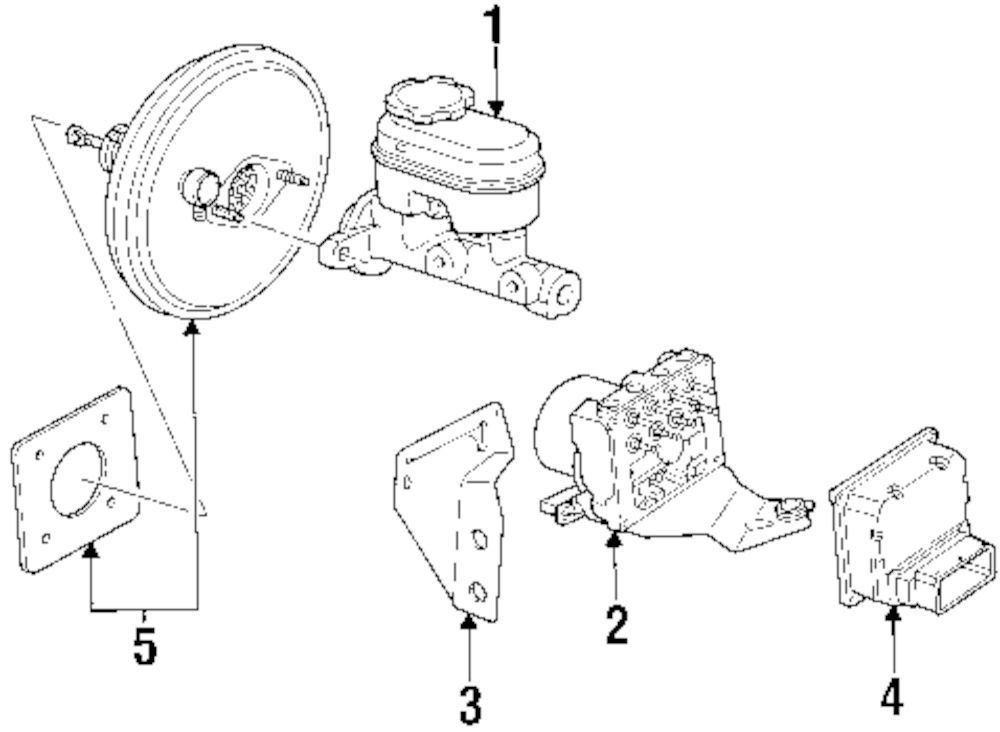

Anybody know what is needed to convert rear drum to disc breaks? I noticed some kind of bracket above the drum plate to the left? What is that? I have a 2002 Saturn Sc2. I don't even know if I have a ABS system or not? ABS brakes are complicated. I think on my dash it has the option, but the light don't come on? What's another way to tell besides slamming on your brakes? I Love my Saturn it's all I got.
Drum to disc conversion: Extensively covered on Saturnfans.com, right down to the correct parking brake cable you will need based on the year of your car.
When you get your car moving up to 4 miles an hour or so, you should here an electromechanical sound from the driver's side under the hood. This is the ABS system performing a self check.
You can also open the hood and look. ABS brakes will have modulator valves between the master cylinder and the lines that run to the wheels.
2002 looks something like this
#2 being the modulator valve
