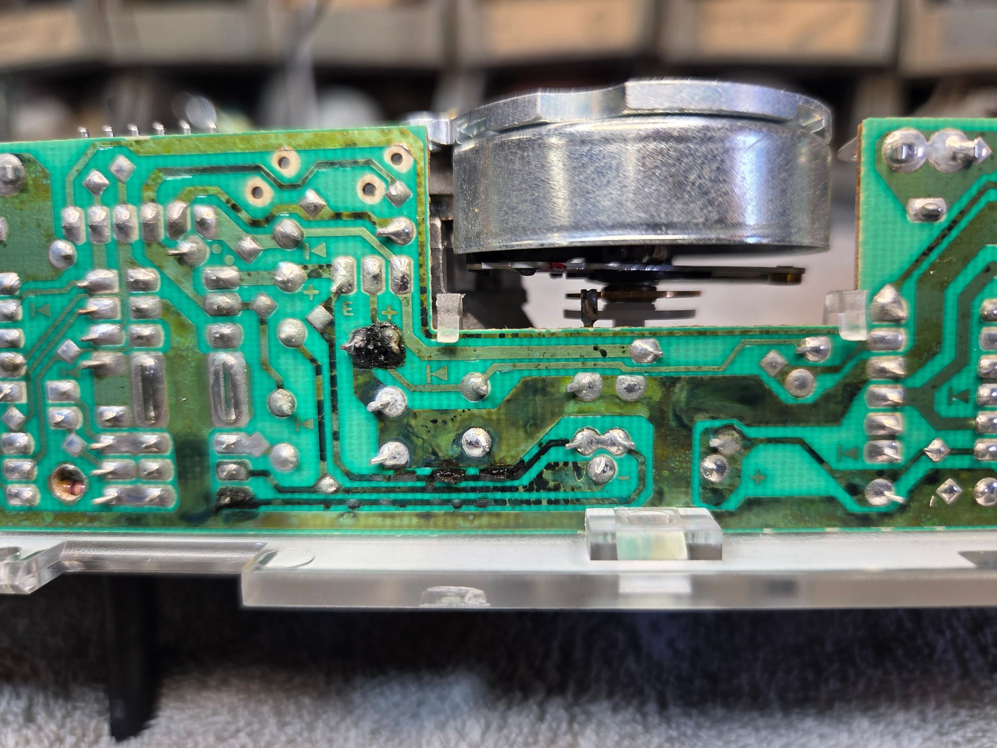

Pulled the dash and cluster today. The capacitor I previously installed leaked again, and many of the PCB traces look burnt. Checking continuity, several of them were no longer making contact between solder points. I figured at this point, it's toast, then figured I might as well try putting some jumpers in to complete the bad traces, replace the cap again, and see what happens. I unsoldered the cap, and it turns out that I'd installed it backwards Apparently when I looked at the side with the + sign on one hole, when I flipped it over to put the cap it, I messed up. It worked for 5 years, but eventually failed, and probably heated up the traces.
So I cleaned it as best as I could, installed another cap the correct way, then made 4 jumpers using thin insulated wire, and the cut off legs of the cap. I've checked continuity on all the traces, and I THINK it might be okay now. Not really expecting it to work, I put the cluster in temporarily, and started the engine. The tach worked, fuel and temp worked, and the speedo stayed at 0. Backed out and went for a drive and the speedo started jumping around, then went to 70 MPH and stayed. Oh well.... But I kept driving, and it began coming down, then after a while it seemed responsive, but reading way too fast. I downloaded a GPS app for my phone, and kept driving, and after a while it was reading just 2-3 MPH over the GPS speedo. BUT the odometer isn't working!

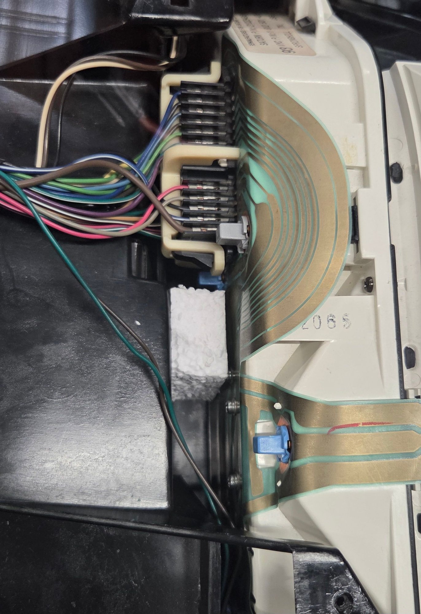

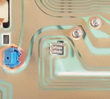

It works! Turns out that the 3-pin odometer connector on the back film PCB was not fully seated. I did push it and the other two connectors in well while assembling the cluster on the bench, but when installing it in the dash, the manipulation flexes the film and caused it to push out. Keep that in mind, and make sure to reach over and push it back in after mounting the cluster in the dash. In fact I may use some foam or something to push in there to make sure it doesn't vibrate out. I'm frankly amazed that it all works, after my mistake with the old cap, and soldering in the jumpers! Gonna drive it another day or so with the dash off to make sure it's okay, then put it back together

Simple solution to keep the odo plugged in, a small block of Styrofoam that fits snugly. The tach and speedo connectors have more pins and are more secure.
