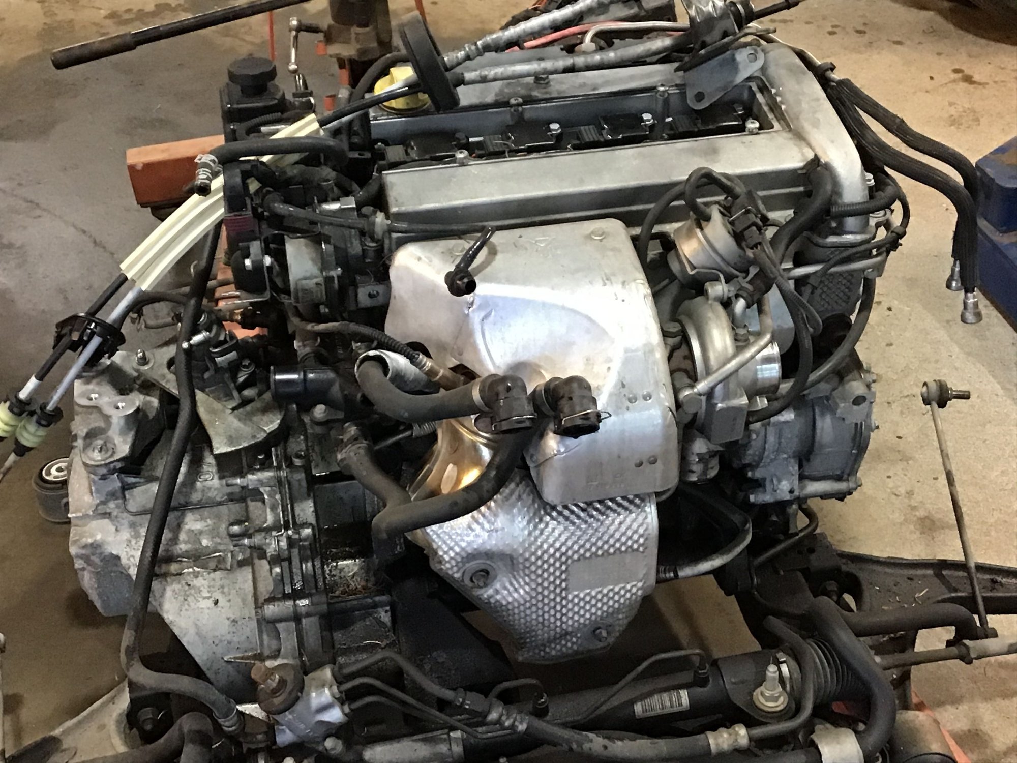

Finally got to the Saab today. It looks like I can make this work in an L body. I need to buy a pair of Ion Redline axles that fit the big spline transaxle to the little Saturn hubs. I didn’t want to make custom axles and these are a factory combo. I should be able to use the LSJ High boost turbo engine and the F40 6 speed transmission in an L series body. I have an extra clutch pedal assembly for an L so I will probably make the swap on a 2000LS that I own and is in my name. It is a dark green sunroof/ power seat car with a broken timing chain.

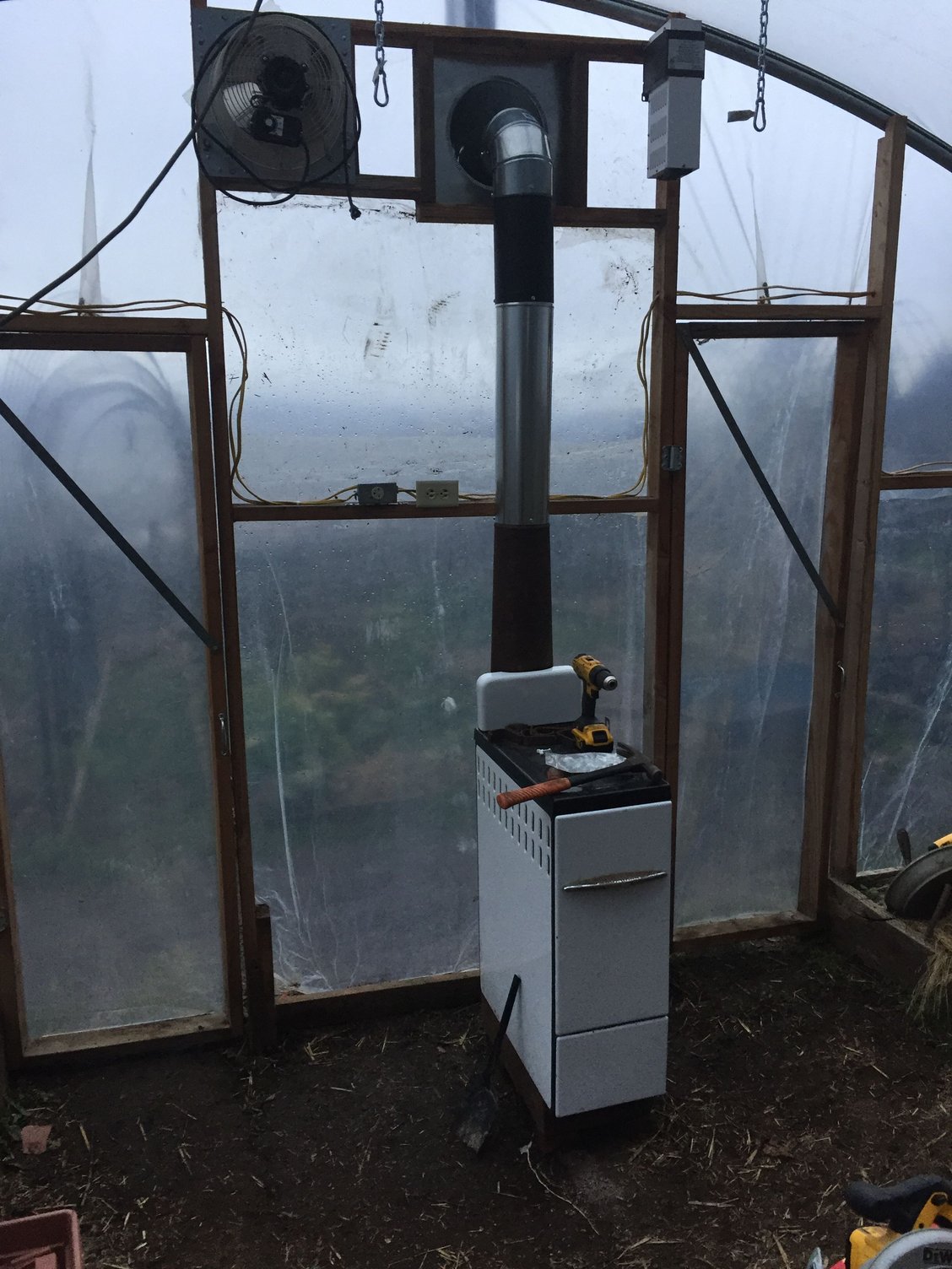

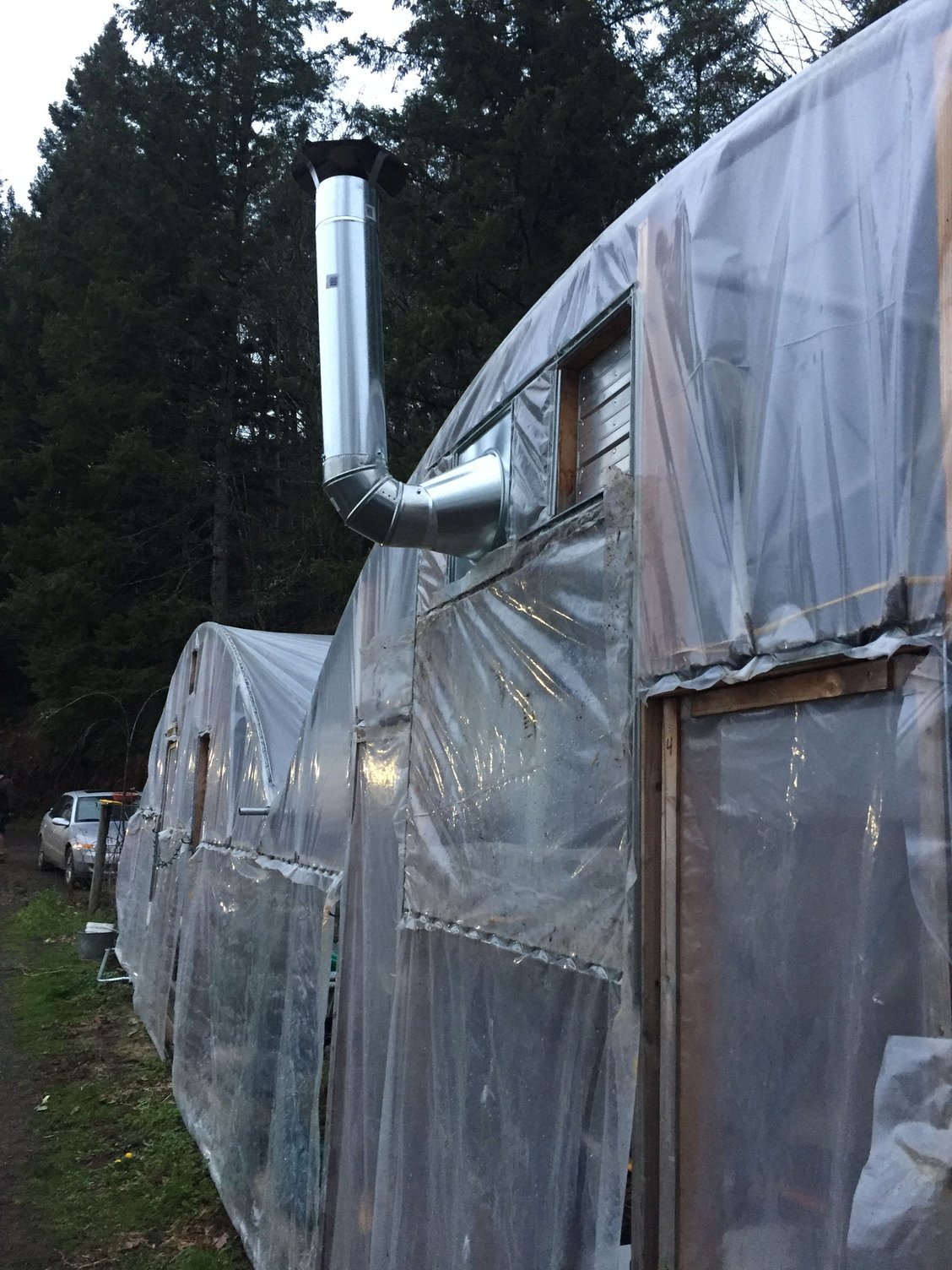

Been working on the greenhouse this weekend. My daughter is starting an organic vegetable starts business. She will be starting from seeds and wholesaling them through a couple local organic produce outlets. We will be heating only half of the greenhouse for the starts. This is a small wood burning stove for some extra heat. She also has a couple 1000 watt grow lights plus a couple 200 watt smaller grow lights for the starts. Should be nice and toasty inside. The grandsons will screw lath over the gaps on all the roll up sides until springtime. Back to the LS1 next weekend.

Don't buy cheap axles. They're to short for the redlines.
Zzperformance sells some that will work. And just an fyi zzps "stage 2" axle is just Napa gold rebranded. They're thicker than stock.
