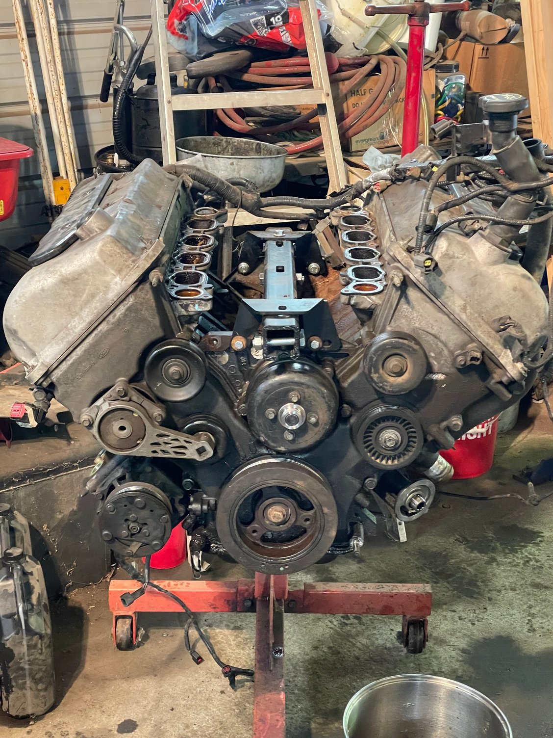

I bought a “turd” that runs well and drives perfectly. I also bought a “gem” that runs on 4, it has a broken chain to the left head. The 2003-2004 engines are 32 valve 4 cam 5.4L Ford v8 engines. The 2005-2006+ have 24 valve variable cam timing 5.4L Ford v8 engines. Both engines are rated at 300 hp on 91+ fuel. They run very well in these big luxury utility vehicles. The tow rating is 7500 lbs.

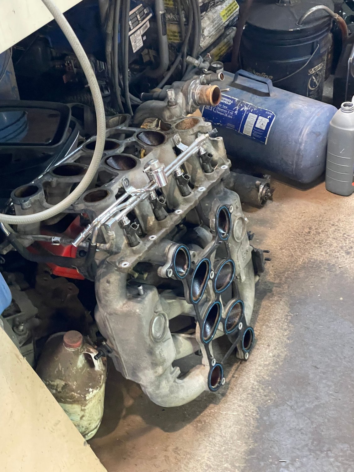

I am stripping the turd and I am now evaluating the engine before it goes in the gem. The engine is on a stand and the second picture is of the two piece intake manifold.

Was that two piece manifold one of Fords better ideas, Andy? Which one, in your experience, works best?

At least it is aluminum. The later engines have a plastic manifold with flaps that move to tune the intake. This aluminum one has one movable flap to tune for torque or horsepower. It has long runners and big ports, it looks like a tunnel ram that they made fit under the hood.
Old Oct 2, 2025 | 08:57 AM
Sounds cool. Any way you can post a picture of the inside of both manifolds? How are the moveable flaps attached?
