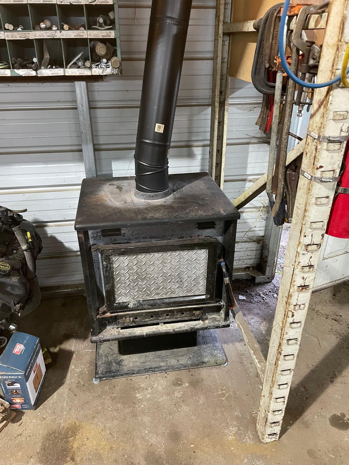

We moved a bunch of Navigator stuff around in the shop, loaded a top shelf with 03 stuff. Moved the 06 engine and installed a nice used wood stove, now there is heat in the shop. It has been in the low 30s for the last week overnights. Built our first fire and the shop heated up nicely. We even had snow this week on Wednesday, it is gone now. Back to the Chevy engine tomorrow. 😀

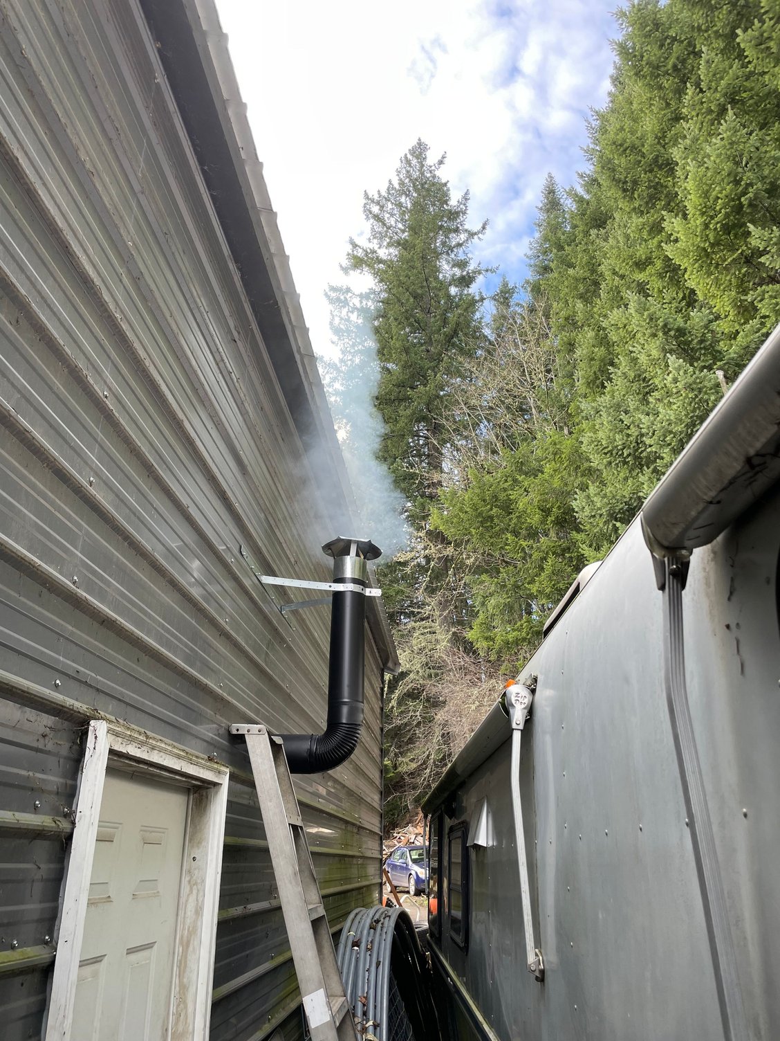

Installed and working, might extend the pipe above the eave. Snow will destroy it above or below. We don’t get snow every year.
Old Jan 11, 2026 | 08:09 AM
I think I'd extend that stand pipe above the eave, Andy. Better safe than sorry.
Old Jan 11, 2026 | 03:05 PM
We are extending the pipe above the roof several feet. 😀
