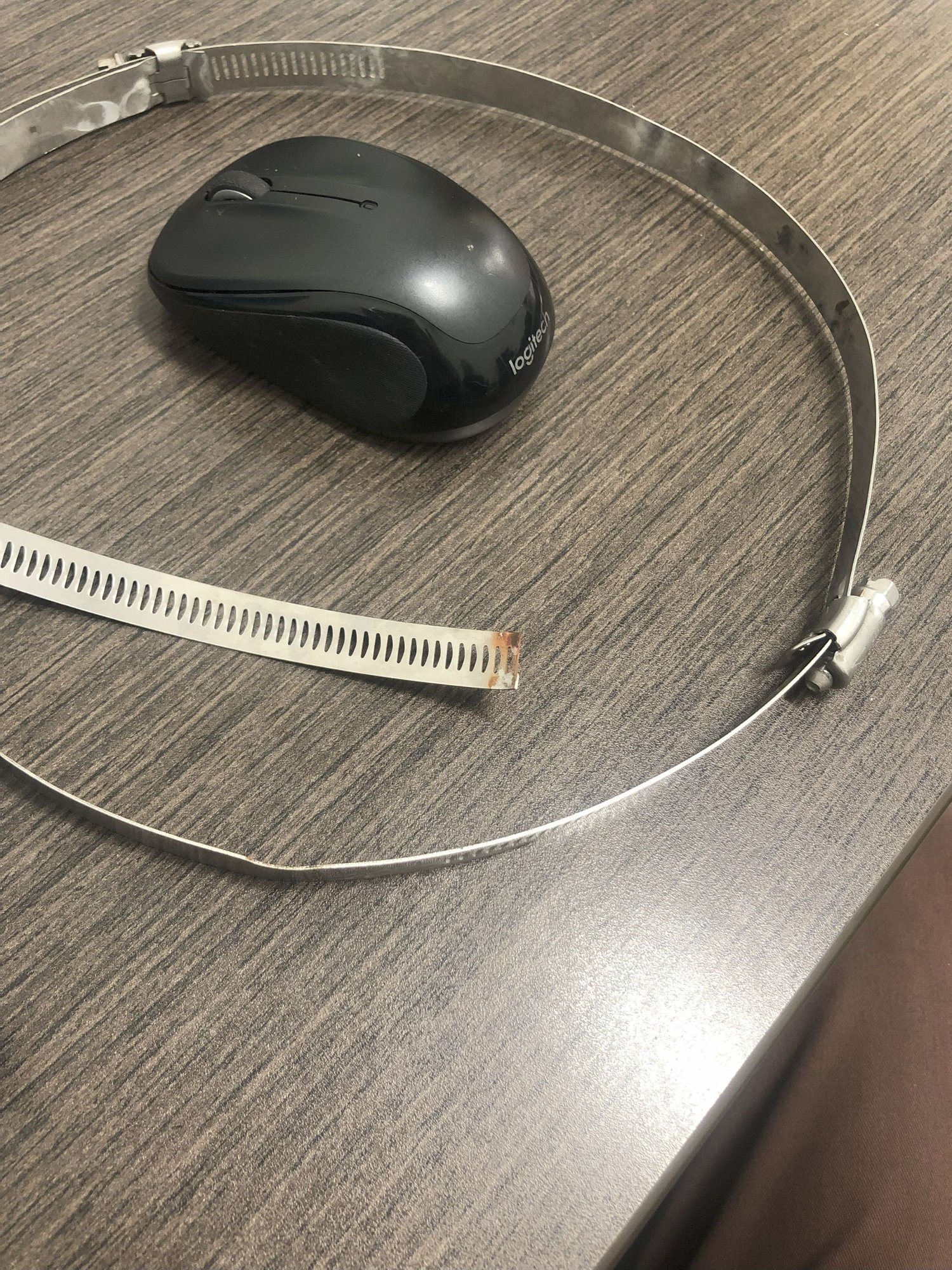

No car seems to like to sit for periods of time. Typically on the weekends (specifically Friday night); I park my Grand Marquis behind the Explorer and ignore my car while I do whatever I do. When I was exiting the driveway this morning, I could hear a gravel scraping the underside of my car. I figured that since I skipped mowing this weekend (bad weather, that's my excuse and I'm stickin to it), something underneath my car was scraping the tall tufts of grass and thus plowing dirt too. When I was on the parkway I began to notice that the [reliable] Ford V8 drone was getting louder; and when I got to work I found the cause. My temporary/permanent exhaust hanger broke and the driver-side exhaust was hanging pretty low. So I will drive carefully on my way back home; and rehang the pipe tonight.
Crazy thing is that I didn't drive the car at all this weekend. It must have failed while it was sitting in the driveway over the weekend?

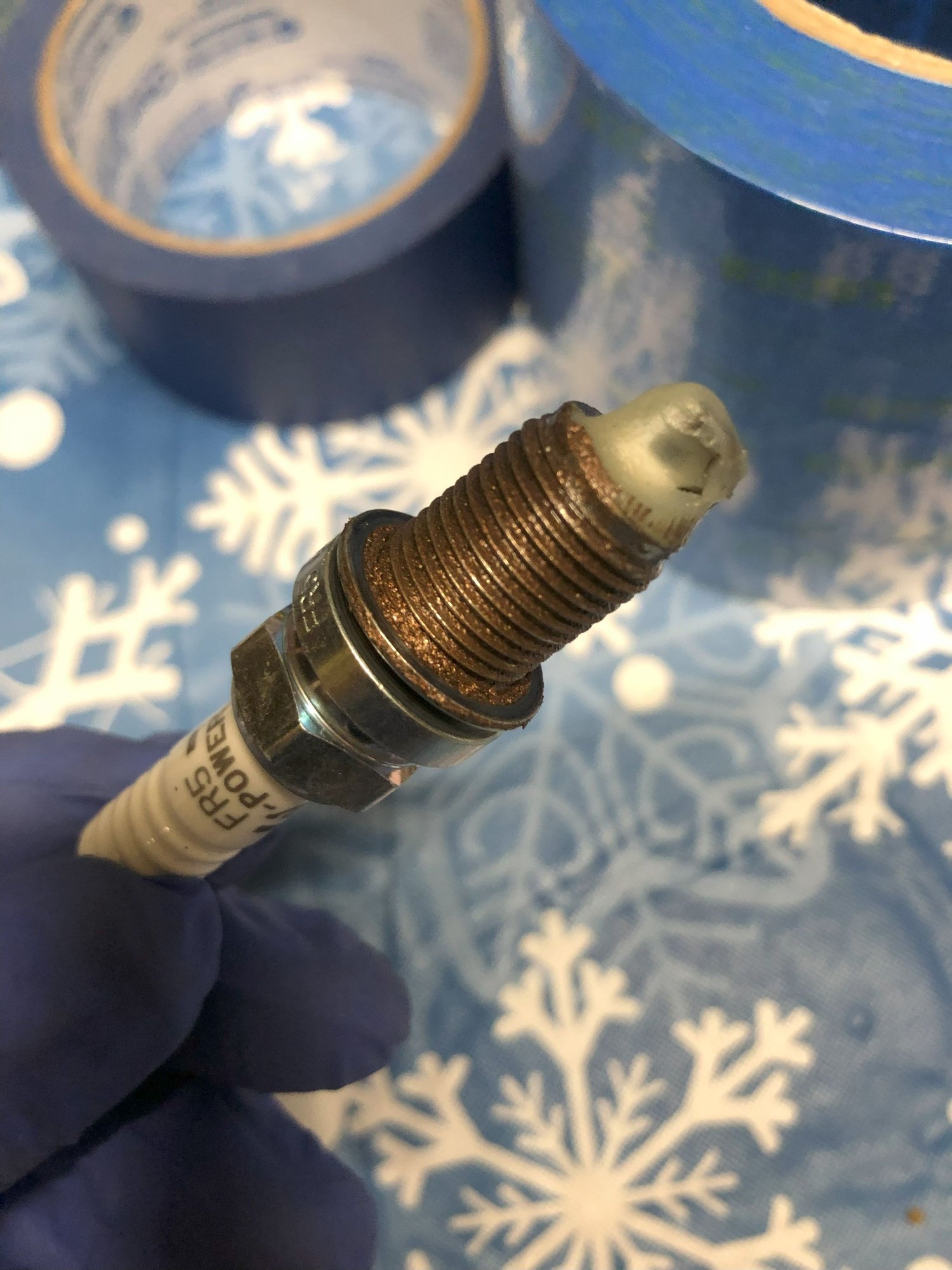

Now for the important stuff. I was feeling spry after the shelving install; so I went out to the Crown Vic and pulled all the plugs. I did this because I couldn't remember if I cleaned them off or not. I discovered that I had not cleaned them and they all had this Vaseline-looking substance on them. I hit them with carb cleaner and stabbed them back in. I left No.1 spark plug loose so I could check it again for that gel substance in a week or two. Now that is done; I am going to reload the base tune into my laptop and see if TunerPro needs an update. I am prepping myself for a 1st start attempt. I hope all goes well this time around.

I have never seen a spark plug with anything like that on it. Not even one with a blown head gasket. Are you sure that for some reason you didn't put the Vaseline on them? That's bizarre. As for cats, I won't offend anyone with my opinion of them. BUT my bet friends mother died from cat scratch fever 4 days after her 12 year old cat scratched her on the leg.

Do you use Pennzoil?
Did you fog the cylinders?
Gas additive remnants?
Is that like the goo that the ethanol in gas mucks up lawncare equivalent?
Pile of guesses.....

No Penzoil, I got Quaker State10W-30 in there right now. Perhaps it could be some sort of assembly lube? Or gelatinized WD-40? I was spraying the cylinders with that stuff before I did the 1-time squirt of ATF. Whatever it is; I hope it blows out of the cylinders.

Spark plug fouling: WD-40 will not burn cleanly like gasoline. It can leave behind a gummy residue
Is it older Quaker State Dino oil? Some of the stock of the old old Quaker State and/or the additives used back then had paraffin in it.
Could also be from coolant intrusion I suppose. What does it smell like? Kind of like a thick oil plus water mixture.
Might want to take all the plugs out and crack it over a couple times to get any remaining WD-40 liquid out of the cylinders.

I wouldn't put Quicker Sludge in a lawn mower for the reason that derf stated. Same goes for Pennzoil. I don't trust either one and that sure looks like it could be paraffin. Use a can of engine flush if you can start that car and then get some decent oil and a good, quality filter on that car. I'd suggest Valvoline Restore and Protect and a Wix, Purolator or Motorcraft filter. The Valvoline R&P has worked wonders in my sons 2016 Soul with the much hated GDI engine.
