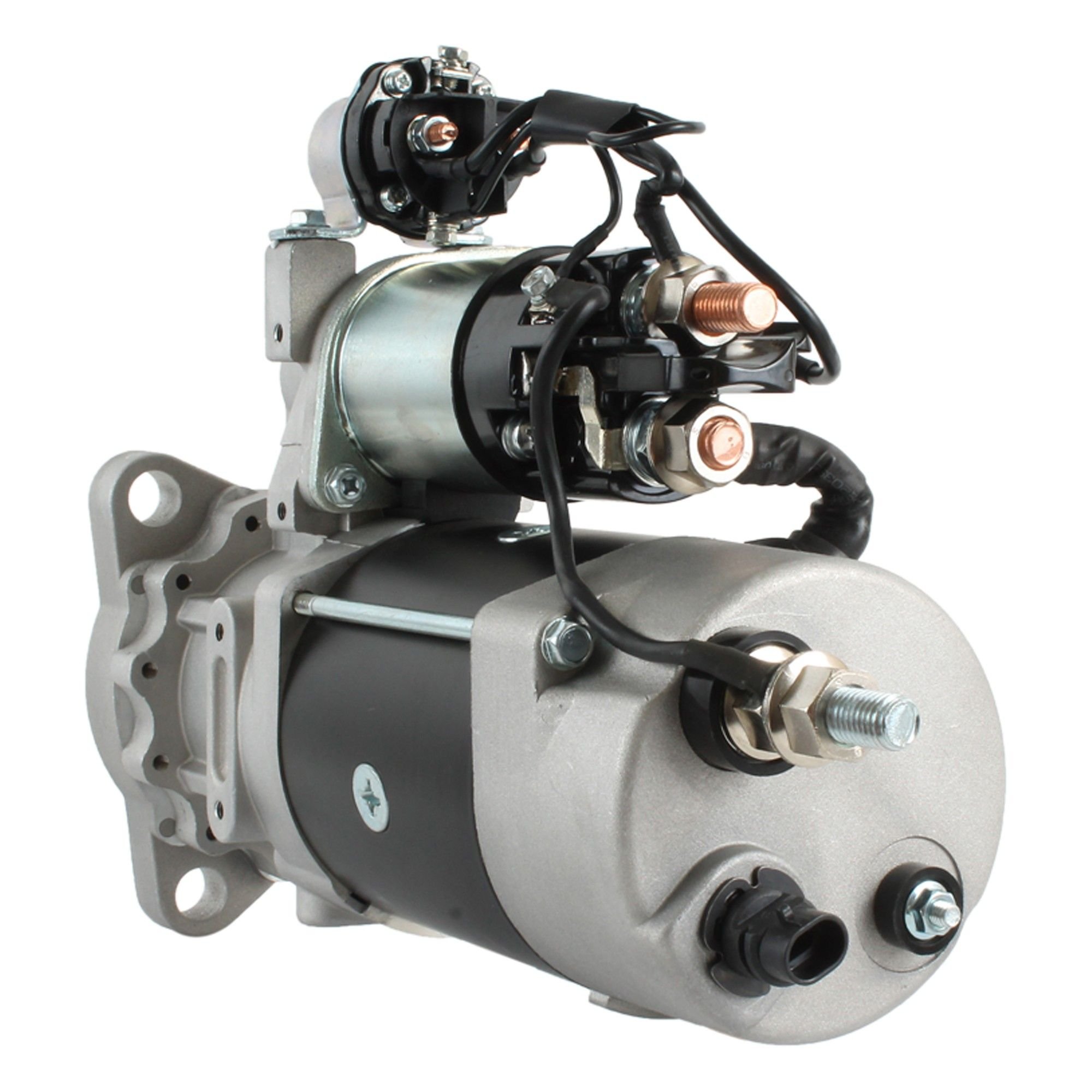

Here is a picture of a “ soft start Delco starter” that we use on our medium duty International trucks. It has a double solenoid setup to lower the load needed to engage the starter. It takes very little load to engage the top solenoid, this engages the main solenoid that strokes the drive and then spins the starter motor. You are doing the same thing with the first solenoid mounted to the fender. This way a small wire with little load can engage a high amp load starter easily.

Slightly off topic, but did older vehicles have fender mounted starter solenoids because back in the day, they were mechanical and not integrated into the starter?
Old Feb 8, 2024 | 08:46 AM
  #335
Older starters that used fender mounted solenoids worked a couple different ways. The starter on an old Y-block Ford I had used centrifugal force to spin the drive into the flywheel. The starters on 60s Fords used electro magnetic force to engage the drive then spin the motor once energized by the fender mounted solenoid.
