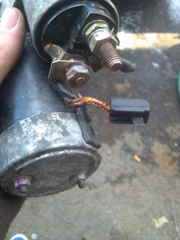

Well, Its been 2 months and 3000 miles on the new engine and used trans - time for an update! Everything is going alright so far, engine runs very well, however it appears that it has already started burning oil (or leaking it - somewhere). I havent really looked into it to much yet.
However, for the headaches that have troubled me for the past two weeks.
It started out as a trip to a repair shop to grab my friends car. As I was headed up rt 18, the battery light started flickering on, and off - bout every 30 seconds to 5 minutes (depending on driving). So we got there, got the car, and hopped back onto 18. Under WOT, the battery light came on and stayed on, until I hit next gear and laid off. Now it was worse, with all of the lights flickering in my car when the light came on, and happening more often. Got home, parked it, and went inside and raged for abit hahaha.
Started at the tensioner (since I forgot to replace it and was original) and belt, since it was squeaking. Fixed the problem, for the most part.
That was, until today.....
going around looking for jobs, the car wouldnt crank at one of the stores I stopped at. Lights dimmed, solenoid clicked, but nothing. So, I pushed it out (with a good handful of people watching me now from the windows) and bump started it.
What was strange is the starter would engage when the engine was running, but would hang up when it wasnt.
Got home and was toying with it abit more, checking the battery cables and what not. Go to start it one more time and all the lights dim alot - and the chime starts fading out - I look up and all i see is smoke pouring out of the hood :/ So, now im struggling to figure out what happened, when I started checking everything out I found that the line connecting the starter to the solenoid popped out of the starter motor and burnt more than 75% if the rubber casing off.
Took it to pepboys & got a warranty replacement (thank god) - For some reason my friend bought a mini dirtbike while we were there (but thats another story)
2 hours of my day gone and hopefully the riddance of headaches from this thing (until I start toying with it in the summer)

Isn't it amazing what one frayed wire can do to ruin your day?
