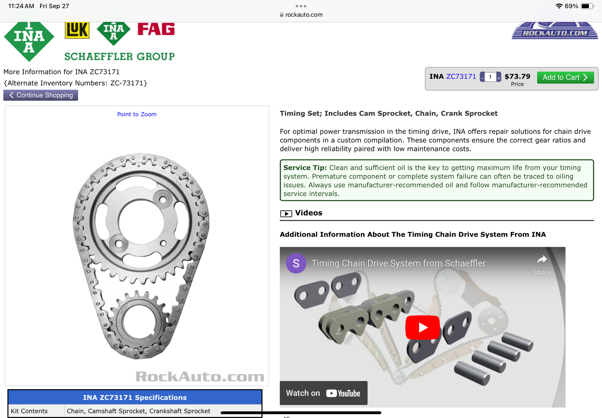

I buy a lot of parts from Rock Auto, The freight is a consideration but parts that you can wait for are always cheaper than a parts house.

Interesting comment about rock auto.....
I think it all comes down to literally what you are ordering and where the particular warehouse it is shipping from is located.
At least for s cars, the parts were always $10 cheaper for the identical OEM part, but the shipping cost would eat up 80% of the savings. Now it eats up 100% of the savings. RockAuto shipping to where I live more than offsets the savings on the parts price, so I have taken to GM parts giant as it seems the shipping locations are closer to me and therefore the shipping charges are less.
I'm pretty sure RockAuto dropships a lot of stuff as well. The problem sneaks in when they are dropshipping three different parts from three different locations. You end up having to pay three times the shipping minimum cost. I always check RockAuto, but whatever works I go with.

I always heard rock auto specifically does not service the state of colorado, anyway. For the internet, I have always used ebay, it is what I know. the timing chain and sprockets should arrive on 10/7, and cost 111, including shipping.
