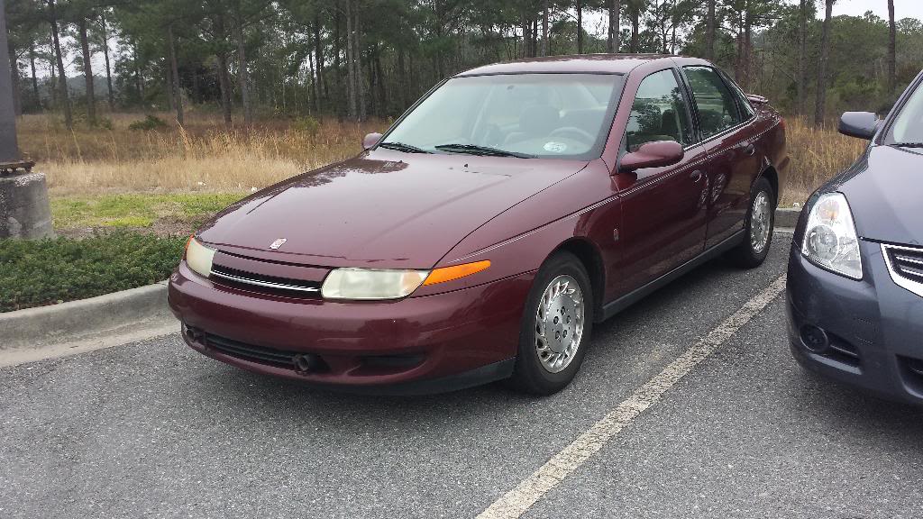

Well we just bought a Mustang as our weekend car and the idea was that we would drive our cars and save the stang for the weekend. Unfortunately somebody stole my civic shortly after, so now I am driving the wife's Saturn, thus I'm here. It's not a pretty car, little old, a little rough as the wife didn't take care of it like she should have, the gas gauge doesn't work and neither does the odometer. All in all though, the AC blows cold, it runs just great, and gets me where I need to go every day. Almost 200,000 miles on it and still running strong. Saturns don't seem to be too popular so I'm looking forward to a community that is primarily saturn drivers. Attachment 1702 |
Welcome to the forum. I don't see anything wrong with the way the Saturn looks. It's proven to be a reliable car, it seems, so who cares what anyone else thinks? Your odometer problem is most likely just a stripped plastic gear that can be had off the internet fairly cheap. It's not that difficult to replace, you just have to take your time. There are a couple of youtube videos if you want to attempt this yourself. The gas gauge? If it's not a fuse, most likely a hole in the float or a loose ground wire on it.

I say the saturn looks rough because it has a TON of dings and dents on it. Plastic pieces on the inside breaking, and on the hood the clear coat has recently started peeling. I just buffed it and waxed it to minimize the clear coat peeling, but as we all know that's just prolonging the inevitable.
