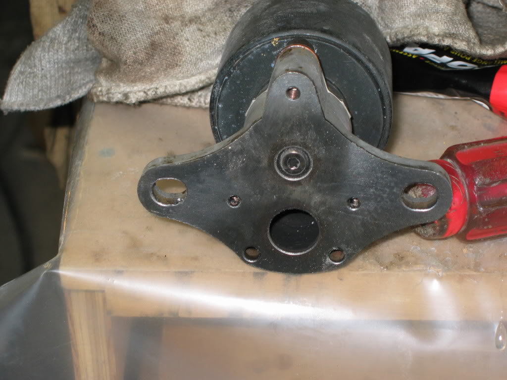

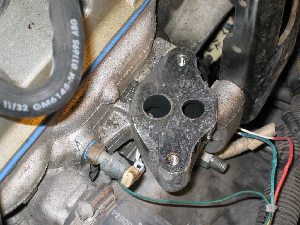

PIX
Can you post a pic of the bottom of the egr valve and the port where it mounts?
And one of the goo where the throttle body mates to the intake?

EGR and throttle body:
I think that's it. I just pulled off the EGR again and the goop I put on seems to have 'mushed' the gasket into a simmialr state to the previous one. It looks like old goop, but is mostly the gasket material adhering to the surfaces. Here's what it looks like after juste removing it again. This was completely clean less than 50 miles ago....

Not sure how to post multiple pics on this site so I am doing them as separate messages. This pic is what the EGR looks like afer I have cleaned it up again...

The mating connection on the manifold. When I but the EGR on the manifold, it rocks (wabbles) along the axis between the two bolt holes. Maybe as much as 1/32" . Note the new ECTS connector in the background!)
