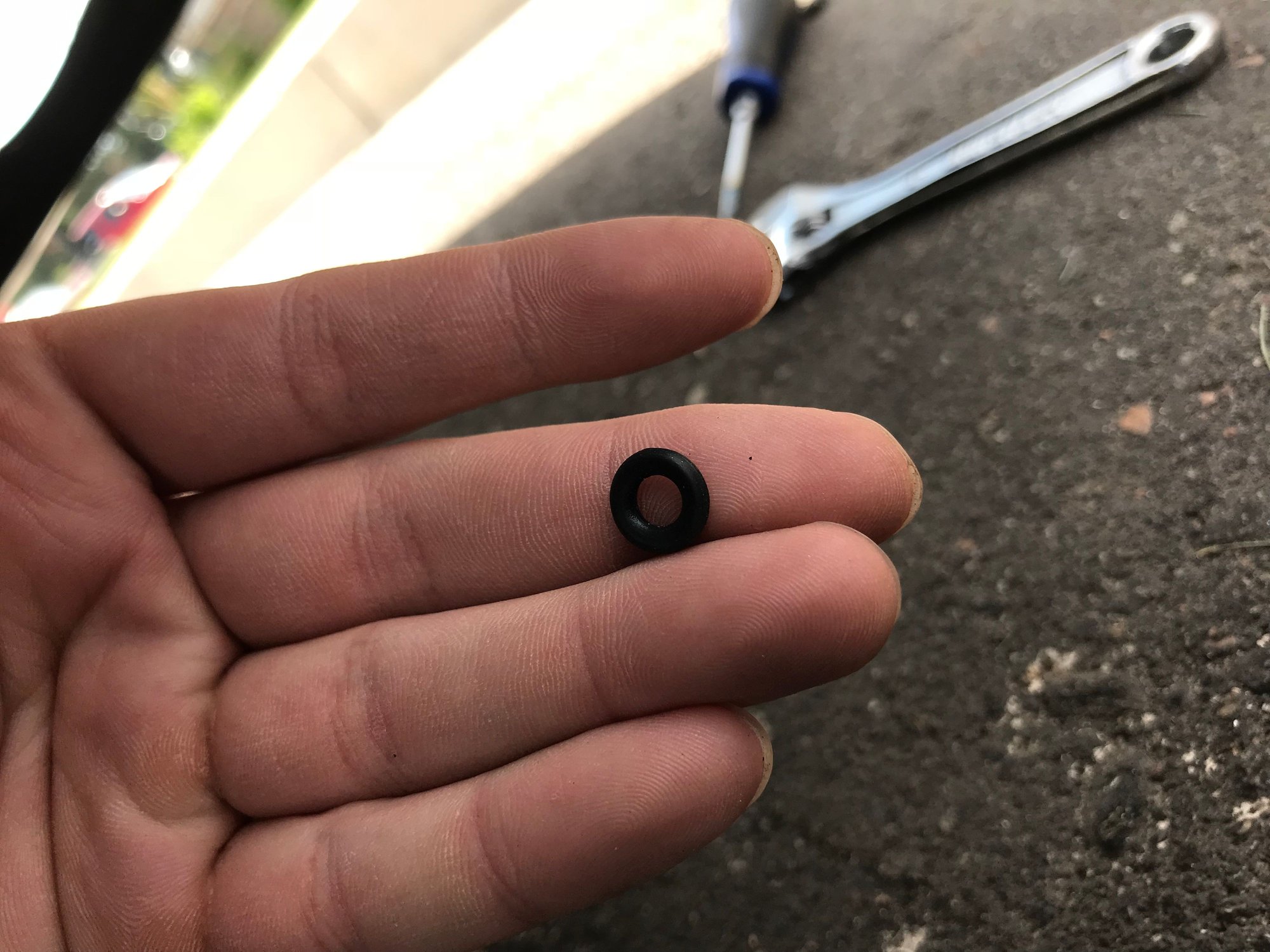

The saturn has been sitting since this epic fail. I blew through the reservoir to drain the coolant faster because I was getting impatient. When I did that I blew out the rubber o-ring that the petcock sits against to seal the lower drain hole (there’s the hole the petcock threads into, and a hole on the bottom that I’m assuming is used to slowly drain coolant?)
luckily I was able to recover the o-ring, that’s a whole other story.
Now im wondering, does the o-ring go over the shaft of the petcock? Or does it go inside the drain hole around the opening for the lower drain hole?

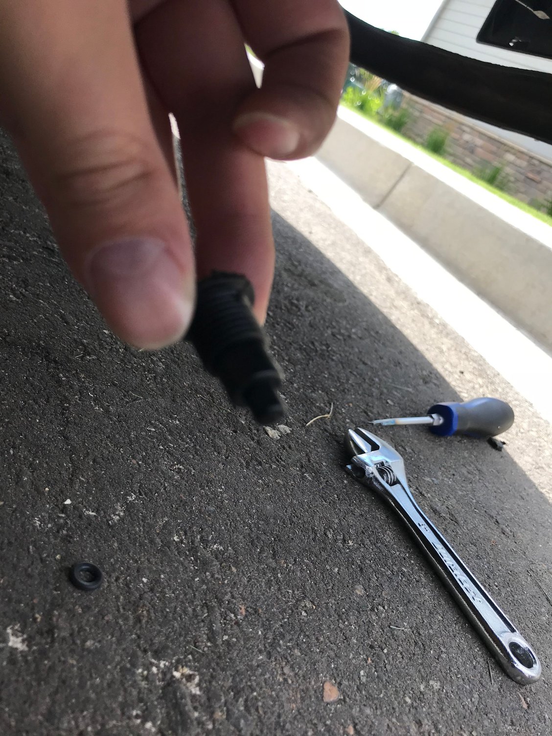

After work tonight I’m going to get a torch, heat up a flathead screw driver, melt a slot into the petcock, and try my darndest to get it outta there.

I heated up a flathead and melted it into the petcock, got the thing out, now I’m continuing with my coolant flush. My having to use the old petcock because none of the 5 parts stores in my town carry the type of petcock my radiator has. I’ll have to track it down.

Drain petcock, completely cheesed.
O-ring, it’s a miracle I found it.

End of the petcock I melted into with a screw driver.
Petcock reinstalled. You can see what I mean by the hole the petcock goes into, and the hole on the bottom I’m assuming is used to drain coolant a little bit at a time.

Fairly sure that o ring sits in some type of groove near the tip of the petcock. Based on size that is one of two explanations. The other you mentioned earlier, that it rests in a channel in the entry hole of the radiator where the petcock goes in, and a flat face portion of the petcock seals against it to avoid leaks.
