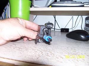

ok first of all the line that runs to the fuel injector rail ( on top intake manifold, towards front of the car) has the pressure running to it. There is no fuel pressure regulator on that line. I know I pulled it apart. It has one long thin odd shaped piece of metal that runs almost the whole length of the tube inside, one piece of plastic with several spines on it inside, and the fuel inlet connector. the line that runs to the black box underneith ( near firewall under intake manifold) is the non-pressure line that connects to the canister purge solinoid valve.
Now I did pull it off and I am going to replace it because the manul says it cold cause the problems I am experiencing. I was wondering if anyone has replced this with similar problems and knows that it works?

My bad....my mind was lost in 1st gen S cars (note my reference to my 95) when describing the above.. they had an inline fuel pressure regulator accessible in about the location you described...(not quite)
Indeed that looks like a canister purge solenoid....never had the pleasure of messing with one.....
