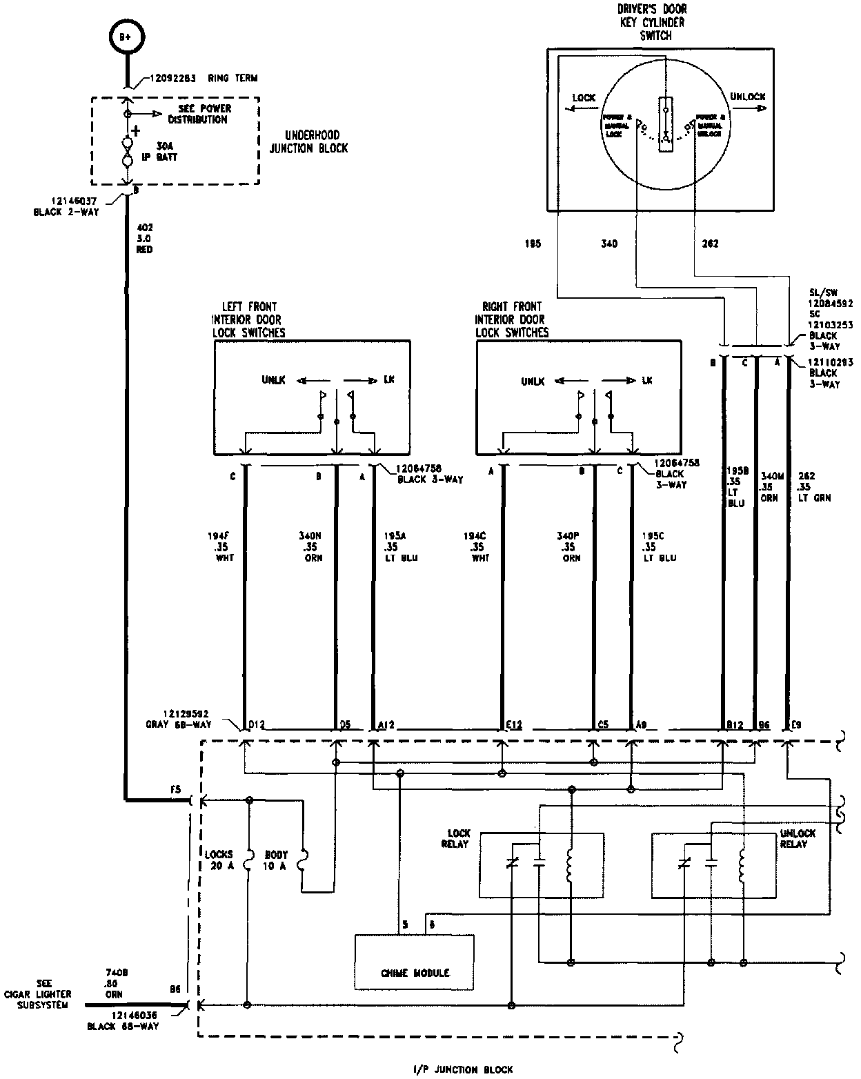

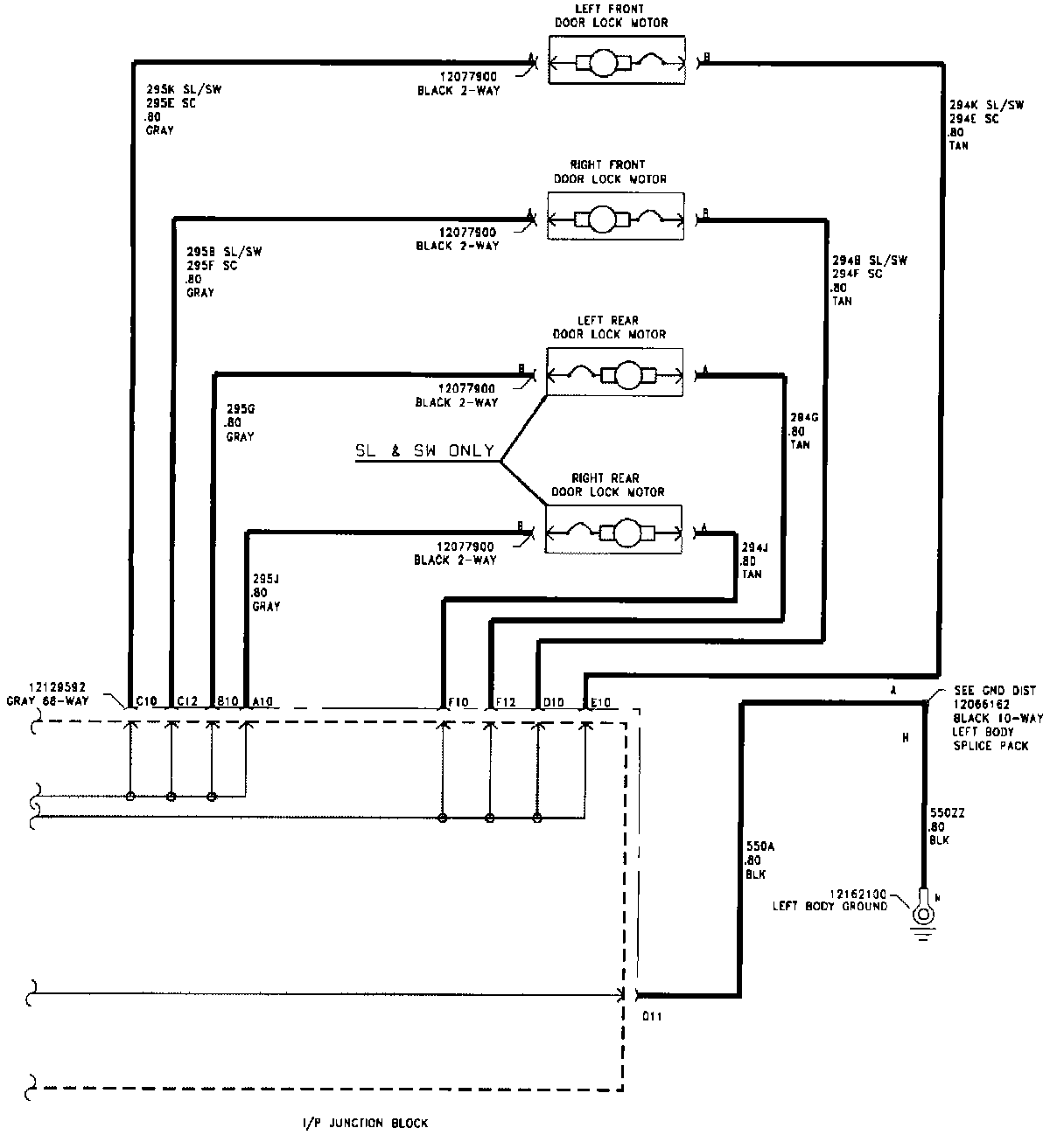

Home >> Saturn >> 1995 >> Coupe L4-1.9L DOHC VIN 7 >> Repair and Diagnosis >> Body and Frame >> Locks >> Power Locks >> Diagrams >> Electrical Diagrams
Electrical Diagrams
Wiring Diagram:
Wiring Diagram:

I believe it would be the instrument panel junction box (IPJB) inside the cabin. The "locks" fuse. The fuse layout is included on the inside of the cover you remove to access the fuses.
