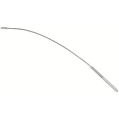

Get one of these FLEXIBLE MAGNET's..... Thats if it's a metal clip and it'll fit out the hole.

I wish it was metal, man, but it's a plastic plug with a couple of wires on the back of it. And even if it was metal, the damned hole isn't quite large enough to get the plug out. I may cut the hole just a wee bit larger and see if I can't get it out. It's really pissing me off that I can't maneuver it any direction and get it out. I'm going to physical therapy now for two damaged discs in my low back and can't fool with it anymore for a while. It just kills my back to get that low for more than a couple of minutes. I appreciate the suggestion, though.
