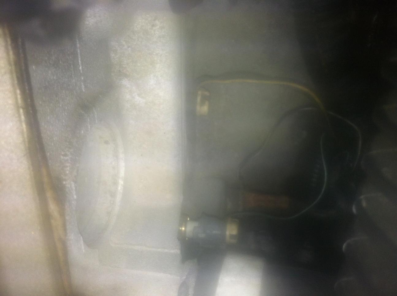

Onto to the problem, when I start the car up cold it runs great and idles perfect with the occasional spike in RPMs, but when I get the car up to temperature is when the bogging starts. Shifting gears or pushing the pedal from a complete stop becomes impossible, and when you turn the car off it wont start again because the air/fuel mixture is just waaaaaay too rich.
Earlier this week when I plugged in the code reader I got number 23, which says: Manifold air temperature (MAT) sensor-signal voltage is low or high. OR Throttle position sensor (TPS) error. OR Mixture Control (M/C) solenoid-open or short circuit problems.
So I what I replaced is the temp sensor that threads into the plastic intake air hose towards the front of the car, when I first did this I found that the sensor wasnt even plugged in, but nonetheless replaced it and plugged it back in (without replacing the harness), no success.
Next, I replaced the ECTS, but after doing some research on here I am thinking that over the course of the life of the car a wire was broken off because there is only one wire coming out of it and into a main line of wires (1ST PICTURE). Should there be two wires coming out of this harness? Also after I replaced the coolant temp no longer works, even though it always worked before. So again no success and added another problem in a broken temp gauge.
Thirdly, I replaced the TPS and that was a pretty seamless swap which went perfect. Still no success though.

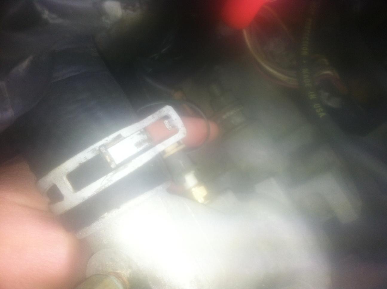

Lastly, I have included a 2nd picture which was taken from a standing over top of the engine, while facing the front of the car. In the picture is the ECTS that I showed in the first pic, but my question is what is the second sensor pictured that has a similar harness/clip as the ECTS? Is this the MAT sensor that I should replace?

The 1 wire temp sensor you replaced drives the dash gauge. Not sure what you replaced it with but take it out and put the original 1 wire device back in. Your dash gauge will work again.
You need to replace the two wire temp sensor mounted in the cylinder head. Replace with an ects and connector sourced from a gm dealership.

Yes indeedy it's right by the airbox that intake air temp sensor is. But not inside the airbox when last i checked. I think on the way early ones it mighta been in the airbox....too lazy to look it up right now...
