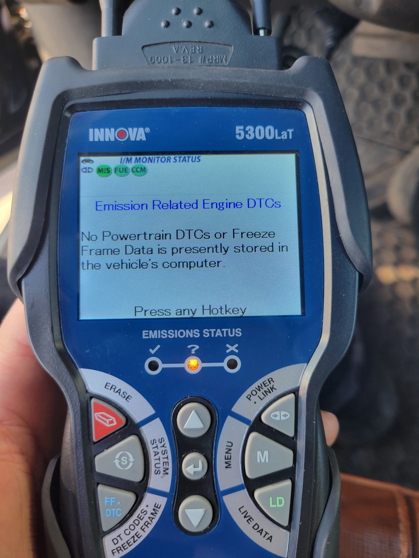

That information helps. Picutured is just some obd2 scanner from orileys. I'll have to go back and ask which one it was if it makes that much of a difference.

That looks more like a scanner than just a codes reader to me, but I'm NOT a mechanic. Looking at that screen, it looks to me like it's telling you that there aren't any engine codes showing up on the scanner, which is good. Looking at the top of the photos, I see arrows under the small car and various items. I think if you tap the arrow keys, you'll probably be able to access more information. Did you get any instructions with that thing when you bought it? If so, go back over them and learn how to use it to its fullest capacity.

Here are some screenshots I took from the Inova website for your model in terms of maximum capabilities. The actual list of capabilities depends on your vehicle and I haven't looked that up yet. But this is good information for you to have when working on other vehicles to know if this will access what you need it to.
I will look up to see if it covers your vehicle after I post this
This thing covers OBD1. I'll be darned. But does it cover real-time data for OBD1?
Support for 2007 Saturn Aura: for the 5300 lat
So it can't read live data for the ABS speed sensors, but it can communicate with the ABS module and likely determine if there are any ABS specific codes stored.

Well, based on your research, derf, it doesn't appear that his scanner should ever work on an 07 GM product! What up wit dat?
Old Sep 1, 2024 | 04:08 PM
No it will work, it just will not access to the SRS model or any extended diagnostics codes for this vehicle.
Based on what is wrong here, if it is just the ABS speed sensor He should be able to see it
