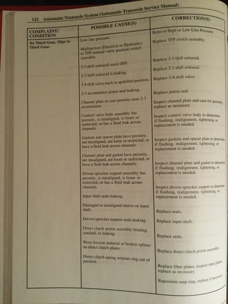

This is out of my Fsm.Name:  IMG_0020.jpg

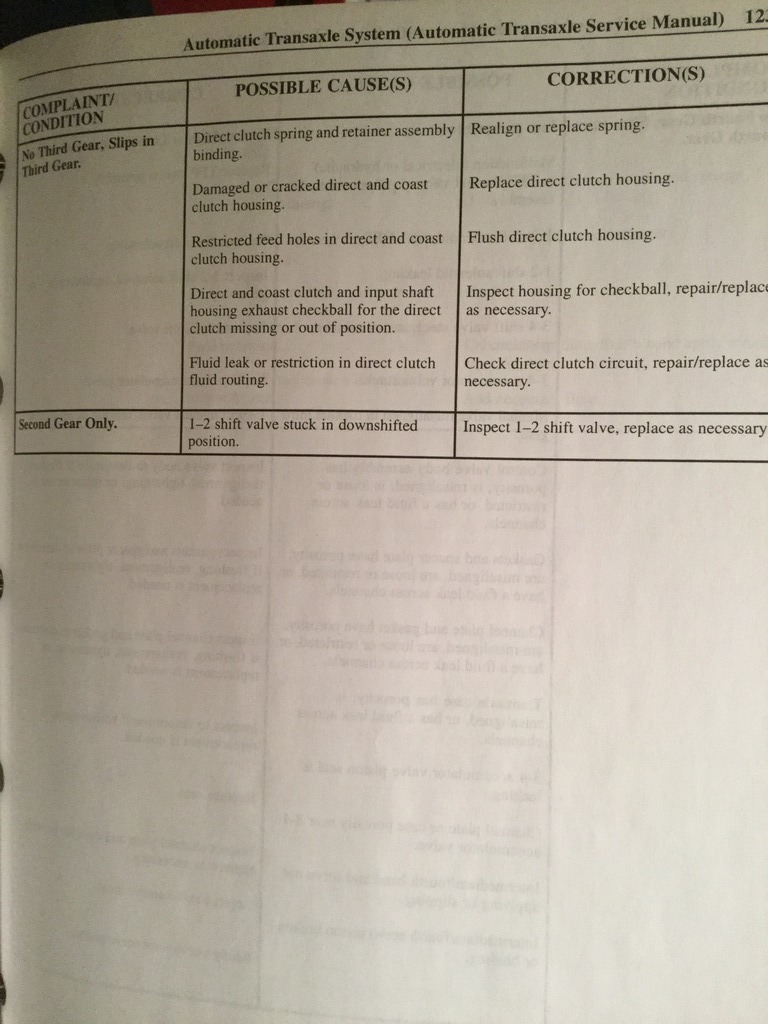

Old Feb 27, 2017 | 09:35 PM
  #29
