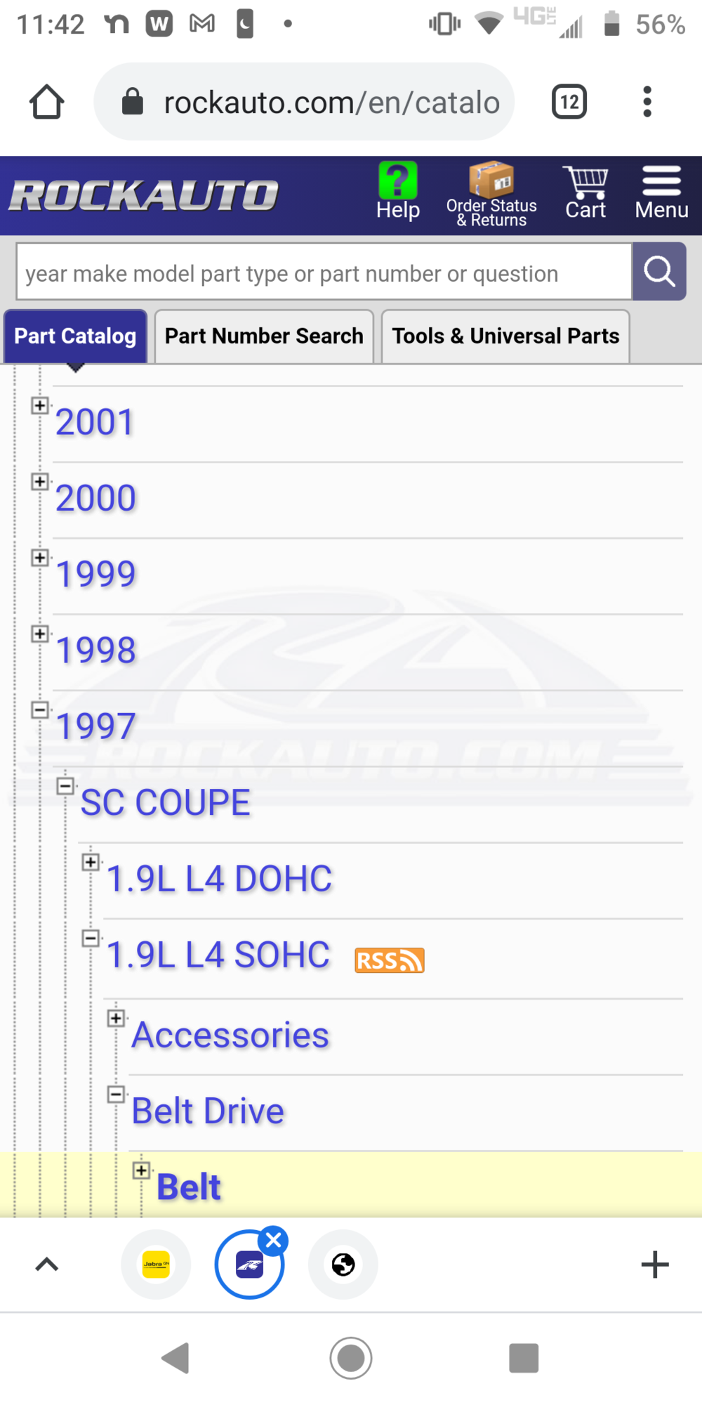

Yes, you can skip the PS.
Main 97 Saturn SOHC belt menu at rockauto.com
Parts under belts, standard replacement grade
for no P/S w and without A/C (as you did not specify)
Stick w ACDelco or Gates.
Shop around. Depending on where you live, RockAuto shipping prices can be higher than the cost of the parts themselves for single item low weight orders. Shipping in general will be high, but search by brand and part number and then go to the sites.
Look for richpin's youtube video on changing the serpentine belt on the S series
