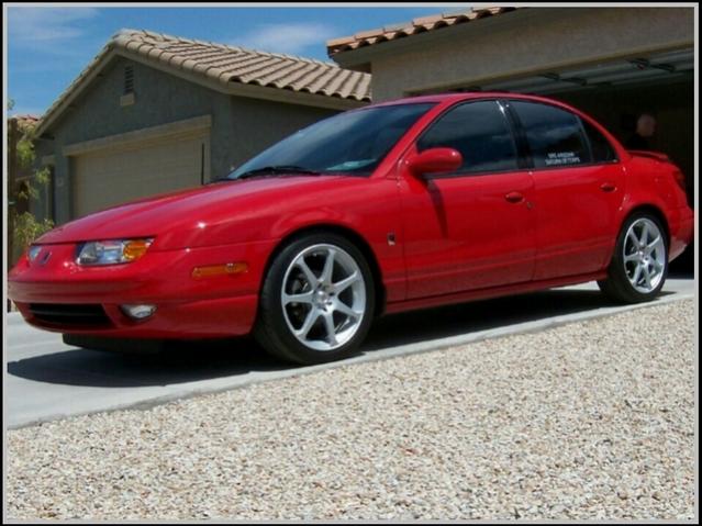

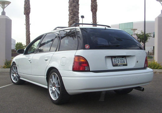

ah ha! so that explains why I have rub - my wheels are 40mm offset when the car is 50mm....
Old 02-05-2013, 08:30 AM
Join Date: Dec 2008
Location: Arizona
It's always good to read the stickys on a website.
NO RUB
