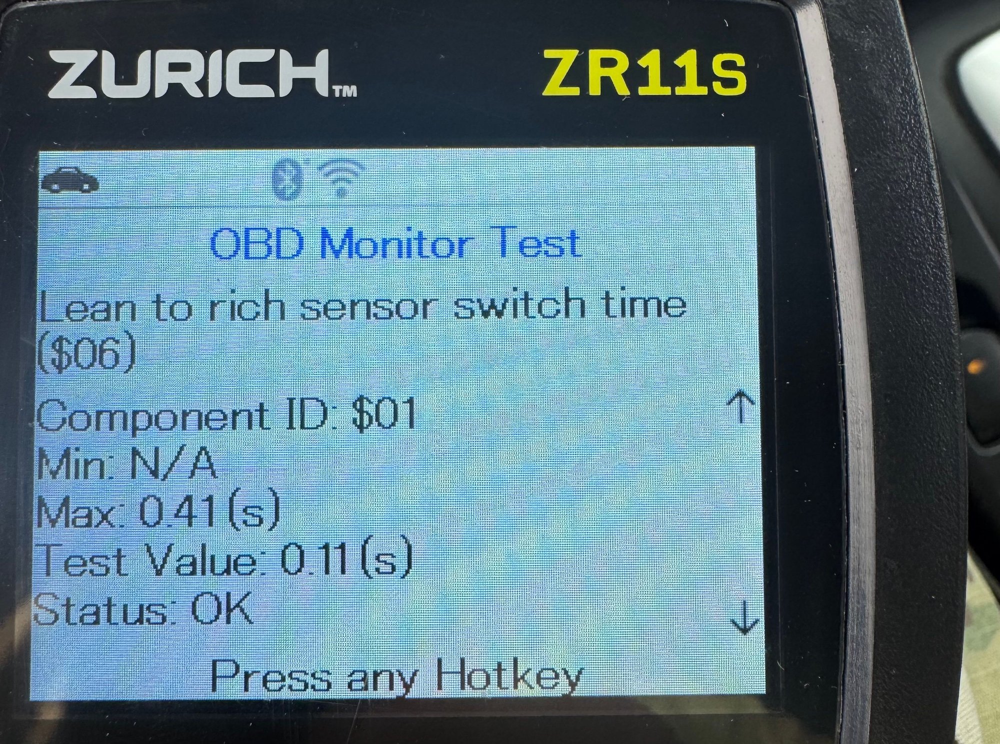

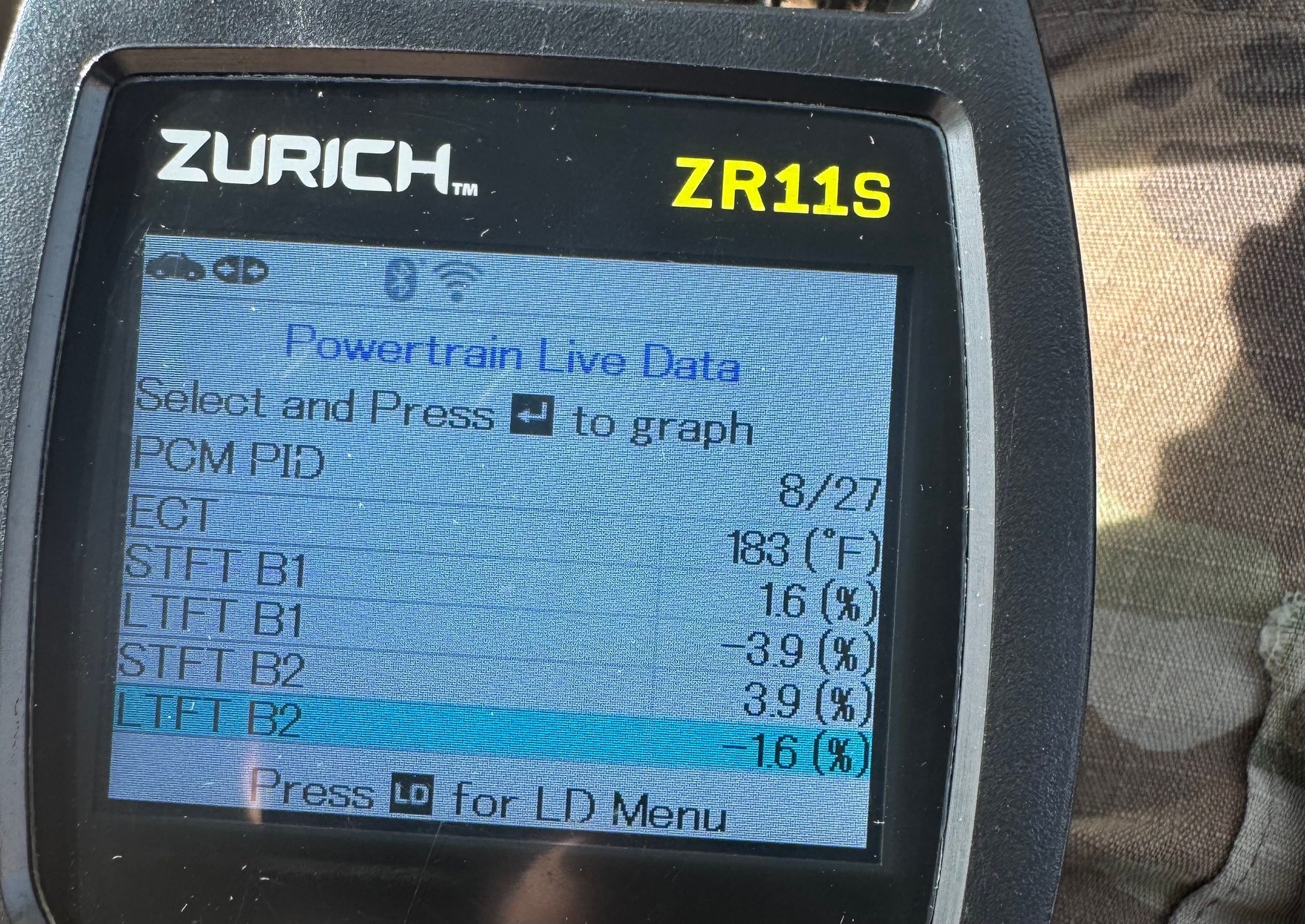

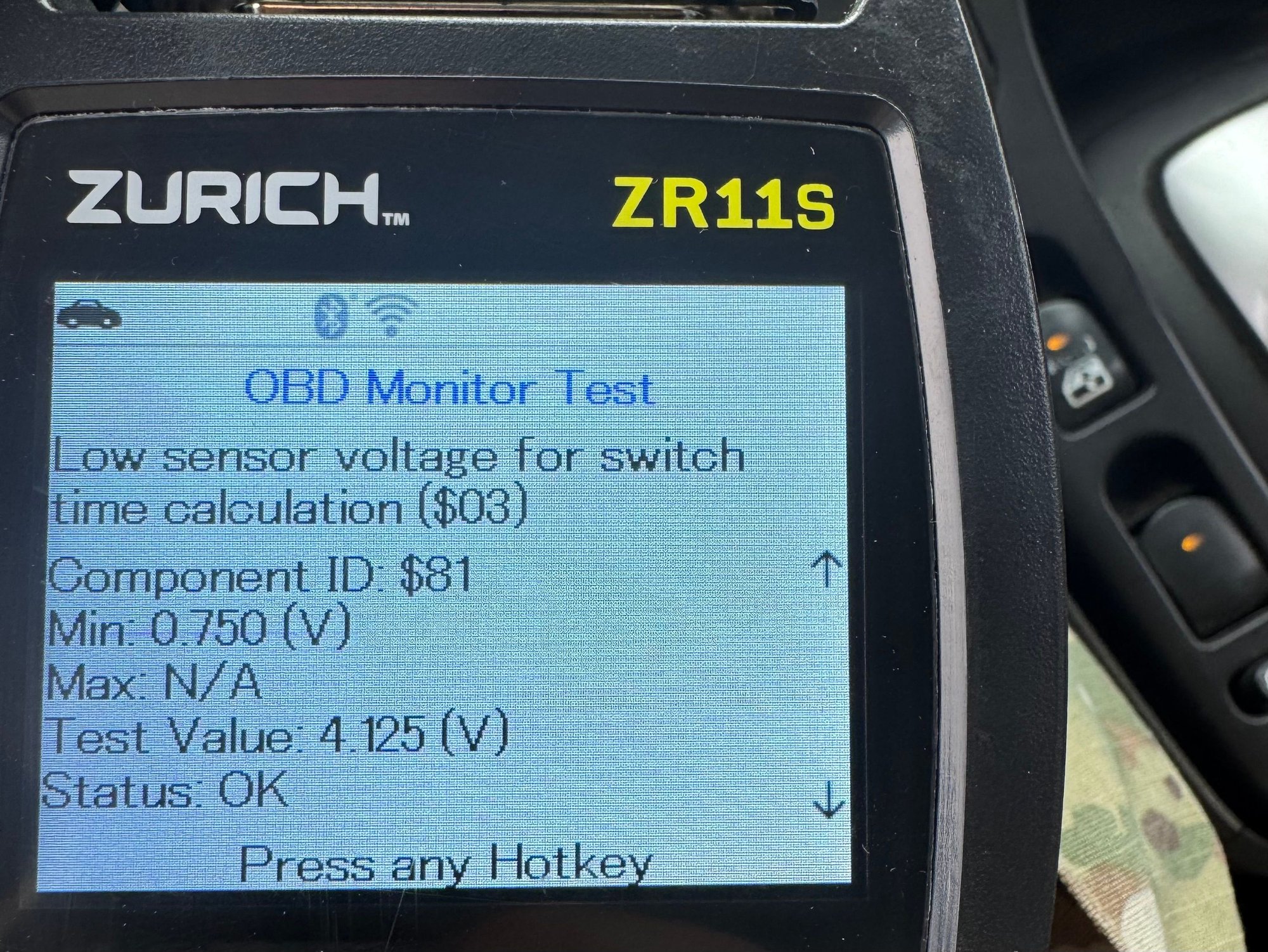

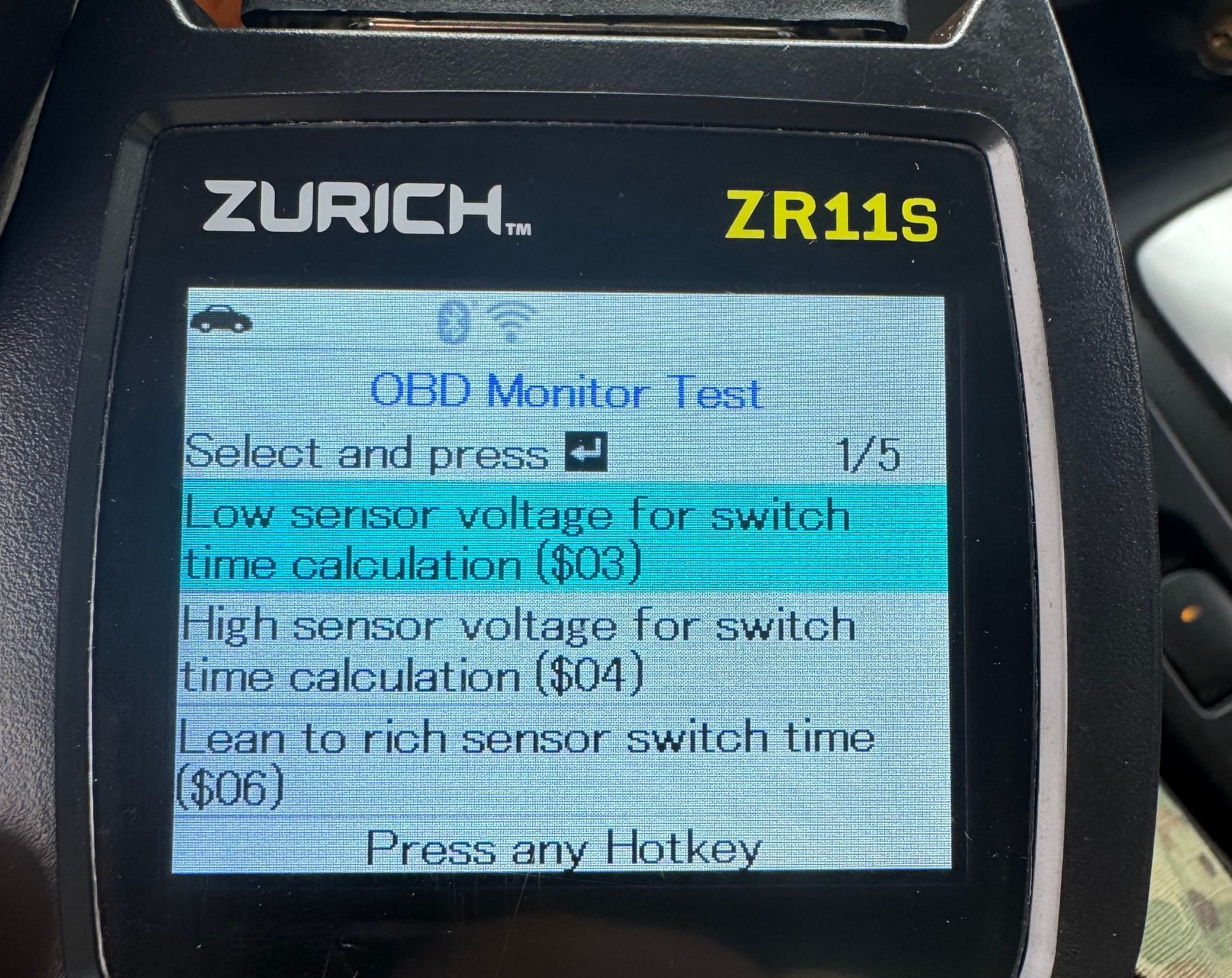

I finally bit the bullet today and just bought a ****ty 100$ code reader, It shows EVAP as red but won't give me an actual code other than some weird ones. I'm just surprised it never threw a check engine light. So now it's time to dig into this.
Old Nov 27, 2024 | 10:58 PM
Posts: 12,316
Good start.
The OBD monitors have to do with data calculated from real-time measurements of various things. That's why they don't have code numbers associated.
There should be a read obdII codes or read obdII pids function That will check the ECU for stored codes, like P0300 (example)
Please post the results of running that diagnostic scan.

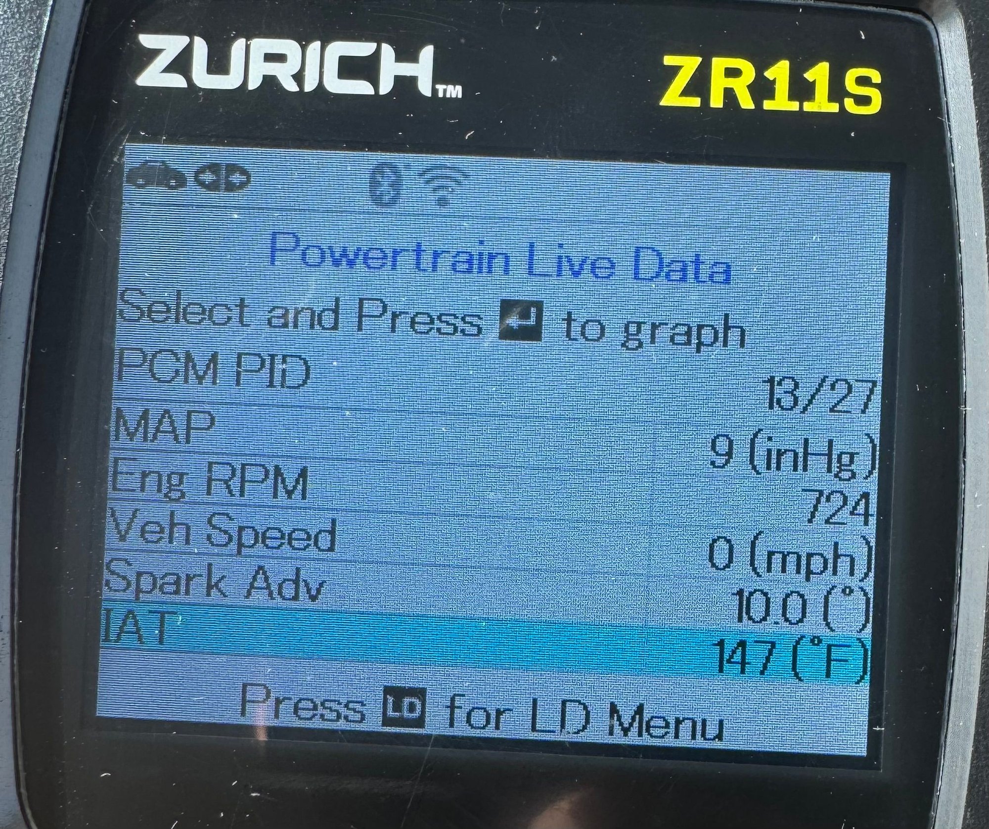

I would be concerned with the 9” vacuum reading.
Old Nov 28, 2024 | 12:05 PM
oldmarine's Avatar
Joined: Jun 2020
Posts: 300
From: Newport News, VA
Wink
But that image shows 9 (in Hg), which is 17 to 19 inches of vacuum, depending on the elevation of the location. I've been tripped up on this too, because different tools give readings in different units.
Old Nov 28, 2024 | 12:48 PM
Ah yes the Mercury/water issue. My SnapOn scanner keeps reverting to metric with each update. That really doesn’t help an old guy!
