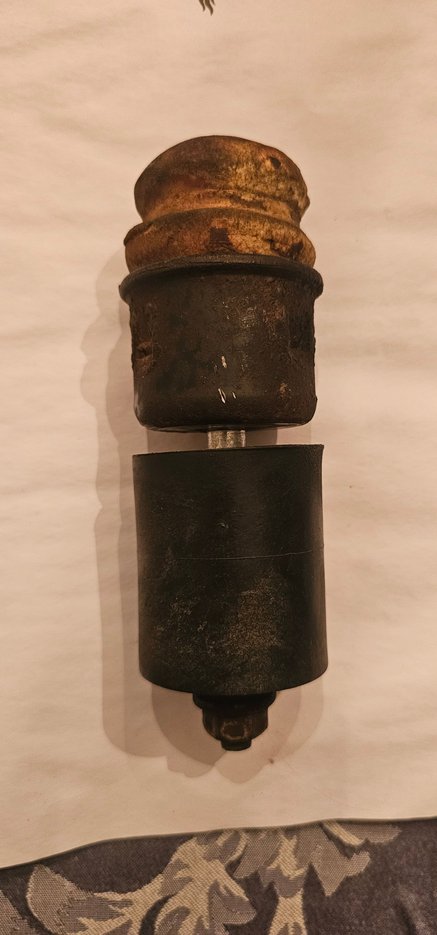

For one side , I found a used lower control arm with the bumper intact, so I removed it from the one to install on mine. I am not sure how long it will last, but at least I have one.
I saved the broken one and it is essentially a metal cup holding a plastic bumper insert with a long bolt going through a long cylindrical spacer. The link to the newer 2007 version looks very similar, but the space widens at the base in the newer version. I wonder if I could swap my old spacer for the newer one? It's an awfully expensive gamble ($165) if it doesn't fit.
The other thing I came across was a Mazda jounce bumper that appears tio be the same length (4.7"), but a little wider (2.2" vs 1.875""), and the Mazda part appears to be designed to ride on a strut, so I am not sure how one would secure a bolt in it to mount it to the control arm. It's by no means the same design and might not work , but it might be better than nothing, if one could figure out how to fasten it at the base with a bolt. The good part: it's only $12 for a pair. https://a.co/d/1zDCmHT
A third option might be to find an insert one cloild glue into the cup, but it's hard to find dimensions on what is listed. Sbort term, I am tempted to try jgluing the old broken one into the cup with contruction adhesive to see how long it will last.

Since the bounce stops are pretty hard rubber and don't deform a ton, could you possibly get a similar piece of rubber, drill the hole down the center, and then carve out the general shape so that the part will have some give? I would think even a basic cylinder of the right stiffness would suffice based on its purpose. Sure, the original shape contributes to the behavior of the part when it is deformed, but if you simply literally need this part to stop the motion by bumping into the frame, it doesn't have to be pretty, it just has to be functional.
