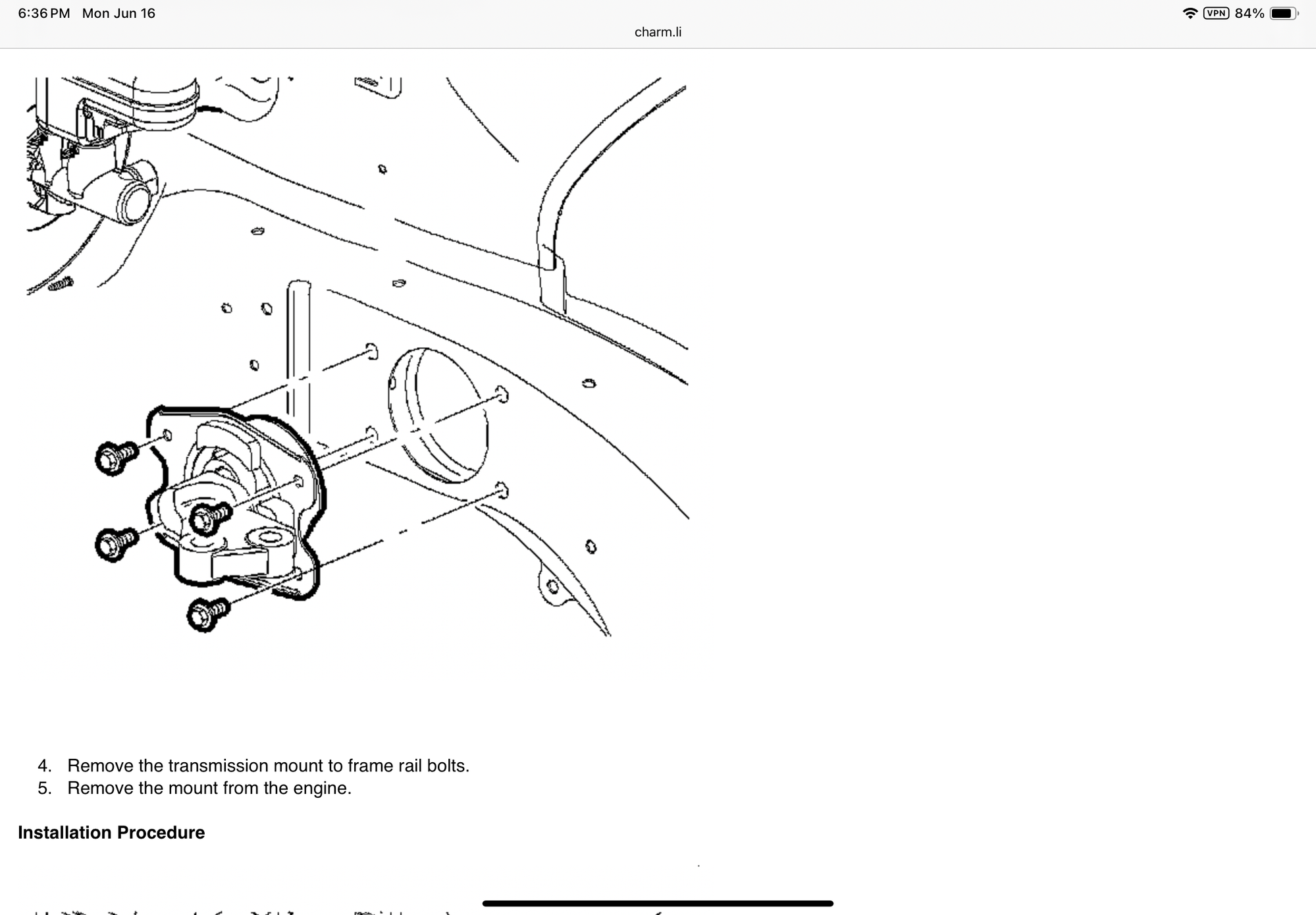

Old Jun 16, 2025 | 08:54 PM
Default I have not found this mount for a 2.2 VUE
Old Jun 16, 2025 | 08:58 PM
Your VUE has three transmission mounts. I have not found the mount that hides in the frame rail under the battery tray. The transmission front and rear mounts are everywhere.
Old Jun 16, 2025 | 09:20 PM
There are two different parts listed for your VUE with the same part number
Old Jun 16, 2025 | 09:23 PM
This mount appears to be the one you describe, Napa says it fits both manual and automatic 2.2 VUE.
Old Jun 16, 2025 | 09:32 PM
The black Napa mount I listed appears to be the front transmission mount for a Honda powered VUE. The Honda V6 VUEs only have two transmission mounts, a front and a rear. Your VUE has three transmission mounts. One bolts to the top of the transmission and goes through the driver’s side frame rail. This mount supports the load. The other two just dampen the twist from on and off the throttle. I cannot locate the mount that goes through the frame rail.
