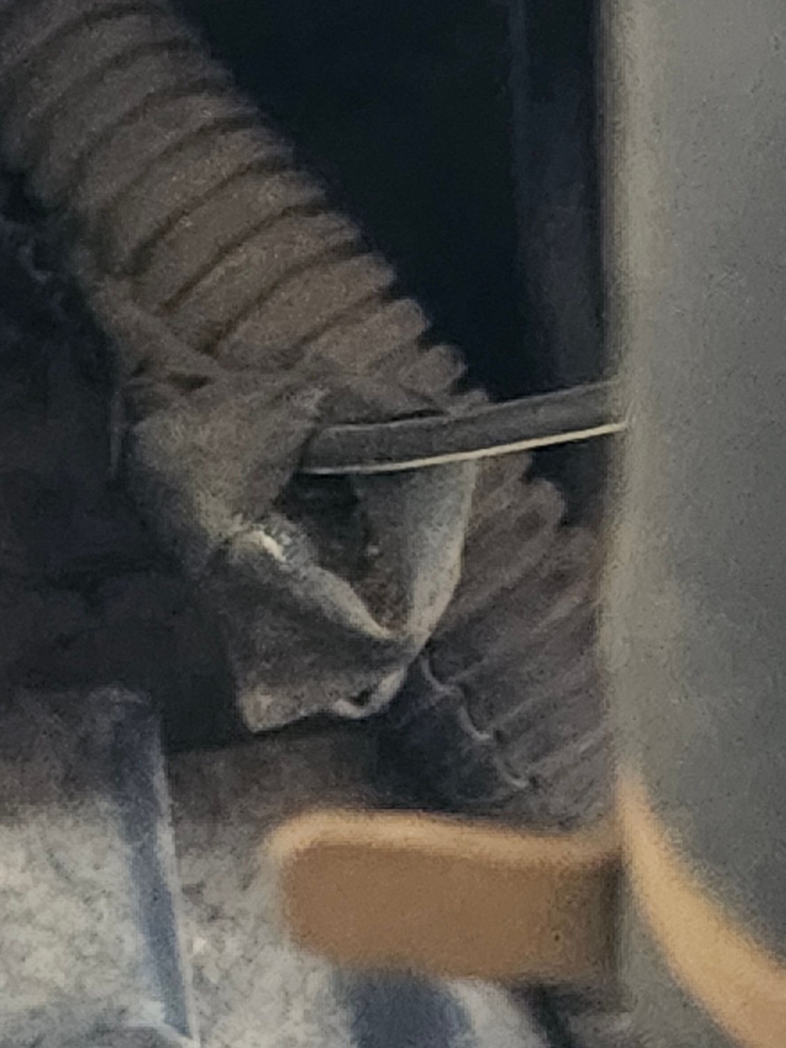

Inherited a 2008 Saturn Vue 2.4L. Brother-in-law replaced battery for me in another state. I now have the vehicle. Some dash lights have been on. Low tire pressure, ABS, brake, traction control. The tires all have good pressure. I read somewhere that battery issues may cause these. Today, I found this wire laying in the battery tray. Any ideas what it is for? Goes into harness under fuse box.

Posts: 3,297
Is that wire black with a white tracer?
Old Aug 2, 2025 | 05:38 PM
TXSaturn's Avatar
Joined: Aug 2025
Posts: 22
Yes, black wire with white stripe. Connector says FL-1.
Posts: 3,297
Please take a picture of the other end of the shrink tube so we can see if is broken or a capped end. May or may not be related to the abs issues.
Old Aug 2, 2025 | 05:50 PM
TXSaturn's Avatar
Joined: Aug 2025
Posts: 22
Wire appears intact all the way into another wire bundle entering the bottom of the fuse box.
Old Aug 2, 2025 | 06:56 PM
Posts: 3,297
A picture of the piece that has fl1 stamped on it, that is probably from the maker of the shrink tube. I want to see if there is bare wire showing or if it is a factory end one a wire that is not used in your car. Manufacturers build harnesses for all options and only use what was ordered for each car. That wire may be for and unused option. We want to know if it is broken off of something or a factory dummy wire that you can ignore.
Old Aug 2, 2025 | 07:38 PM
TXSaturn's Avatar
Joined: Aug 2025
Posts: 22
Sorry. Misunderstood. Looks and feels like cork / wood. Can't see any metal to indicate wire.
