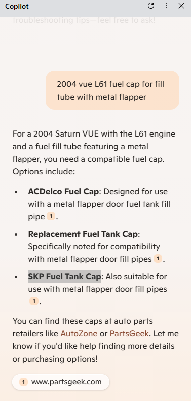

Thanks to all for your time. As far as I can tell the 2004 Vue came with either a plastic of metal flapper. Searching for 19432733 led to many confusing results as I went back and forth between various sourses.
I decided to ask Copilot (Edge browser), this was the result:
Odd part # but this is what I ordered.
Thanks again.
