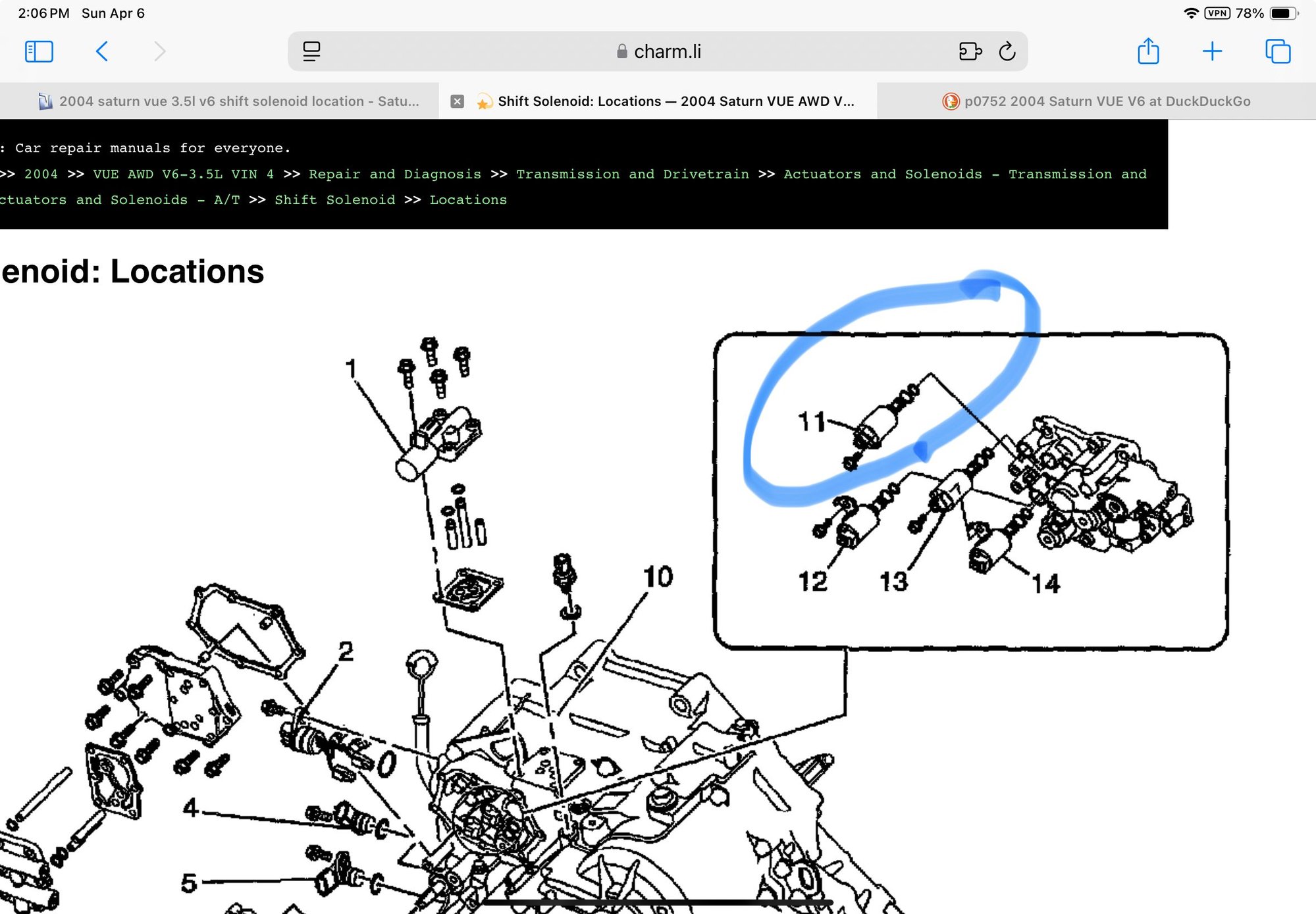

Does anyone know the location of shift solenoid H is located on a 2004 saturn vue 3.5l v6. Im getting code P0752 saying shift solenoid H is stuck open. So i was going to replace it. Is this the one thats under the transmission pan? And help would be greatly appreciated thank you jeff

Shift solenoids are internal.

P0752 shows a solenoid A, A is circled in the above drawing. The service manuals online are at Charm.li. I went to 04 VUE V6 and you can see the thread in the picture.
Hope this helps.
