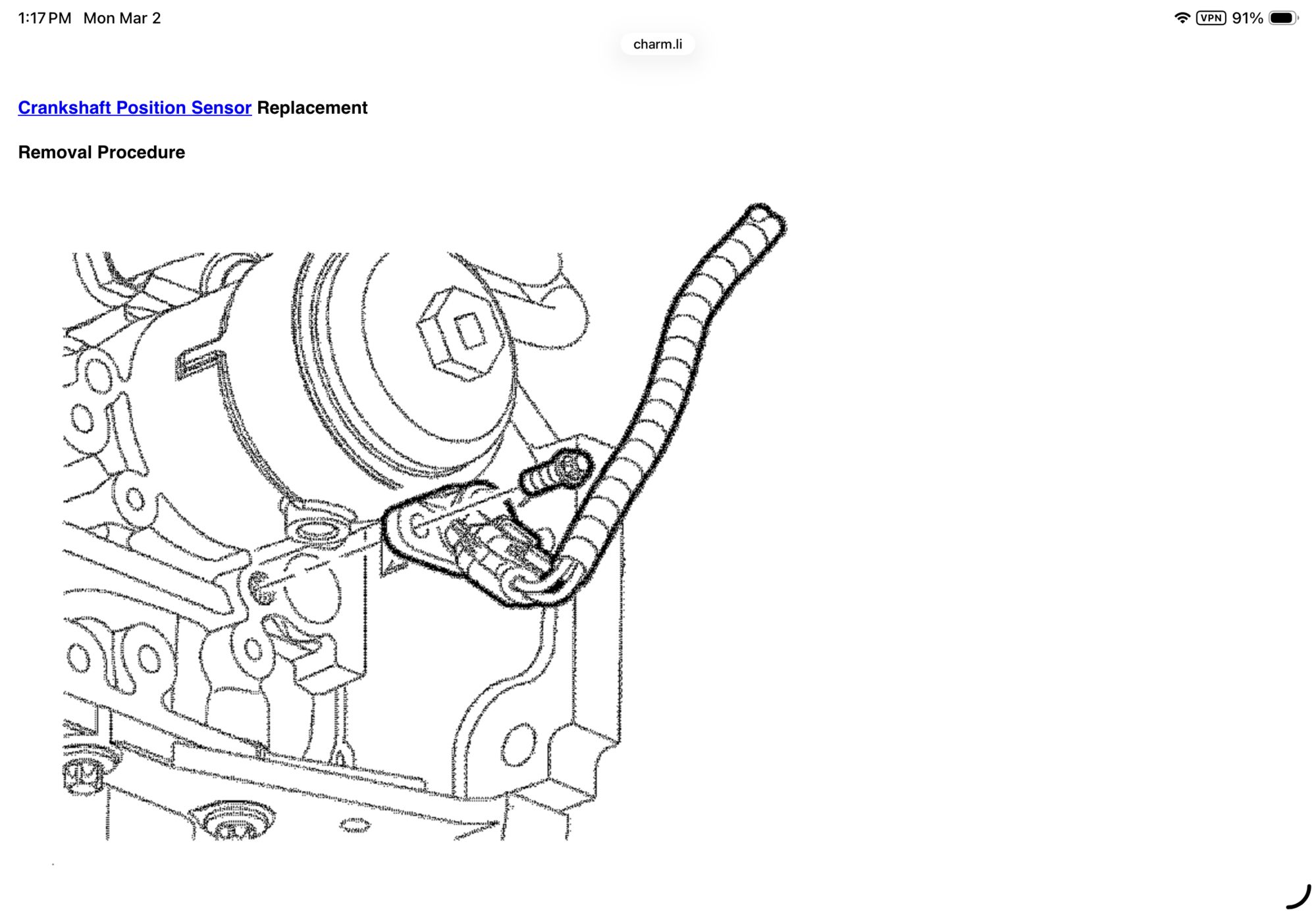

Sounds similar to a CKP (crank sensor) issue common to the original S series where if the PCM didn't receive a valid signal from the ckp, it would cut fuel and spark.
The 2.2 ecotec and the 3.0 V6 Opel derived engines and ECMs in the vues don't work exactly in the same manner as the S series, but it sounds like a sensor associated with knowing where the crank or the cams is/are in their rotation is intermittently going open circuit when the engine heats up. When it cools back down (your 10 to 15 min), the coil becomes continuous again and vehicle starts and runs.
Don't run out and buy a crank sensor.
Wait until someone else more familiar with the V6 joins. @02 LW300 , might you be able to help sort this?

If there are no codes stored and the problem is heat related I would want to look at the crank sensor and wiring. It may be oil covered since it is next to the oil filter.
