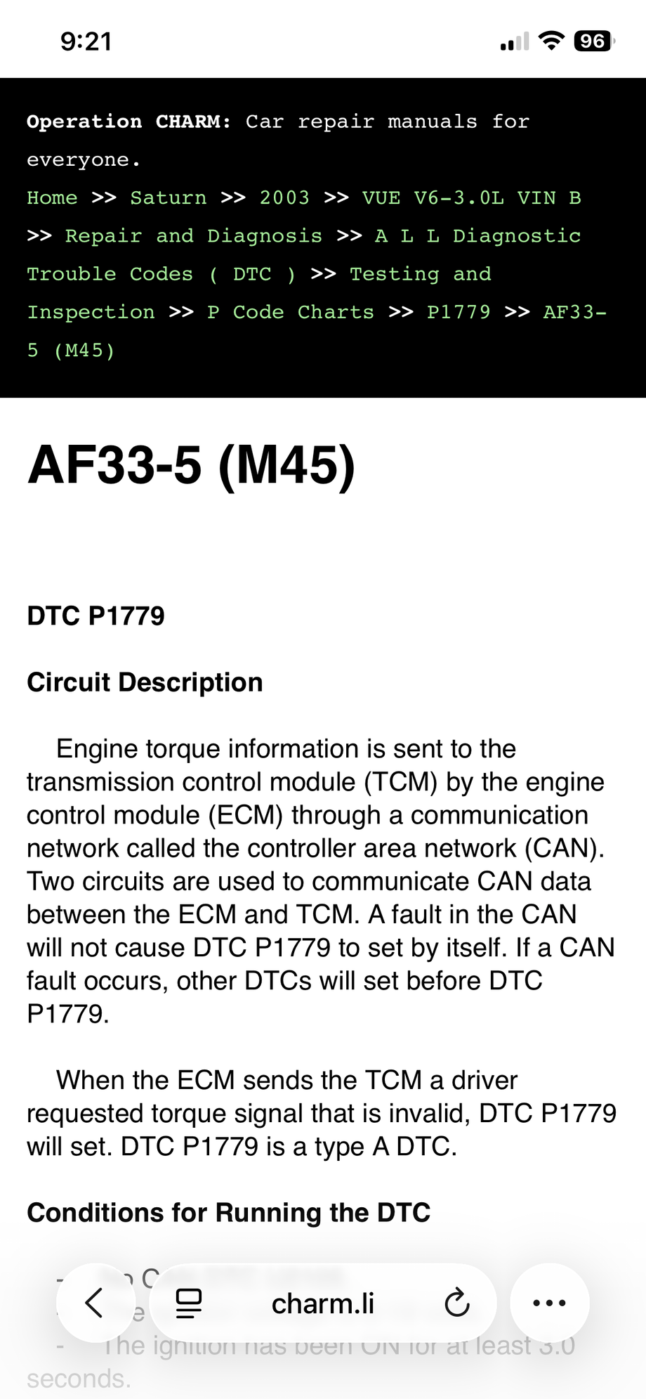

P1779 p0700 p0971 p1780 the p1779 is the main code engine torque delivered to Tcm signal
Old Mar 14, 2026 | 11:24 PM
Please look at charm.li to assist with code diagnostics, I am the L series guy. I have the same 3.0L v6 but nothing on the 5 speed automatic.

So what I gathered is I most likely have a bad ecm
