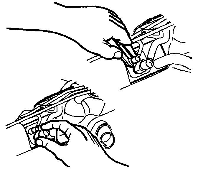

The [1][2]EVAP emissions canister is located in a molded cavity on the top of the vehicle fuel tank.
https://charm.li/images/DM15Q313/gm120/931014537/
1. Remove fuel filler pipe and fuel tank from vehicle.
2. Disconnect the 5/8" 90° fuel tank vapor inlet hose fitting from the canister.

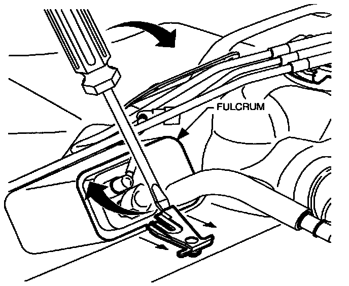

https://charm.li/images/DM15Q313/gm120/931018435/
3. Remove the EVAP canister retainer clip at the upper end of the canister.
4. Disconnect the 5/16" 90° fuel vapor/canister purge fitting from the canister (use tool SA9805E).
5. Remove the canister from the fuel tank.
