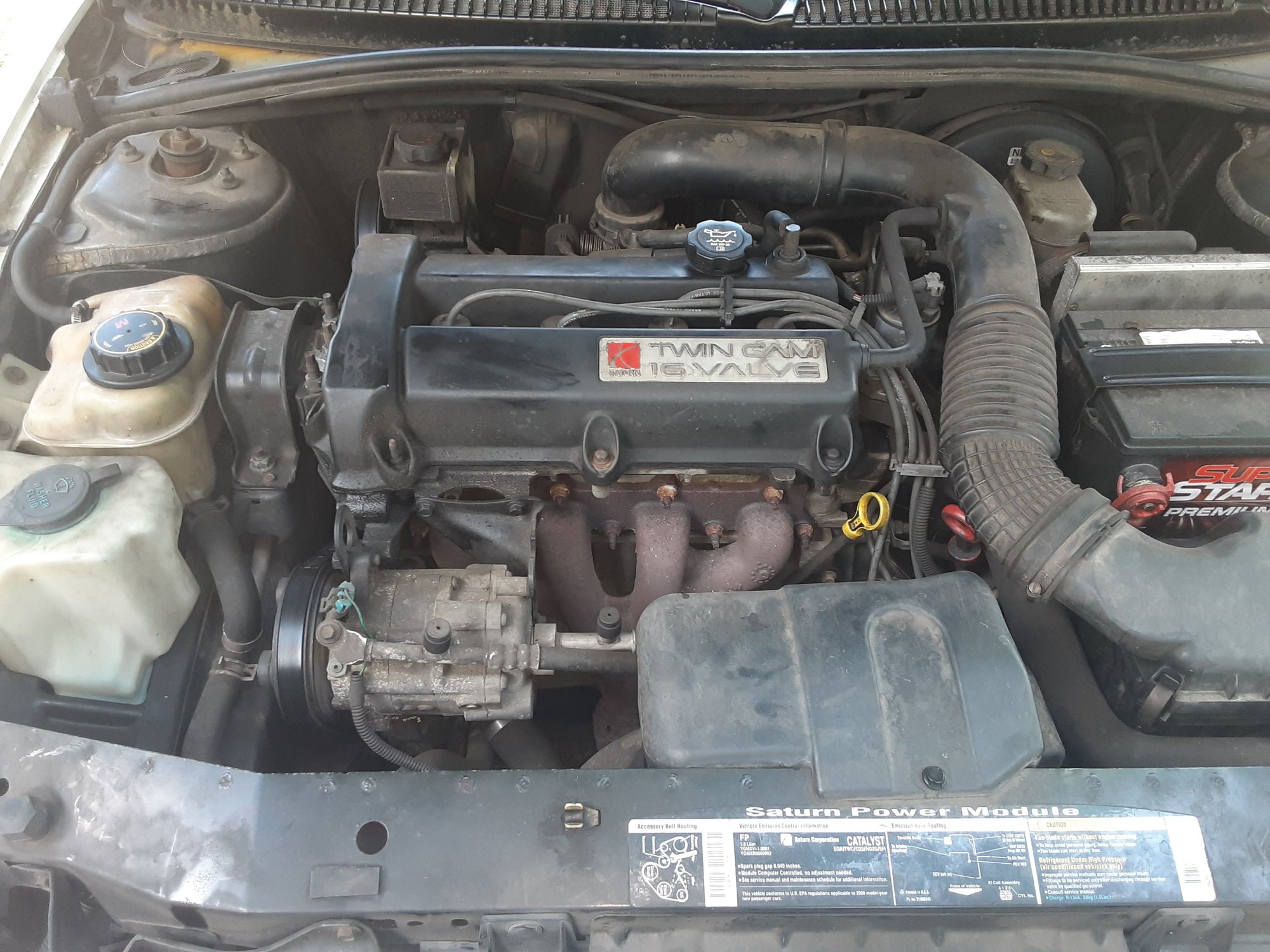

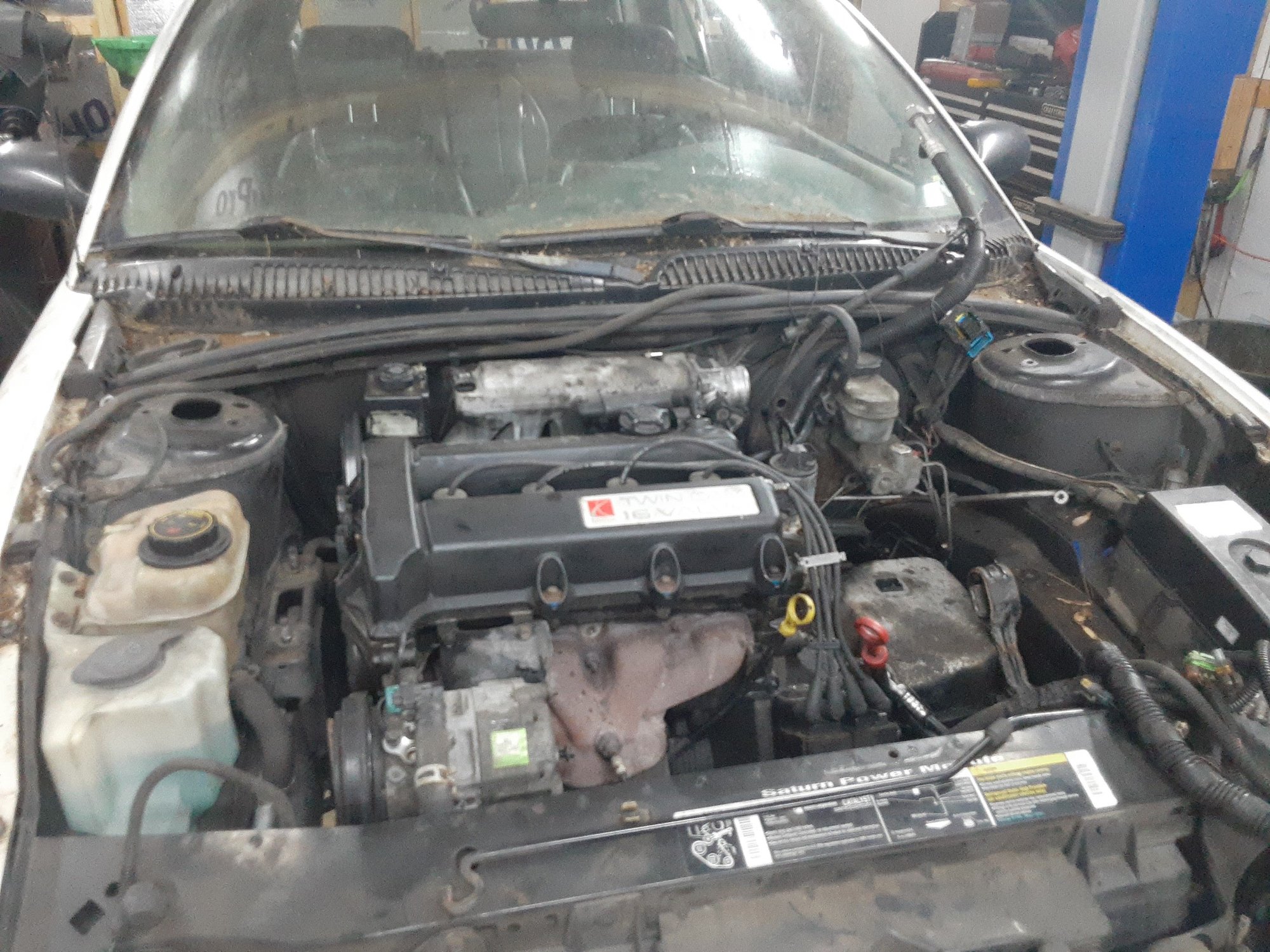

Since I have in my possession both a '97 and a 2000 head and valve covers I can say for sure the 2nd and 3rd gens are not interchangeable.
2nd gen 1997
1997 2nd gen
and here's the 2000 3rd gen
2000 3rd gen
Note the different bolt locations and that there are no extra (unused) bolt mounting bosses in the heads.

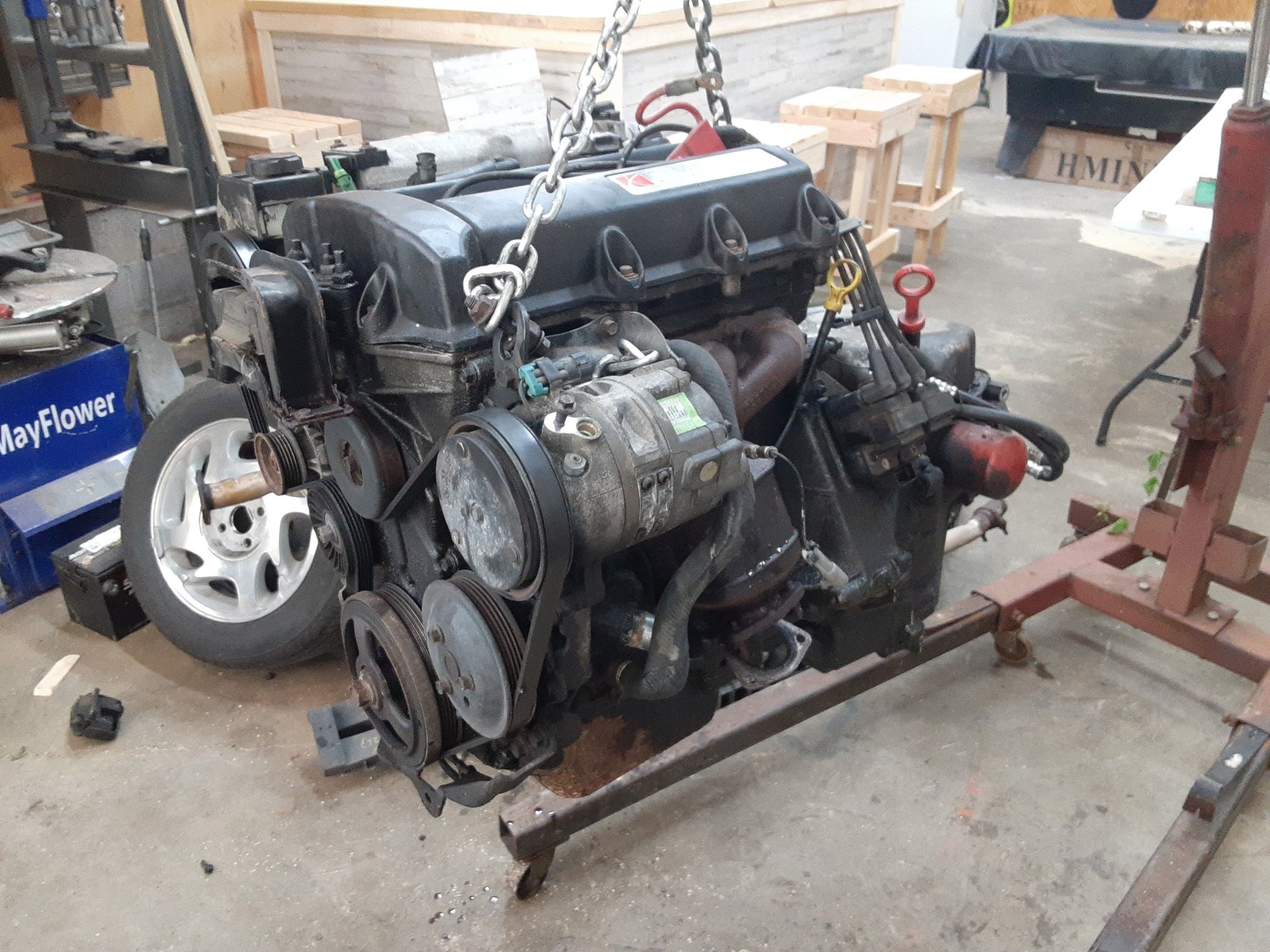

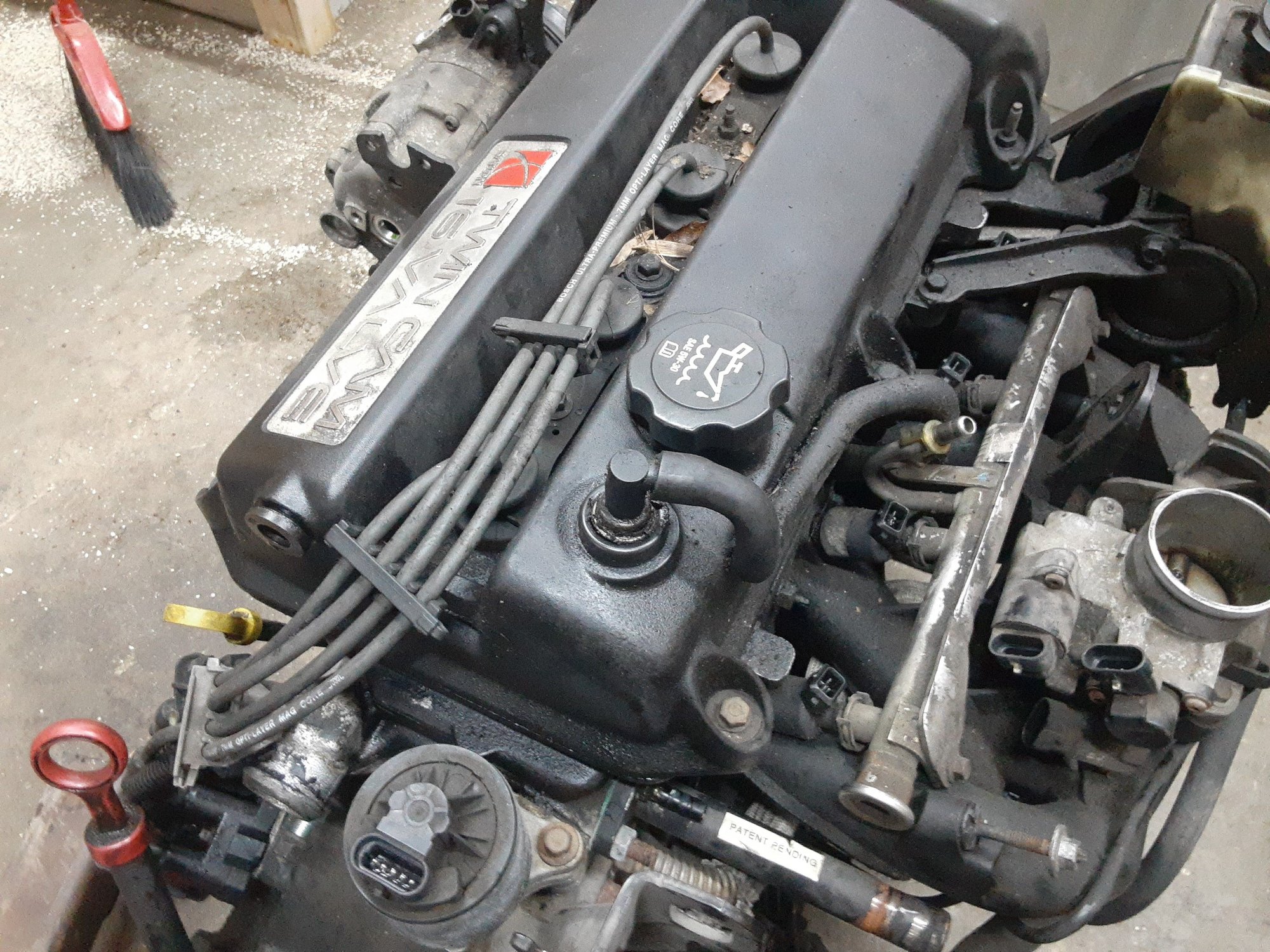

Actually, these two pictures show it better.
2000 3rd gen
1997 2nd gen
