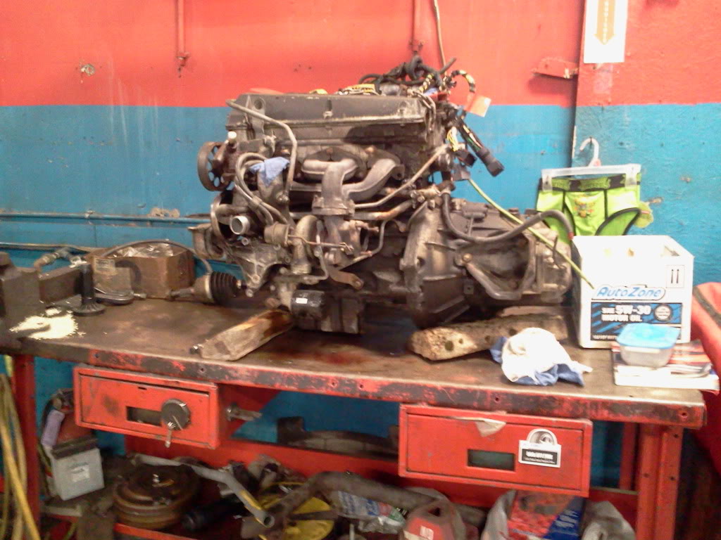

so, after a one week delay (snow storm that shut the shop down last saturday) I got a work day on the sonic ****box2.0, got the engine out of the saturn and threw it in the back of the saab. shame, there was a new alternator on that thing.

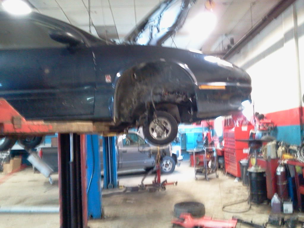

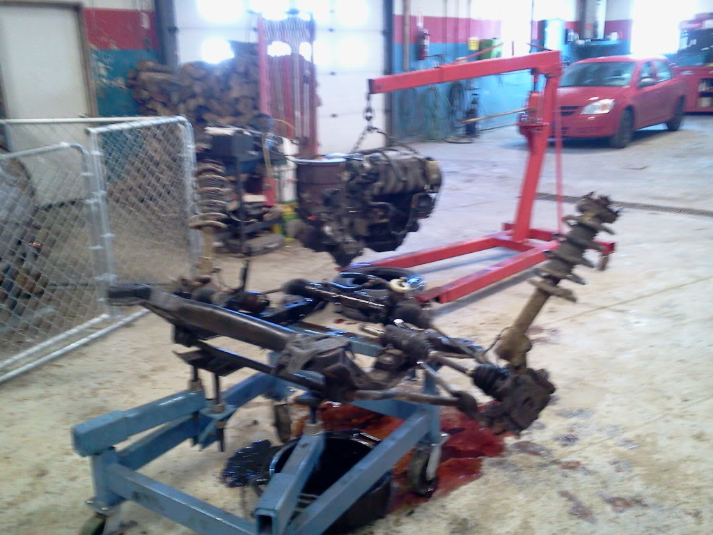

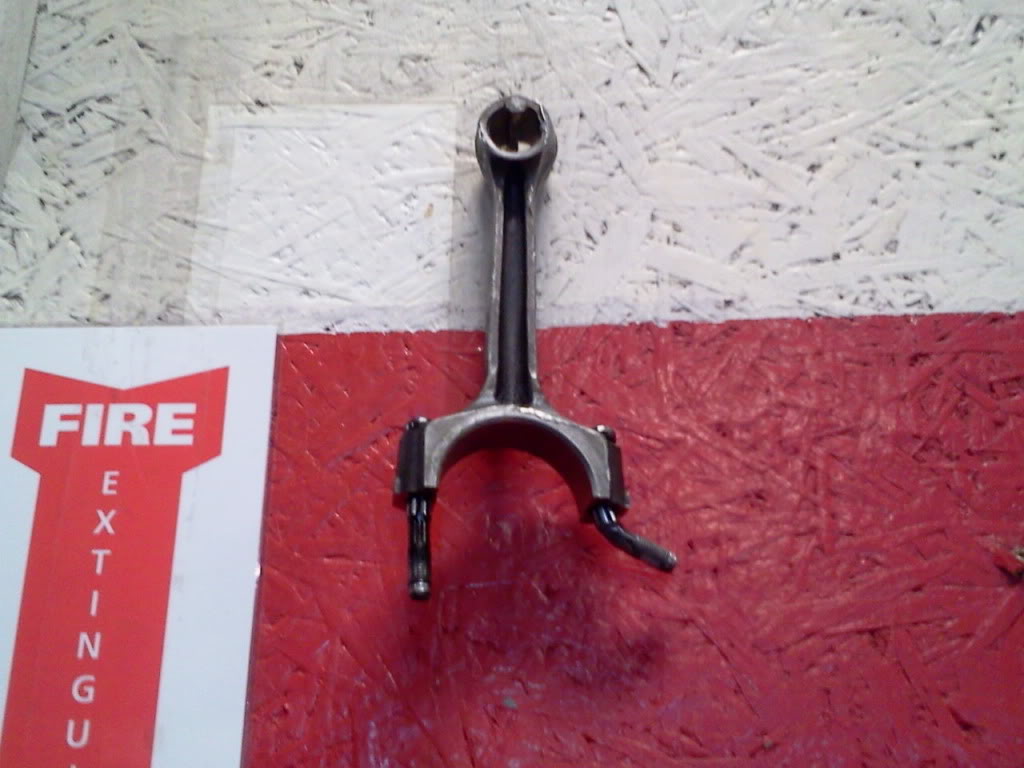

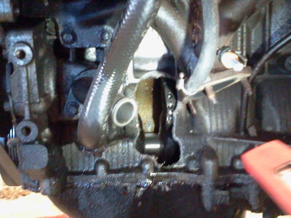

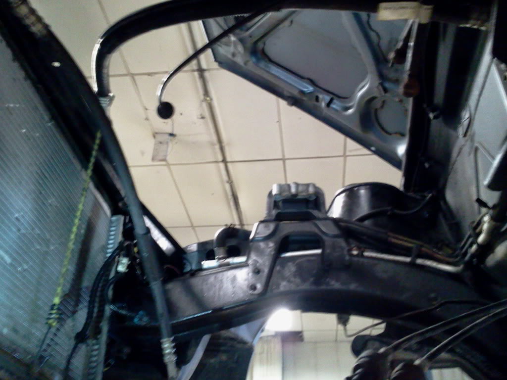

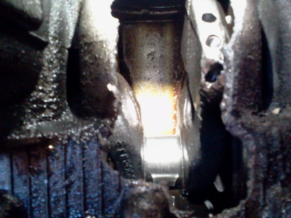

first off heres why i got the car so cheap:Attachment 1707 closer inspection reveals an oil level that is well above the crankshaft: Attachment 1708 well, the motor made a noise so he added oil, the oil level rose to the crank, the oil churned, the oil became a frothy suddsy mass of bubbles, the oil pump then picked up alot of air and thats when things stopped being lubricated and this gem was sent into orbit : Attachment 1709 engine out and cradle strippped: Attachment 1710 the almost appropriately sized engine bay : Attachment 1711 does anybody have info on fitting dodge ram wheels/tires on these cars, looks good from here:Attachment 1712 |
