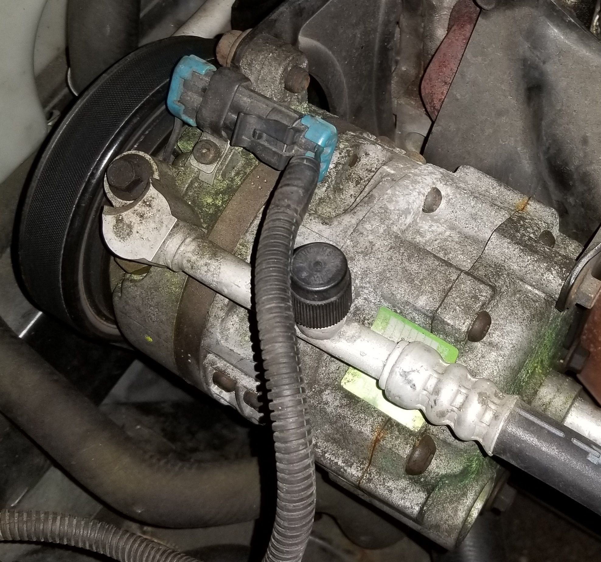

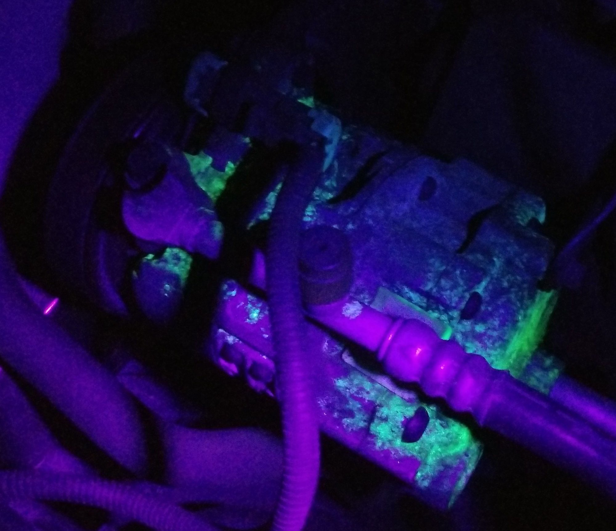

My A/C had a failed and leaking compressor, which can contaminate the entire system with shrapnel and debris.
This compressor was original to the vehicle, and the A/C had never worked since I acquired the car.
A black light reveals the compressor is leaking, quite severely, and may have additional internal problems.
Ideally, a compressor should not resemble a reenactment of the Chernobyl disaster.

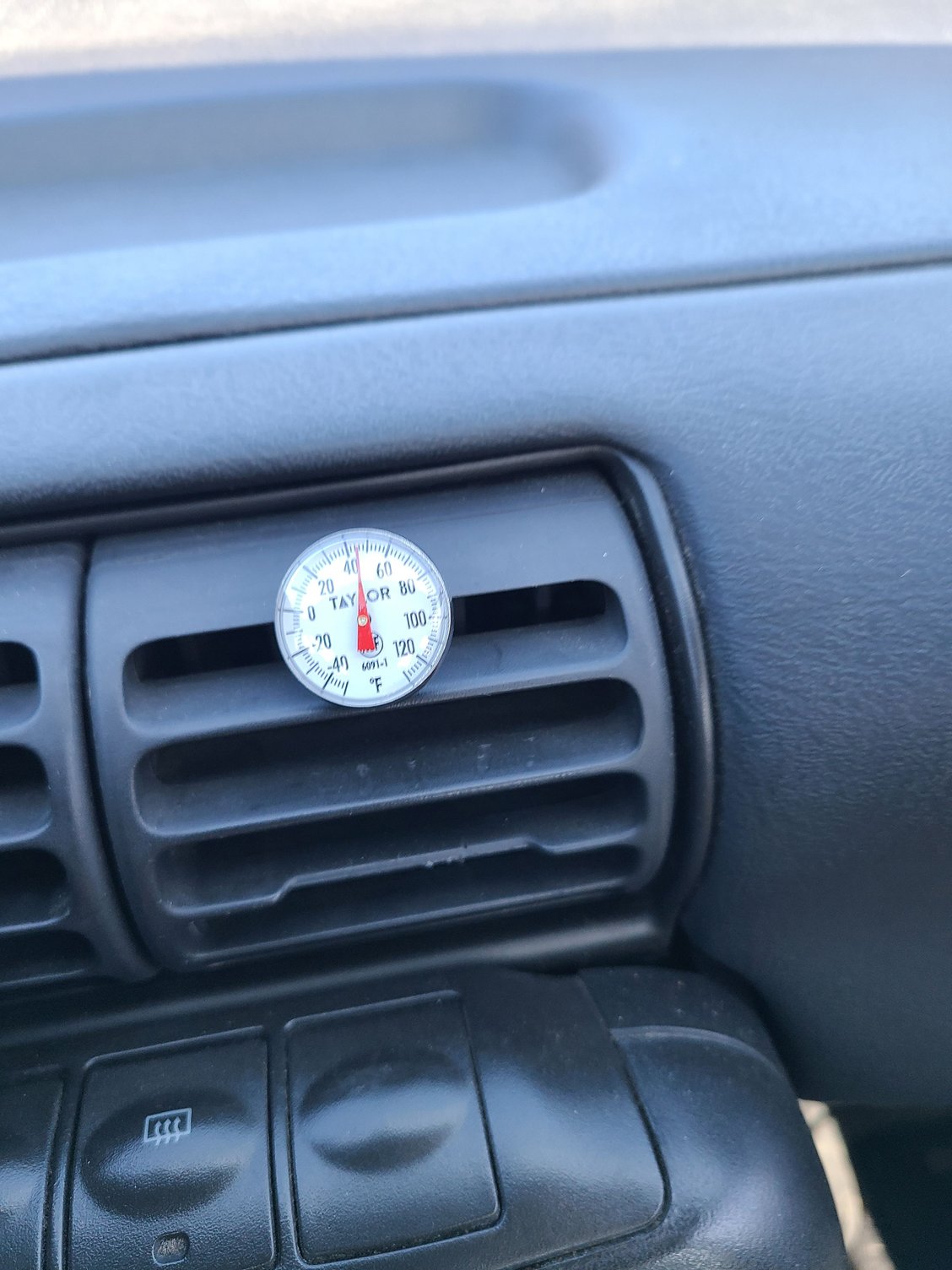

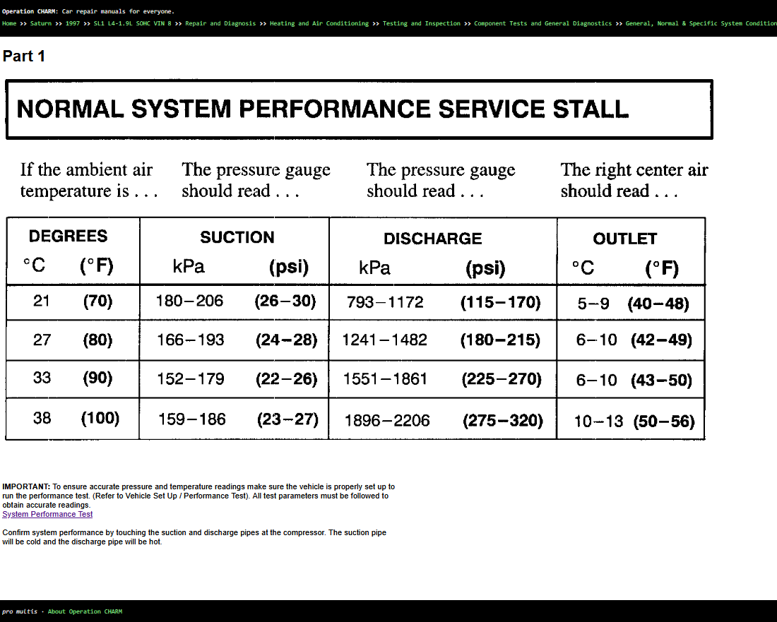

Test the performance:
Using manifold gauge readings.

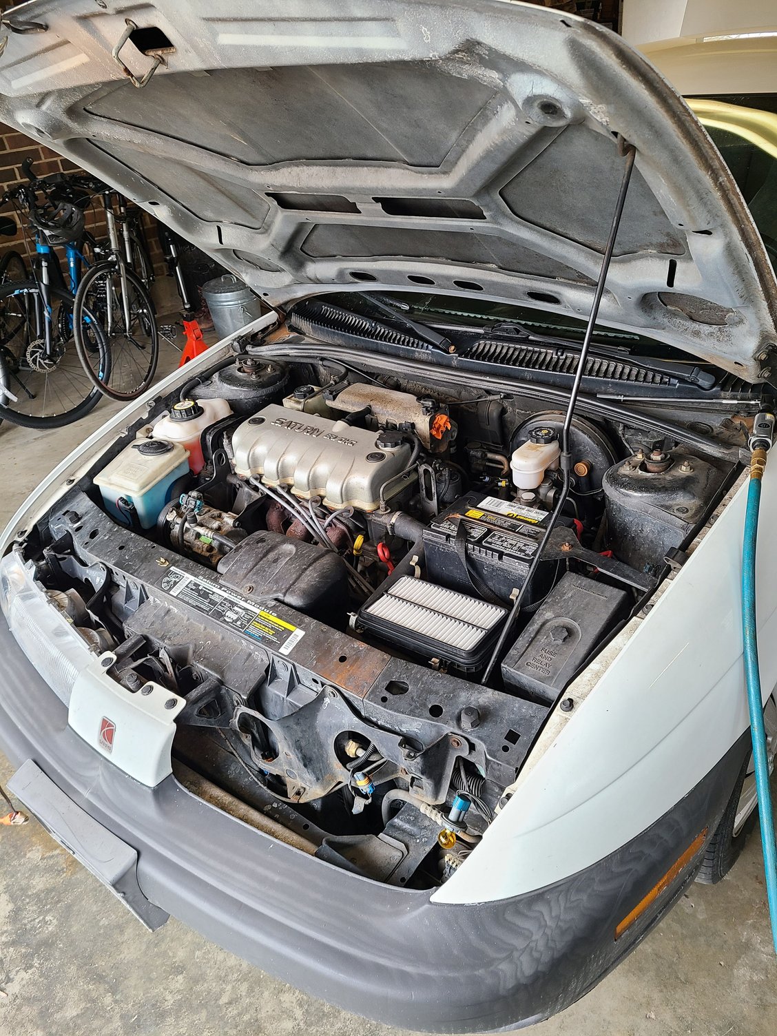

  1. Remove the air box cover, intake hose, and the throttle body assembly.
    The intake air hose, air filter cover, and throttle body are removed.  This provides enough space to work on the thermal expansion valve.
  2. Remove the front left headlamp to gain access to the condenser inlet/outlet. The charm.li manual has no procedure for how to do this, but the video below quickly explains how to do it. The relevant information begins at 1:38. The video shows the procedure on the passenger side, but it's exactly the same for the driver side, too. Only the driver side headlamp needs to be removed. Don't forget to unplug the electrical connectors for the low beam and high beam bulbs, and to unscrew the turn signal socket from the headlamp assembly.
    The driver side headlamp is removed, providing space to access to the condenser inlet and receiver drier hose.
    The driver side headlamp is removed, providing space to access the condenser inlet and receiver drier hose.

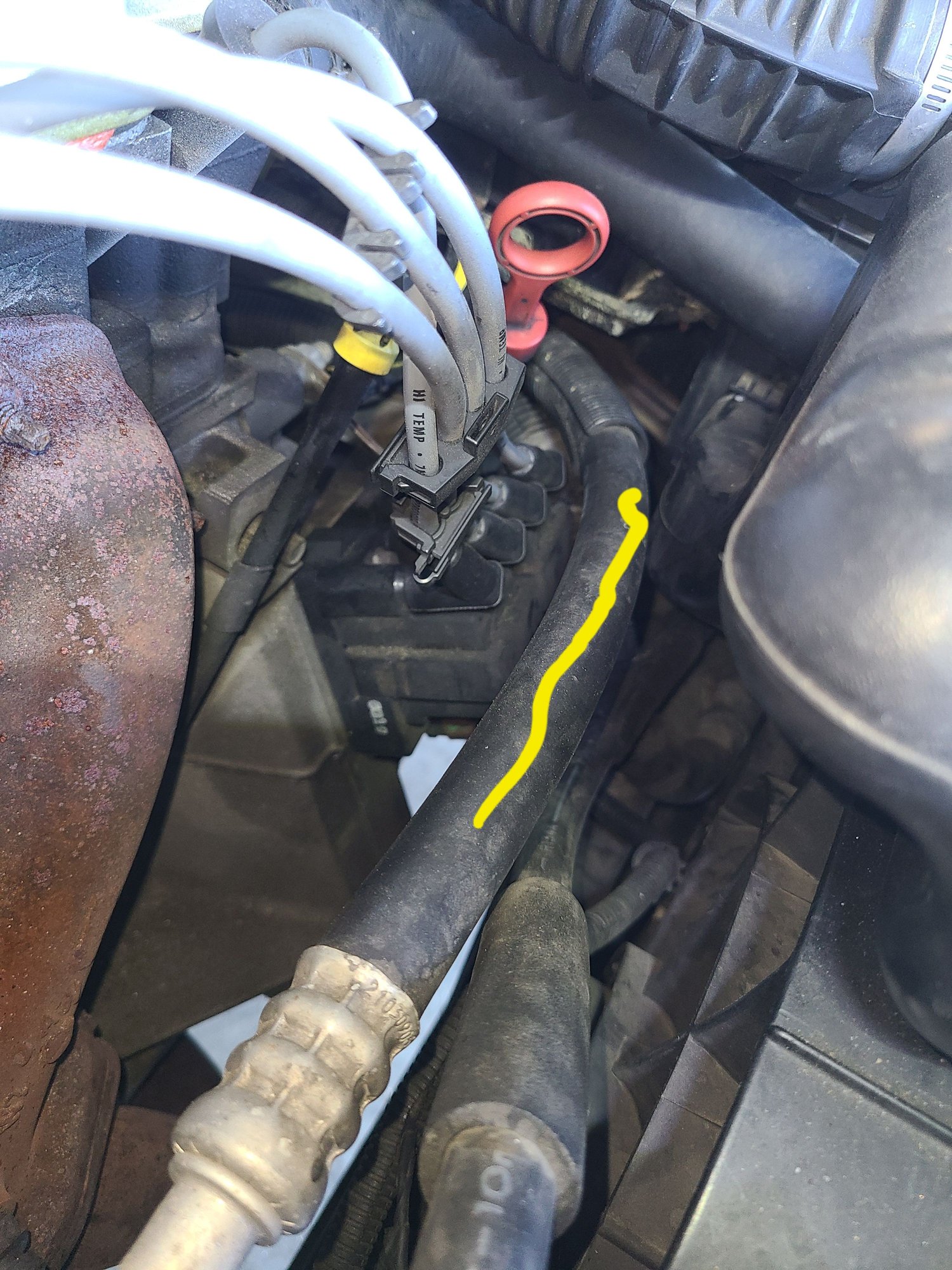

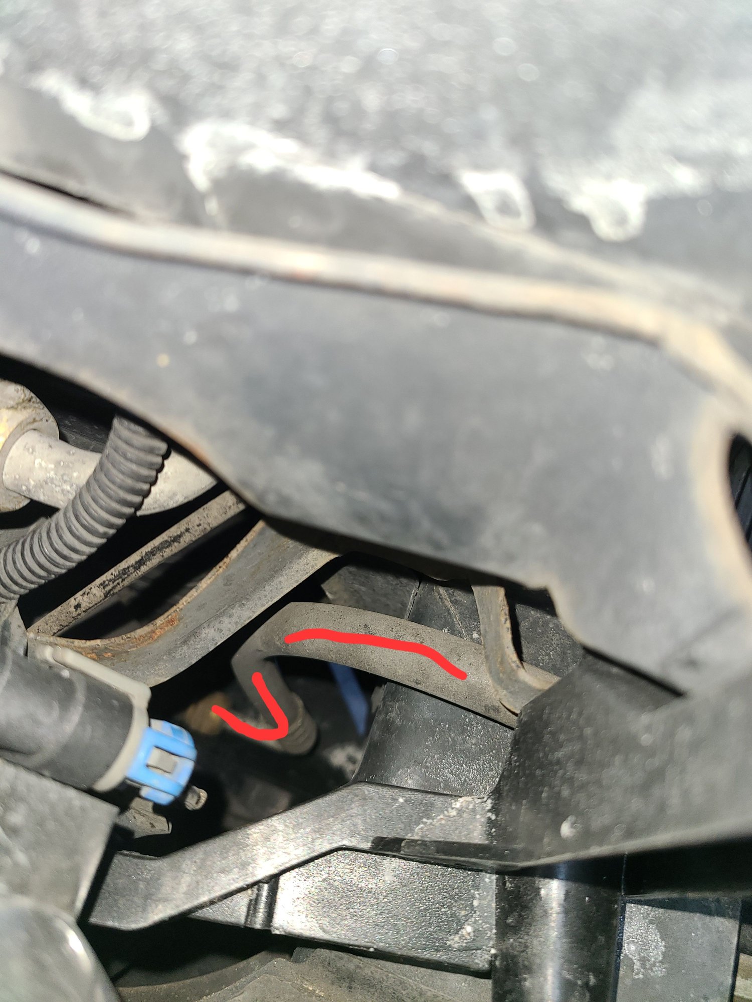

  1. Take photographs to record how the suction hose is routed (compressor to thermal expansion valve).
    Suction hose (marked with yellow)

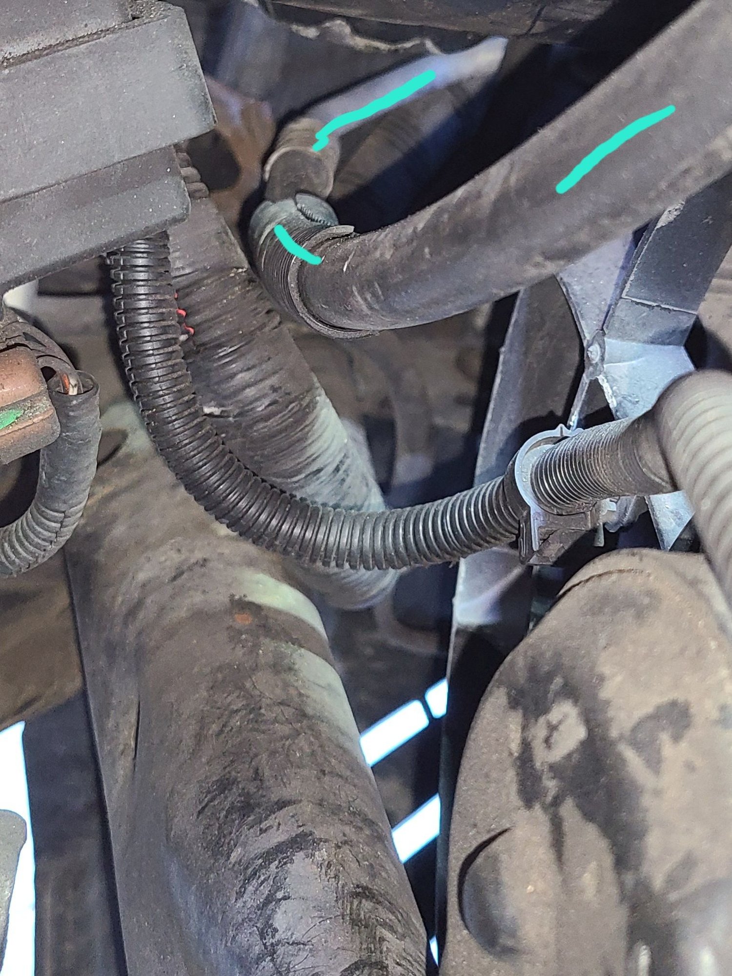

  2. Take photographs to record how the discharge hose is routed (compressor to condenser inlet).
    Discharge hose (marked with teal)
    Spoiler

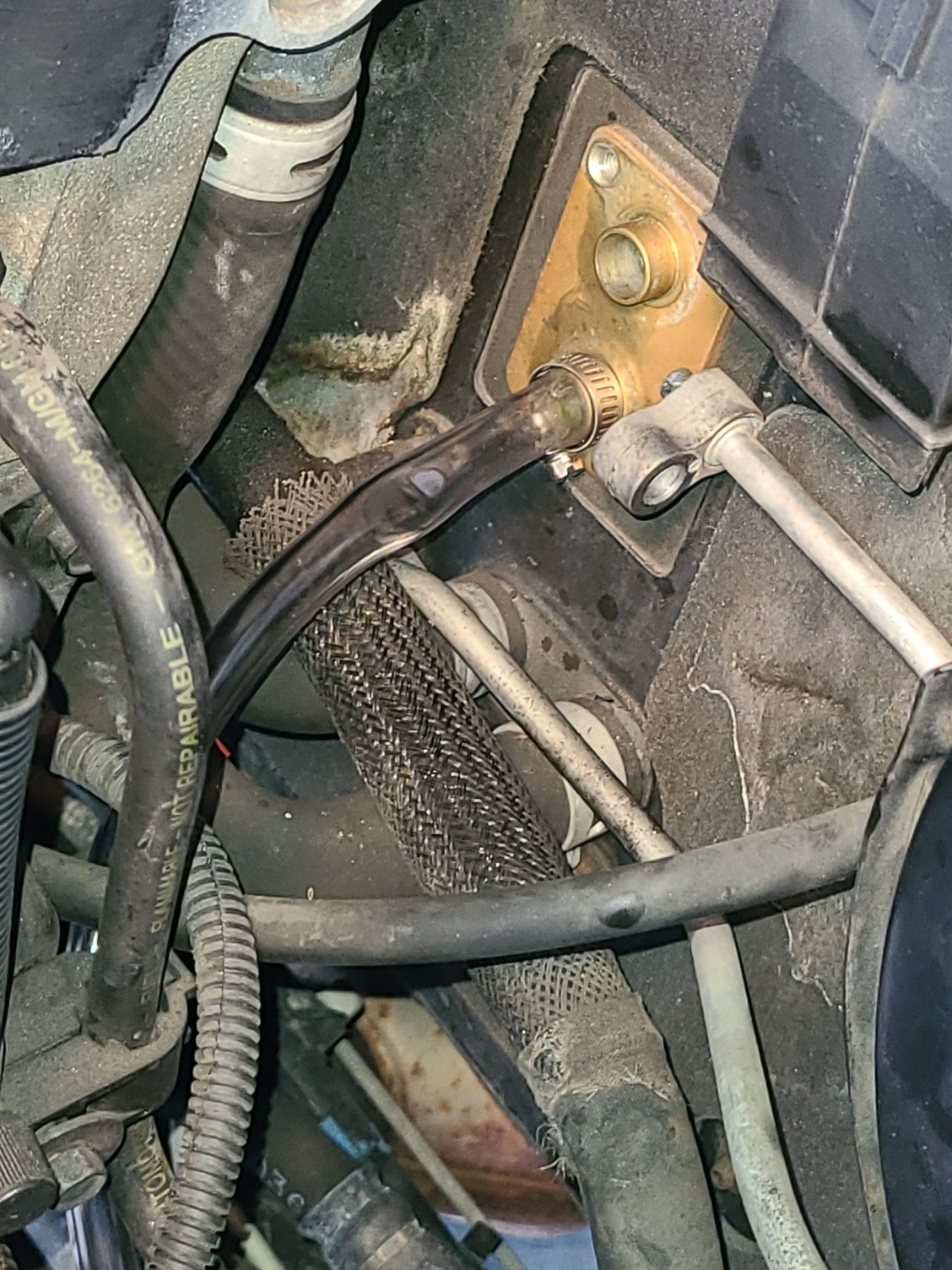

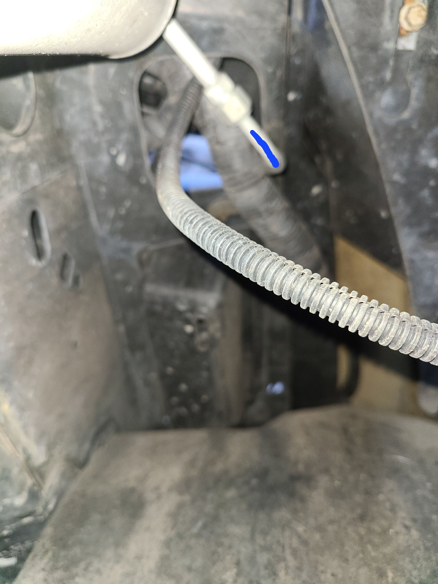

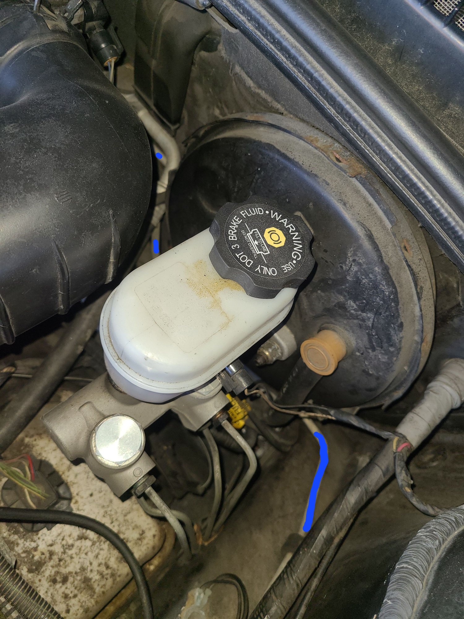

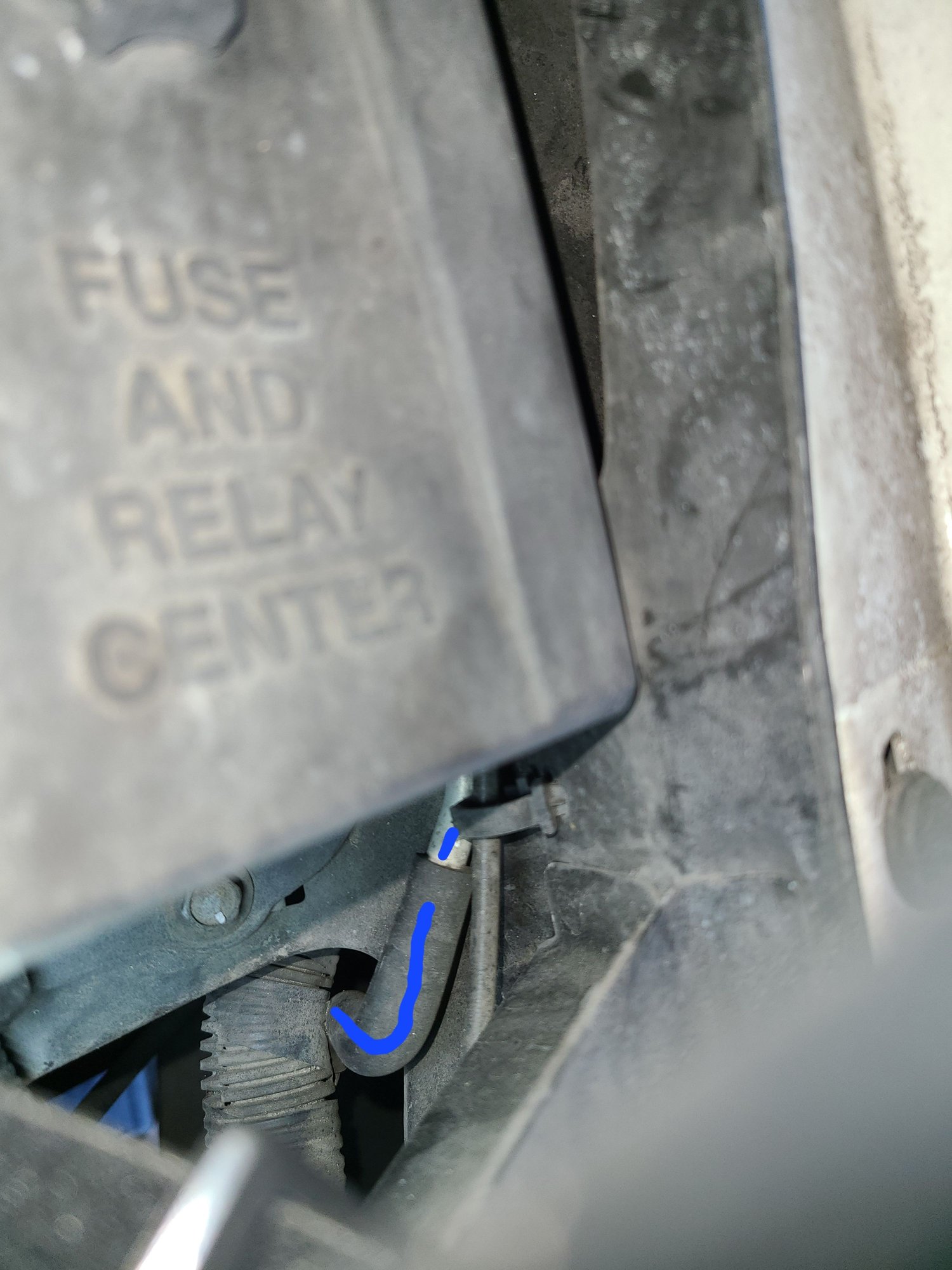

  4. Take photographs to record how the liquid line is routed (receiver drier to thermal expansion valve).
    Liquid line (marked with blue)
    Spoiler

The purpose behind this phase is to establish a record of how the hoses are routed through the engine compartment. When the time comes to reinstall components, knowing how the lines are routed is key. This step will also help you familiarize yourself with how the AC system components are interconnected. You can rely on the photographs shared here to help you identify your components, but it would be best to take your own photographs because it is possible that your vehicle configurations are not identical.

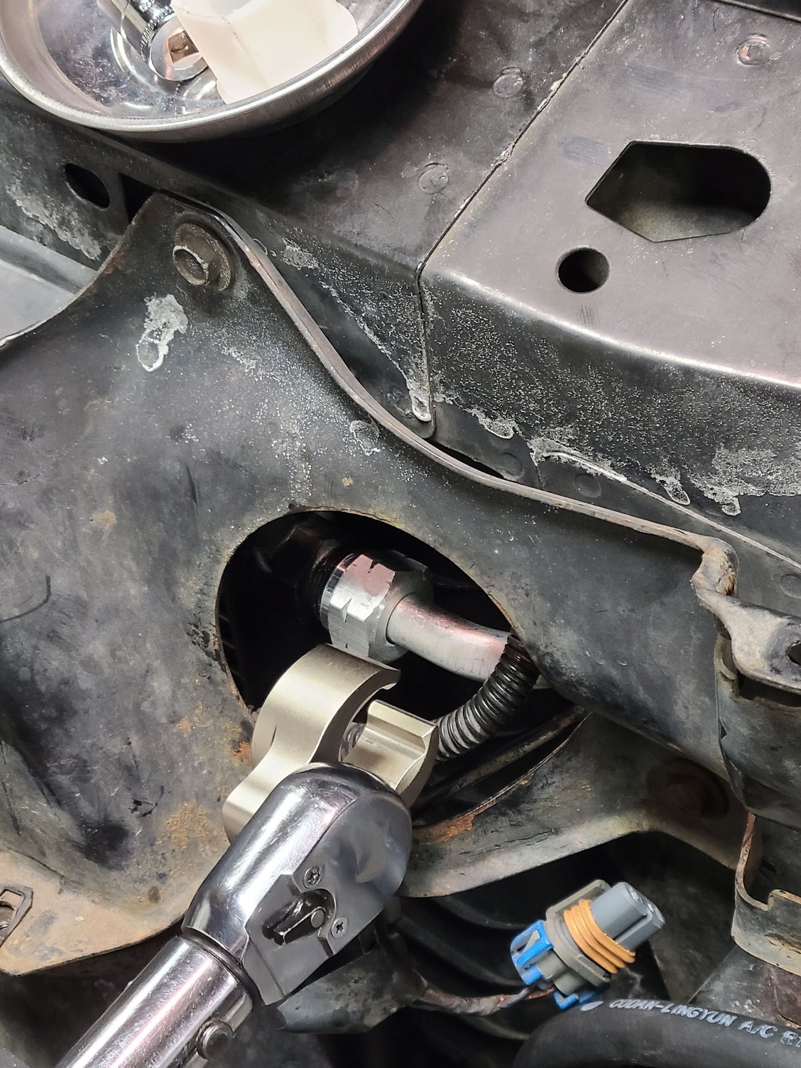

  8. Connect the receiver drier to the condenser with a lubricated O-ring.
    Note1: The service manual instructs to use R12 mineral oil to lubricate O-rings and specifically warns against using PAG oil. R12 systems have been largely phased out of use, so the oil was difficult to find. However, it is available on Amazon (in a large size) here.
    Note2: This fitting requires a crowfoot wrench to properly torque. The fitting for the outlet on my system is 22mm, and the fitting for the inlet is 24mm.

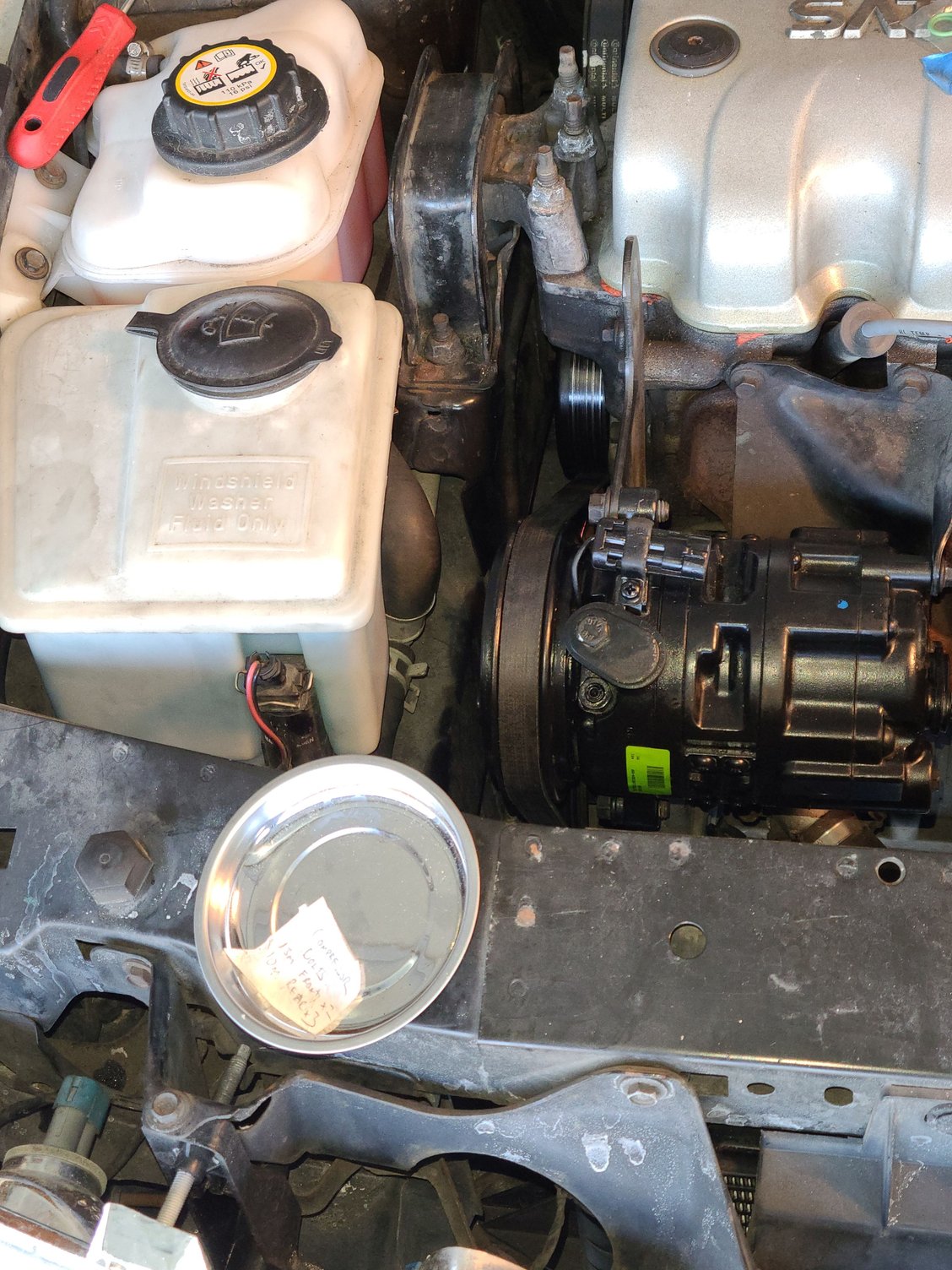

  1. Remove the old compressor
    Spoiler
  2. Install the new compressor
    Spoiler
  3. Prime the new compressor with 30 ml (1 oz.) of PAG oil.
    Spoiler
    Note: After adding oil, it is wise to place the port covers back on the compressor to prevent contamination from any debris or dust while working.

Phase 7: Refrigerant Charge
Suggested Tools/Equipment
  • R134a manifold gauge set
  • A/C vacuum pump
  • R134a refrigerant (need at least 1.5 lbs)
  • Nozzle tap for R134a canisters
  • Digital Scale
Instructions:
  1. Refrigerant capacity – The system must be charged with 1.5 lbs (0.68 kg) of R134a refrigerant.
  2. Close all valves and service ports on the manifold gauge.
    Note: High- and low-side manifold gauge connectors should still be connected to the service ports, and the high and low manifold gauge hoses should still be holding the vacuum from Phase 6.
  3. Thread the end of the yellow center hose to the refrigerant tap nozzle.
    Spoiler
  4. Thread the can of R134a onto the tap nozzle.
  5. Turn on the nozzle to allow R134a to flow into the yellow service hose.
  6. Loosen the yellow service hose connection at the manifold gauge slightly to allow air to be forced out of the hose by the refrigerant.
    (Warning: Some refrigerant will escape.) Ensure all air is removed from the yellow hose.
  7. Place the can of R134a carefully onto a digital scale.
  8. Make a note of the starting weight of the can. This will be used to calculate how much R134a has been added to the system.
  9. Start the vehicle. Turn on the A/C, set the blower motor to maximum, and the temperature to cold.
  10. Open the low-side valve of the manifold gauge.
  11. Open the low-side service port valve.
  12. Refrigerant is now flowing into the system.
  13. Open the high-side service port valve (not the manifold gauge valve!)
  14. Monitor the weight reading on the scale to track how much refrigerant is being added. Do not overcharge the system.
  15. Follow the instructions on the can for the charging process. This usually involves tilting the can 90 degrees to its side and back upright periodically.
  16. When the can is empty or nearly empty, close all manifold gauge valves, disconnect the can, and connect the next full can.
    Be sure to loosen the yellow service hose connection at the manifold gauge slightly to purge air.
  17. When 1.5 lbs of refrigerant have been added, close the low-side manifold gauge valve.
  18. Close the refrigerant tap nozzle.
End of Phase 7

Phase 8: Test Completed System
  • Vent thermometer
  • UV flashlight
  • Manifold gauge set
Instructions
  1. Place a thermometer in the center A/C vent and set the system to blow the air as cold as possible. Ideally, the vent temperature should be between 40 and 50 degrees Fahrenheit.
  2. Ensure high- and low-side pressures are correct for the given environmental conditions. If they are not, diagnose the issue and correct it.
    Spoiler
  3. Use a UV light to thoroughly inspect the entire system for leaks.
  4. If any leaks are found, repair them and return to Phase 6.
Comments:
When testing system performance, it is common for the initial manifold gauge readings to be slightly outside the prescribed PSI range. This is because it can take time for the system to balance the distribution of PAG oil and refrigerant. If your readings are out of the prescribed range, but somewhat close, do not rush to correct them by adjusting the refrigerant charge. Drive the vehicle and monitor the system. A/C systems also tend to perform better while the vehicle is driving and operating above idle RPMs.
