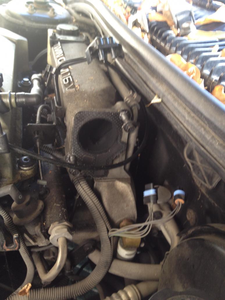

One final recommendation -- REPLACE THE ENGINE COOLANT TEMPERATURE SENSOR (ECTS) AND IT'S ASSOCIATED CONNECTOR!!! Use only OEM parts. Will cost about $40 bucks for the parts. Should fix your starting problem, and may even fix your overheating issue (not a guarantee, but possible)
I cleaned everything up replaced ECTS cranked it changed the oil and filter and now its smoking ALOT!!! It's idling high and the adjustment screw is backed all the way out. Not sure what I can do now. Any help would be greatly appreciated. The throttle body was very, very dirty.

I used was 10w-30 it's what all I have right now but, I will switch to 10w-40. One of my teacher suggested adding transmission fluid to my oil and driving it lightly for awhile then changing the oil. I'm not at all objectionable to the engine fix it or 10w-40. I'm just using what I have that is freely available to me. I do believe I saw some 15w-40 fairly cheap at Costco and I was wondering if that would work better.
As for the adjustment screw, it's the star bit screw on the throttle body that adjust the idle. Right now it's idling at 2,000 RPMs I didn't check for the proper torque on the throttle body I just tightened it as securely as I could "Which I know might very well be the problem". I was just running out of time and couldn't find it in my book.
A 2,000 RPM idle would suggest to me that there's a vacuum leak somewhere, although if the car has been running with bad sensors for a while, it may take a couple of driving cycles for the computer to relearn things. Watch your oil level, and let things cook off for a week or so ...
